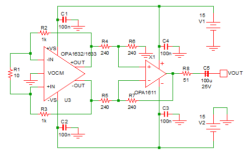

Coincidentally, I recently built a test board with SMD components to evaluate the OPA1632 and new OPA1633.
Together with a test board for high GB product OP-AMP, which is difficult to operate stably with DIP conversion boards and TH components.
The evaluation has not yet been completed at present, but the input conversion noise in the audio band has been measured with the following circuit,
OPA1632 1.76nV/√Hz
OPA1633 1.20nV/√Hz
The measurement method was to measure the noise voltage at the output through a 20 kHz steep LPF, divide by the noise gain (=201) and bandwidth √20k, then subtract the contribution of the 10 Ω thermal noise (0.4 nV√Hz) due to R1.
The old 1632 value is slightly higher than would be expected from the datasheet graph, but the new 1633 is a 3 dB improvement over the 1632. Currently, the highest specification for ordinary OP-AMPs is 0.9 nV/√Hz (AD797, LT1028 and others), except for special ones like the LMH6629 . Considering that two of them in a balanced configuration will give around 1.3 nV/√Hz, the OPA1633 seems to be one of the best choices, provided that no discrete components are used. SSM2019 and others are also possibilities, but I don't know as I don't own one.
In addition, in the above circuit, the voltage at both ends of R1 (10 Ω) was measured to be
OPA1632 70 µV
OPA1633 83µV
This is the data of one sample each, so it is only for reference, but I think it is the DC voltage applied to the cart in the case of direct connection.

My voltmeter does not support balanced inputs. Therefore, a 1x BAL to UNBAL conversion circuit is required. Because the front-end gain is set to a large 201x. which overwhelms the noise in the BAL-UNBAL conversion circuit.
Even if one side is grounded or completely floating, the slight current mentioned above will still flow.by DC voltage applied to the cartridge in case of direct connection, do you mean if the cart is connected between one of the diff inputs and ground there is a small DC offset?

Curiosity, what did you use to measure the output noise? I am not sure even AP can clearly measure down to 1nV/sqrtHz without using a low noise preamp one front.
I have tried to clarify the measurement circuit and method so that such questions do not arise.I am not sure even AP can clearly measure down to 1nV/sqrtHz without using a low noise preamp one front.
It would be impossible even for the AP to directly measure noise around 1 nV/√Hz.
Again, the noise gain at the front end is multiplied by 201, so if the input refer noise density is 1nV/, the noise density at the output is measured as 201nV/√Hz.
The noise on my noise voltmeter (which I made myself) is 0.749uV measured through a 20kHz LPF. The noise density is therefore 5.3 nV/√Hz, which is sufficient to measure 201 nV/√Hz.
Incidentally, the measured noise voltage at the output of the measurement circuit (with 20 kHz LPF) is
OPA1632 51.3 uV
OPA1633 35.9 µV
*When measuring with the noise gain of the OP-AMP increased in this way, it should be noted that
If an OP-AMP with a small GB product is set to a large noise gain, the frequency response may already be attenuated at the upper end of the measurement band.
In this case, the measurement will be made with a value less than the actual noise.
For example, if an OP-AMP with a GB product of 3 MHz (e.g. TL071) is set to a gain of 100 times, a -3 dB attenuation at 30 kHz is expected and there is already non-negligible attenuation up to 20 kHz, resulting in a measurement with a value less than the actual noise.

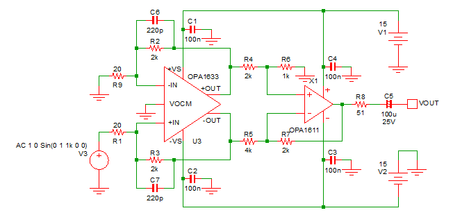

With this in mind, if I wanted to use this as I/V for the cartridge, let’s take as example Lyra Atlas Lambda SL which has a whopping 1.5ohm impedance we get an output offset if about 3.5V!! How can any MC cartridge be even considered as a generator current and be coupled with a transimpedance stage without incurring into this problem that has been daunting me for a while now trying to solve?
How can I null the input offset given 1633 doesn’t have a NULL pin?

Shorting R1 results in no feedback, so it is natural that this should happen. Mine will also do so.
Even then, the internal common mode feedback (feedback to make the two outputs symmetrical around Vcom) will still work, so one will swing heavily + and the other -. In the case of MC input, the gain is so large that it will be a blast.

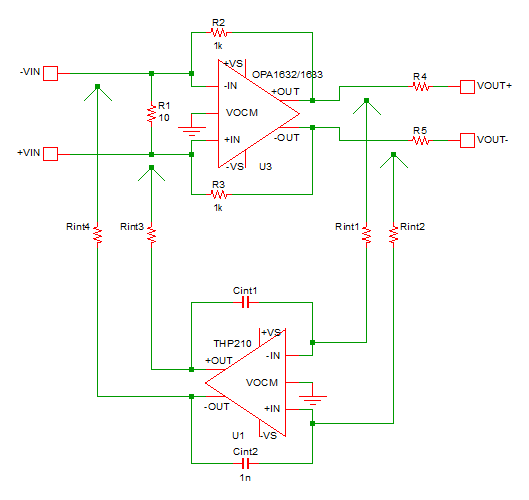

However, with regard to the input offset, from the following,
In my previous post I mentioned that the voltage applied to R1 is 70µV with the OPA1632. This is precisely +70µV with reference to -IN. The output offset of the OPA1632 was then approximately -14mV with reference to -OUT.
In other words, an offset of -gain times the input offset appears at the output. This was also the case for the OPA1633.
By adding a DC servo circuit that suppresses the output offset to almost 0 V, as shown in the circuit diagram below, it would automatically reduce the input offset to negligibly close to 0 as well. (Thought only, no experimentation)
Any further discussion may not be appropriate for this thread. Throwing out opinions and questions on Analogue Sources might catch the attention of many members and get the opinion of the wise. On the other hand, you might get confused by posts that don't fit the context.
*The polarity of the DC servo was reversed in the schematic of the first submission. The schematic has been corrected.

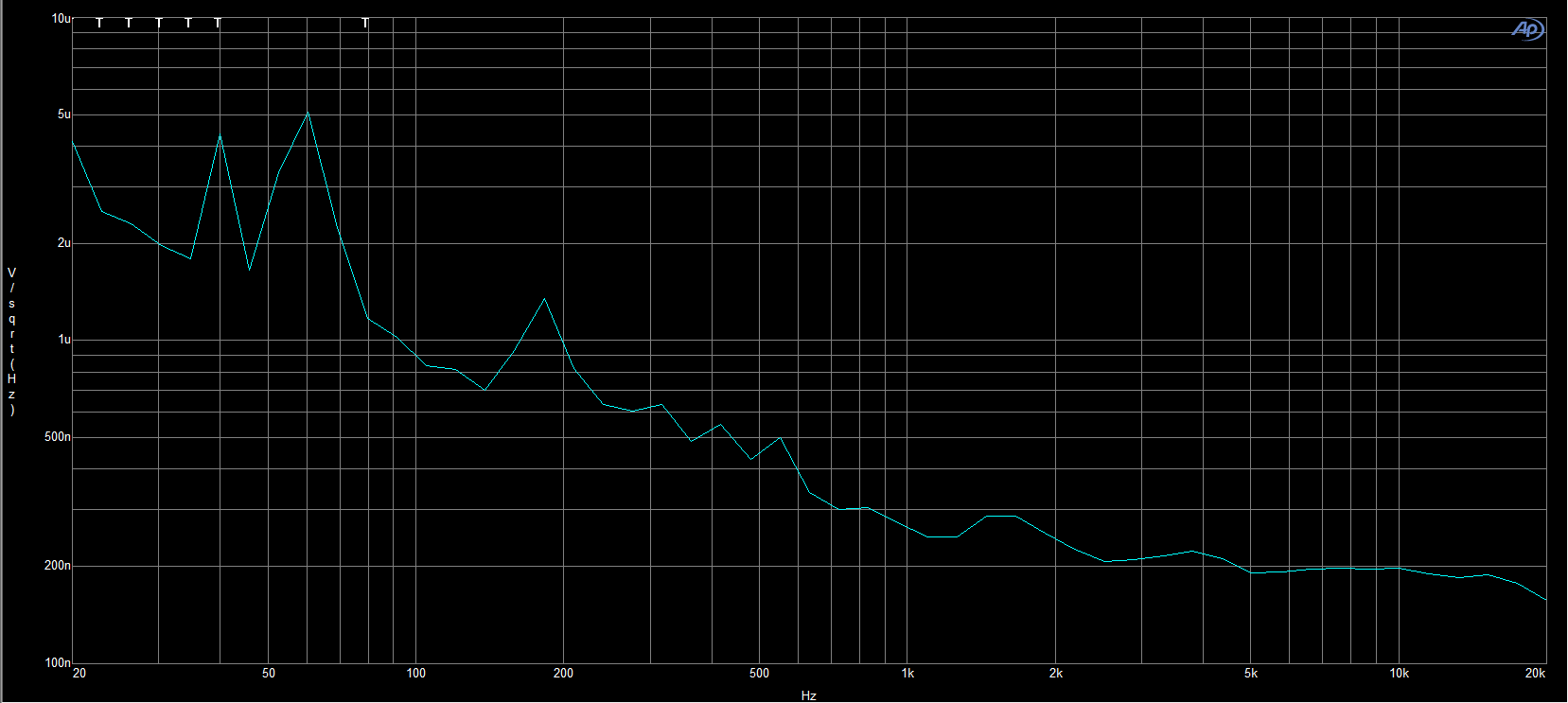

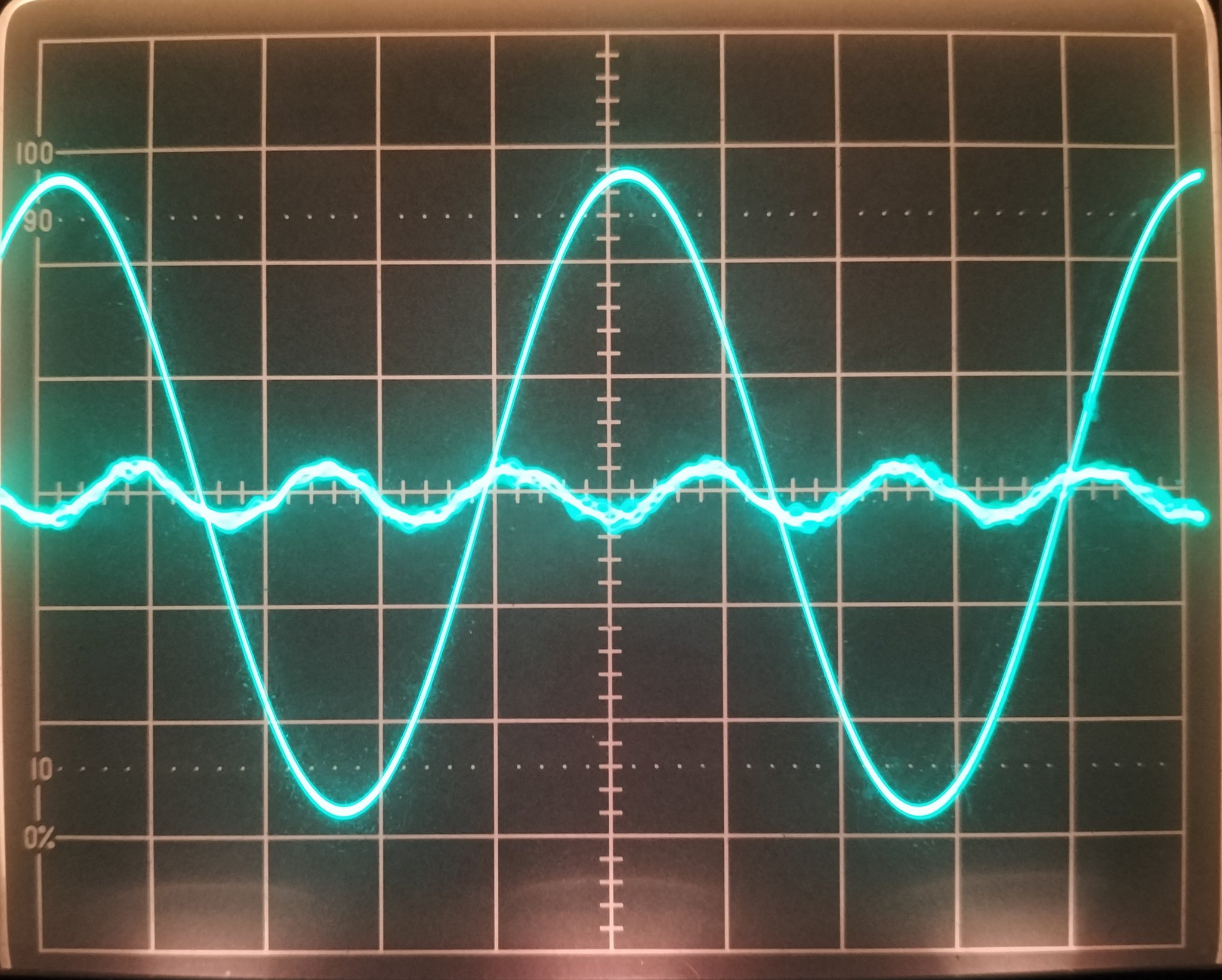

Below some measurements on OPA1633. Output distortion (quite high), 40dB gain (diff input diff output) Rs=40ohm Rf=2K. CF=220pF.
And noise profile diff gain of the circuit 200 to SE output, provides 1.2nV/sqrtHz
I have it on a protoboard, I am sure there is external noise pick up and I am also picking up 60Hz and Multiples.
Does the distortion profile look correct? I would have expected a lower distortion at 40dB.

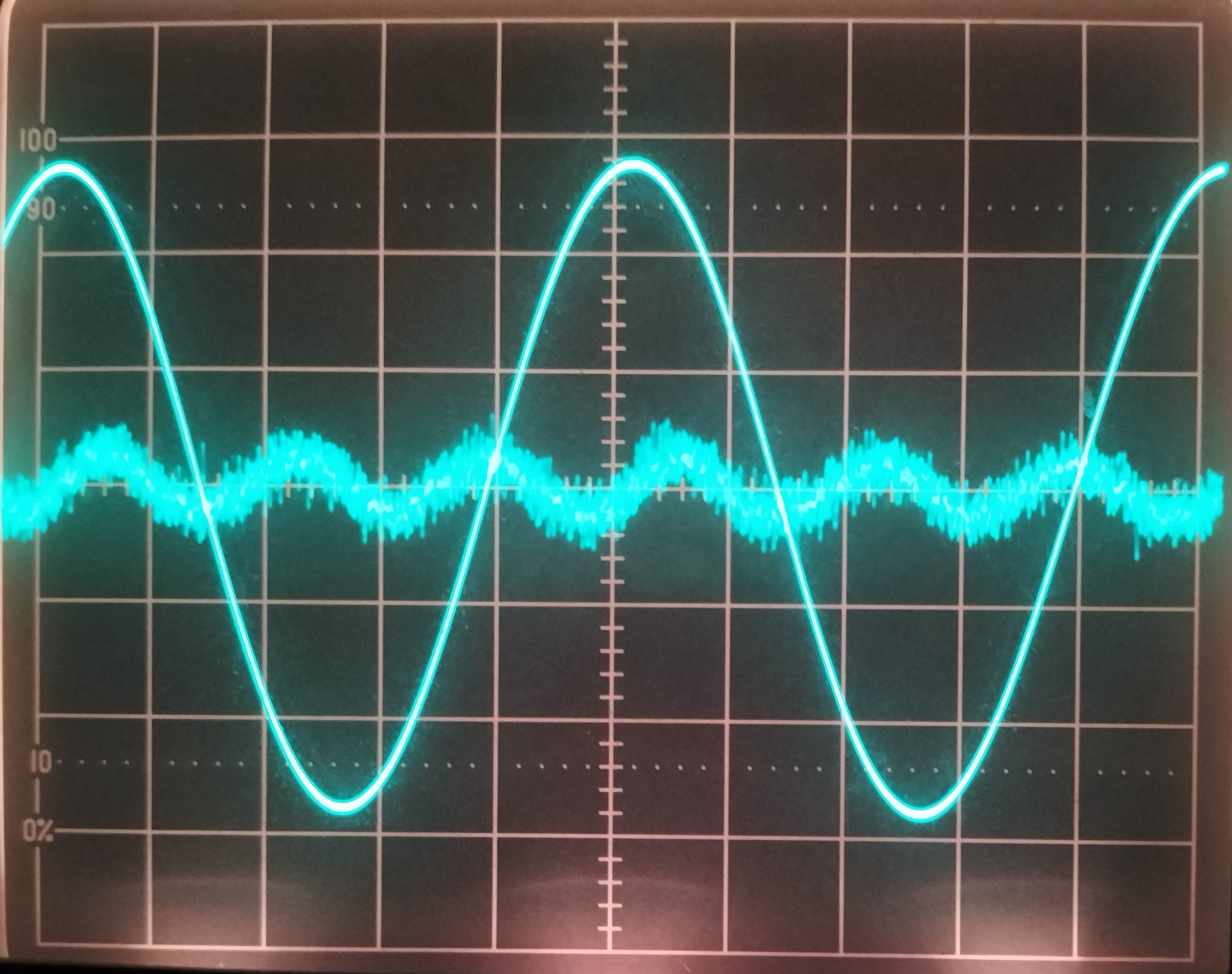

The same circuit was set up and measured. However, my measuring instrument does not support balanced, so it is a single-ended input. Because of the 100x gain, the in-phase component is negligible and should have almost no effect.
The balanced to unbalanced conversion circuit has a gain of 0.5x. This is because single-ended outputs above 10Vrms are clipped. Because of the high gain of the preceding stage, distortion and noise in this circuit are negligible.
10Vrms is measured on the differential output of the OPA1633. In practice, the 5Vrms output of the OPA1611 is measured.
At 1kHz output 10Vrms, THD+N = 0.00089% (BW = 100kHz), almost only 3rdHD.
Through a 20 kHz LPF, the noise was reduced to THD+N = 0.000773%.

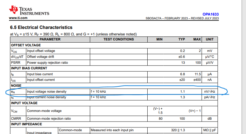

The noise is calculated to be 138nV/√Hz, from the data sheet 1.1nV/√Hz @10kHz and thermal noise in 40Ω, a noise gain of 101x (signal gain is 100x but noise gain is 101x). At least at 10 kHz, this would be around 150 nV/√Hz.
Your noise data is a bit questionable, but I was a bit concerned when I looked at the datasheet, but again the 1/f knee is high and there seems to be a lot of low-frequency noise, and given that the RIAA raises the low frequencies, it may not be suitable for MC phono frontend.

Is the 1.1nV/sqrtHz noise figure in the datasheet for the 1633 SE or BAL? I don’t see it being specified.
Lastly, as MC fist 40dB stage, the output will work in the 50-200mV at 1KHz so the noise figure is what is going to determine the TDH+N so probably on my proto I am picking up excessive noise this why I have that large distortion at lower levels.
I am going to design a prototype with few options to test and measure so once I receive it I will be able to post results.
Surely its a differential amp however its used, so the differential input pair determine the input-referred noise the same either way?Is the 1.1nV/sqrtHz noise figure in the datasheet for the 1633 SE or BAL?
You can find it listed here.Is the 1.1nV/sqrtHz noise figure in the datasheet for the 1633 SE or BAL? I don’t see it being specified.
It's not listed separately in SE or differential, but as far as I've measured the noise in #24's circuit, there is no change when R1 10Ω is split into 5Ω + 5Ω and the midpoint is connected to GND.
