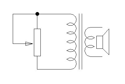

I wonder if the FRX might use an enhanced version of the Gizmo.
I think you might be onto something. Hook the speaker to the speaker side (2ndary) of an SE OPT and a 100k pot (i got one of those) with the wiper connected to one end to the primary. Now i just need to find a driver with a rising response.
Note: the 9800R secondary impedance in the gizmo corresponds pretty well to a ZEN OPT.

It is something I though as well. As a rude experiment, and it did have an effect, was to open a drawer and do a quick-and-dirty experiment with parts on hand.
I took a 50 w, 220v/12 v transformer. Across 220v winding I connected a 20 K pot, while 12v winding was connected in series with Fostex FE 206 in ML TL and SS amp. By moving a pot there was a change of balance, the sound became less shouty. I measured the pot value and then substituted it with fixed 7.5 K resistor. I believe this will work even better with an air-gapped transformer, but resistor value might change depending on the transformer ratio, and here might be "the catch" (i.e. determining the best winding ratio and resistor value) which is what I believe that Steve has achieved through experimenting and critical listening.
Anyway, shouldn't be too hard to try 😉

I just talked with Daniel about the gizmo circuit. He was instantly able to explain how it functions. Basically a 1st order LR circuit -- a tilt control.

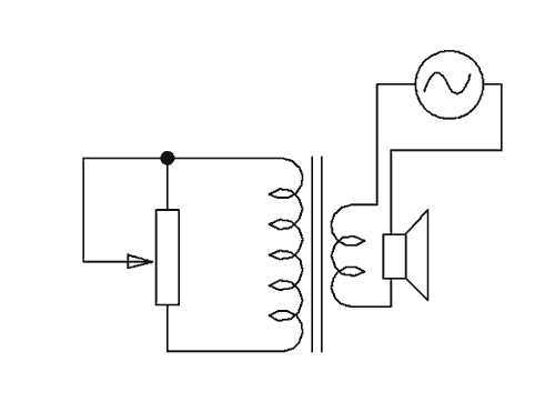

But won't the wiring be a little different, or am I just misinterpreting Steve's drawing?
impedance will be reflected by the transformer.
Where he says air gapped transformer, my mind immediatly thot of the transformers from his SE amps. A ZEN OPT would fit nicely in that can.
Finishing off the drawing should make it clear that they are the same, with the variable pot being the tuning load.
dave
dave
Thanks Dave. I was just seeing it wrong originally. Probably part of Steve's marketing, to make it look more complicated than it is...
