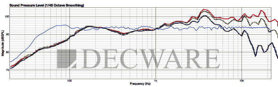

Not in itself particularly difficult. Compare the Decware plot to the Dayton one. Granted, that isn't the easiest task because they're using different scales, plus, the Decware measurement was taken loading their OB design, not an IEC standard baffle for measuring drivers. However, if you allow for that, you will note that the Decware plot indicates ~93dB as average efficiency. The raw Dayton unit conversely peaks up considerably above 1KHz; they've actually taken their average as 95.5dB. However, if you flatten it out with a shelving circuit (be it transformer coupled or otherwise) you will note that efficiency matches that of the modified Decware unit.

Plots overlaid with same scales.
Excuse the rez of the PE plot... the PDF has a bad encrypt dictionary and comes up as a bank page (an inquiry to PE got zero response), all i had to work with was a lowish rez screen capture that some kind person sent me.

Scott: yep, but OB efficiency is usually lower, so I dont think it's loss because of the EQ.
Dave, it's the off-axis measurements that are even better (the graph below that on their site).

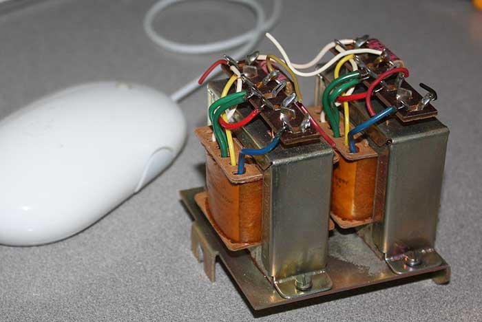

So, any guesses where to start? Looking at the "Principal of Operation" diagram, it's just an air gapped transformer and a resistor. Does anyone care to guess what ratio it might be? If there is any useful info in the diagram, the "primary" has fewer turns than the "secondary". Could I just mess around with a typical 5K:8 SE OPT? What value would be reasonable for the resistor?
OB efficiency is only lower in the LF. Above the region of baffle-losses, efficiency is the same as a box speaker or any other load other than a front-horn. The Decware modifications are essentially a transformer-coupled shelving filter which flattens out the frequency peaking of the unmodified Dayton unit and brings it to a ~flat 93dB. Dave's overlay above demonstrates this fairly clearly: take the Dayton FR graph, and draw a horizontal line from 1KHz upward. Where does it come out? Exactly where the Decware's FR is. I suspect Steve has added a couple of extra notch filters to the circuit to flatten out the ~3.5KHz & ~16KHz peaks too, although his extra roll-surround may have damped some cone resonances.
To start, it would be nice to have someone on board who has a better experience with transformer manipulations than i. We have to remember that a transformer also has a big inductance component and at least a little C.
On top of that i doubt Steve is putting all his cards on the table. Nothing stopping the tuning load from having caps & chokes as well... their impedance will be reflected by the transformer.
Where he says air gapped transformer, my mind immediatly thot of the transformers from his SE amps. A ZEN OPT would fit nicely in that can.

I guess in lei of an expert some experiments could be conducted.
Telefunken 12k to 4R on hand, have to get some measuring kit set up down here. (please no one hold their breath)

The thing that bothers me is that the claimed final response seems too good to be true. Boy would it be great if it was true! Or, how could that be right?? I have measured two other drivers that were pretty much ruler flat, that out of many many... so I suppose it is possible. But turning a non-flat driver into a flat driver implies a great many inherent issues got solved, which is very hard to do... definitely something to think about.
