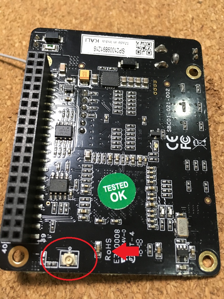

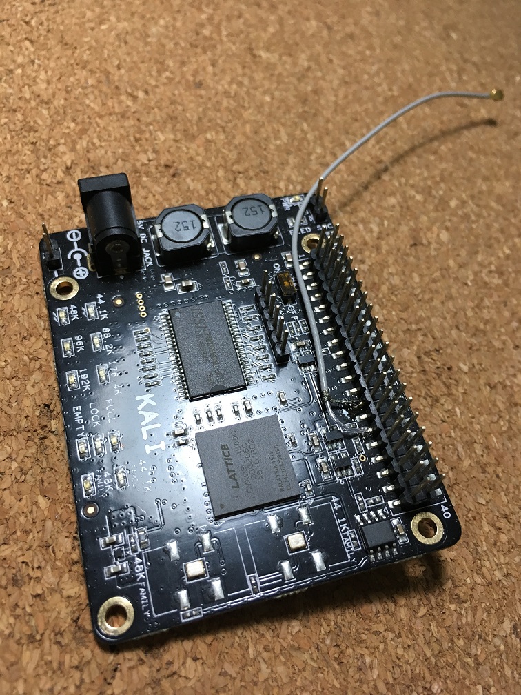

Hi cyrilliu,
As mentioned above. I need the the kali to connect the mclk to ian pcm board for AD1865/PCM1702 Dac. One way to isolate the problem may be connecting another fifo/clock board to ian pcm board or build another IV stage.
Cheng

Hi ck,
Thanks for the post. I'm glad that someone has tried connecting kali to IanPCM board successfully. Do you mean the uf.l connector at the underside of the kali board? (photo attached)
I have tried connecting the mclk signal to the uf.l connector as well as the the 40pins top connector (pin 29/gnd) of the kali without any success. I even bought another IanPCM just to confirm the problem.
Right now, I am using full Ian's Fifo/isolator/clockboard/IanPCM configuration with Rpi3(Volumio) & different nos dacs.
I hope to get the kali to work with IanPCM someday, as I actually prefer the simple minimalist one board solution and since I have another IanPCM board lying around 🙂
I will send you a PM.
Cheers
Cheers
