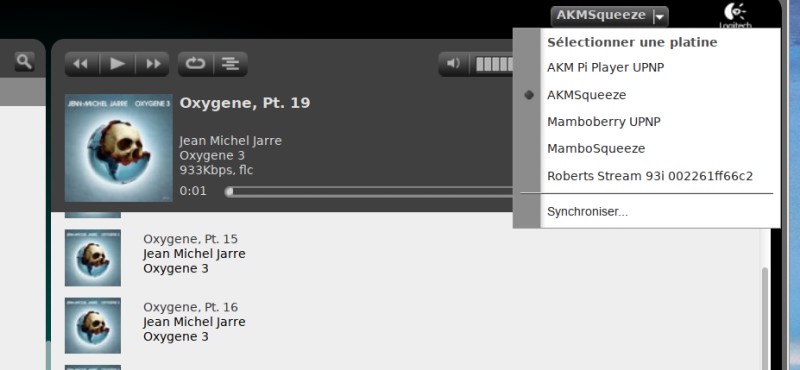

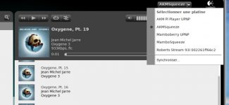

On my Kali+4495 I also experienced clicks at Play/Pause Stop/start with Moodeaudio 3.1. After some tests, it seems to me that UPnP protocol is the problem.
I installed LMS (Logitech Media Server) on one of my Linux PC + LMS UPnP plugin and activated Squeezelite renderer on Moodeaudio. Now I can choose between UPnP protocol or Squeezelite. Conclusion : LMS with Squeezelite protocol plays very nice on my Kali+AK4495 setup (no clicks, etc) while LMS whith UPnP suffers from those clicks at stream interruptions.
Moreover, I think Squeezelite renderer sound is better. LMS + Squeezelite renderer in Moodeaudio is my current setup. It integrates also a lot of plugins that are important for me like Deezer and Qobuz that Moodeaudio currently does not offer.

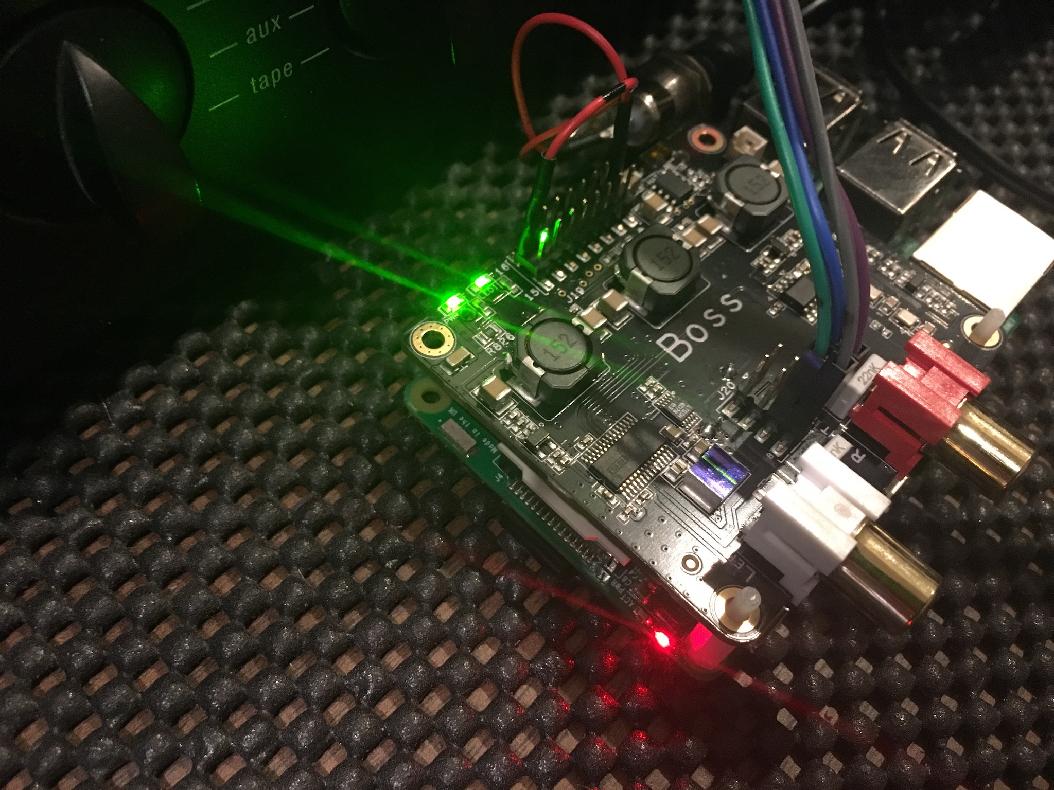

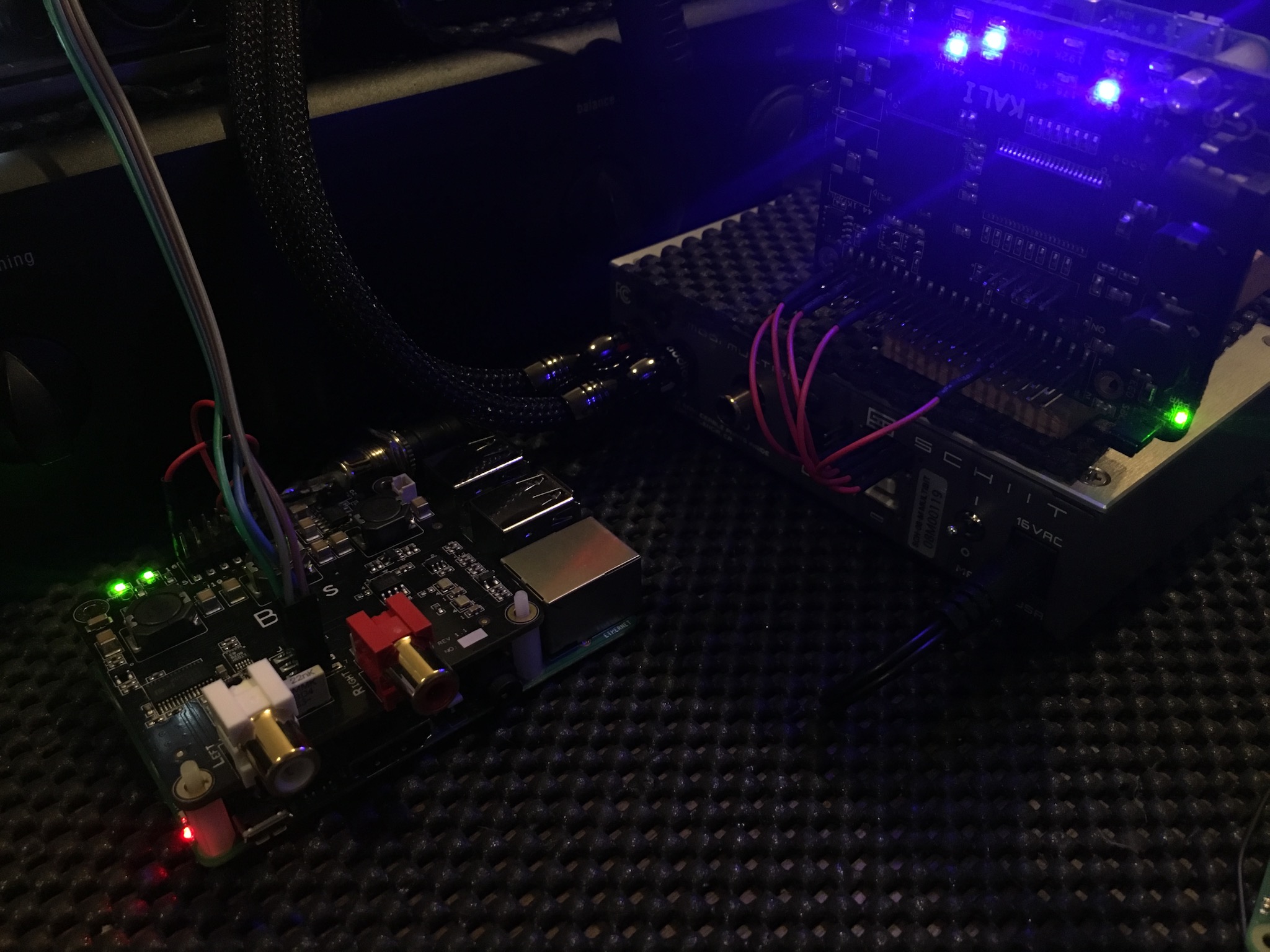

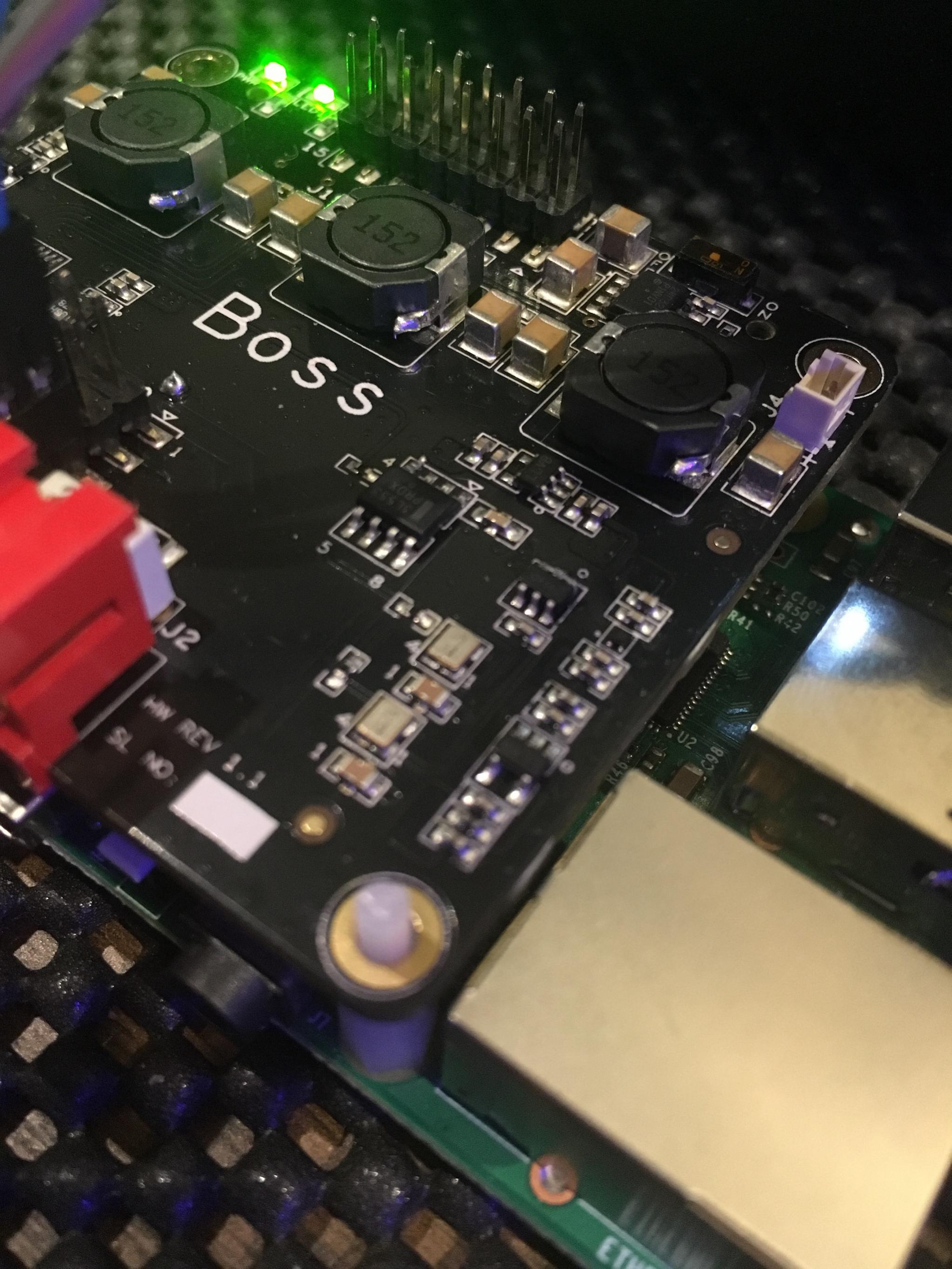

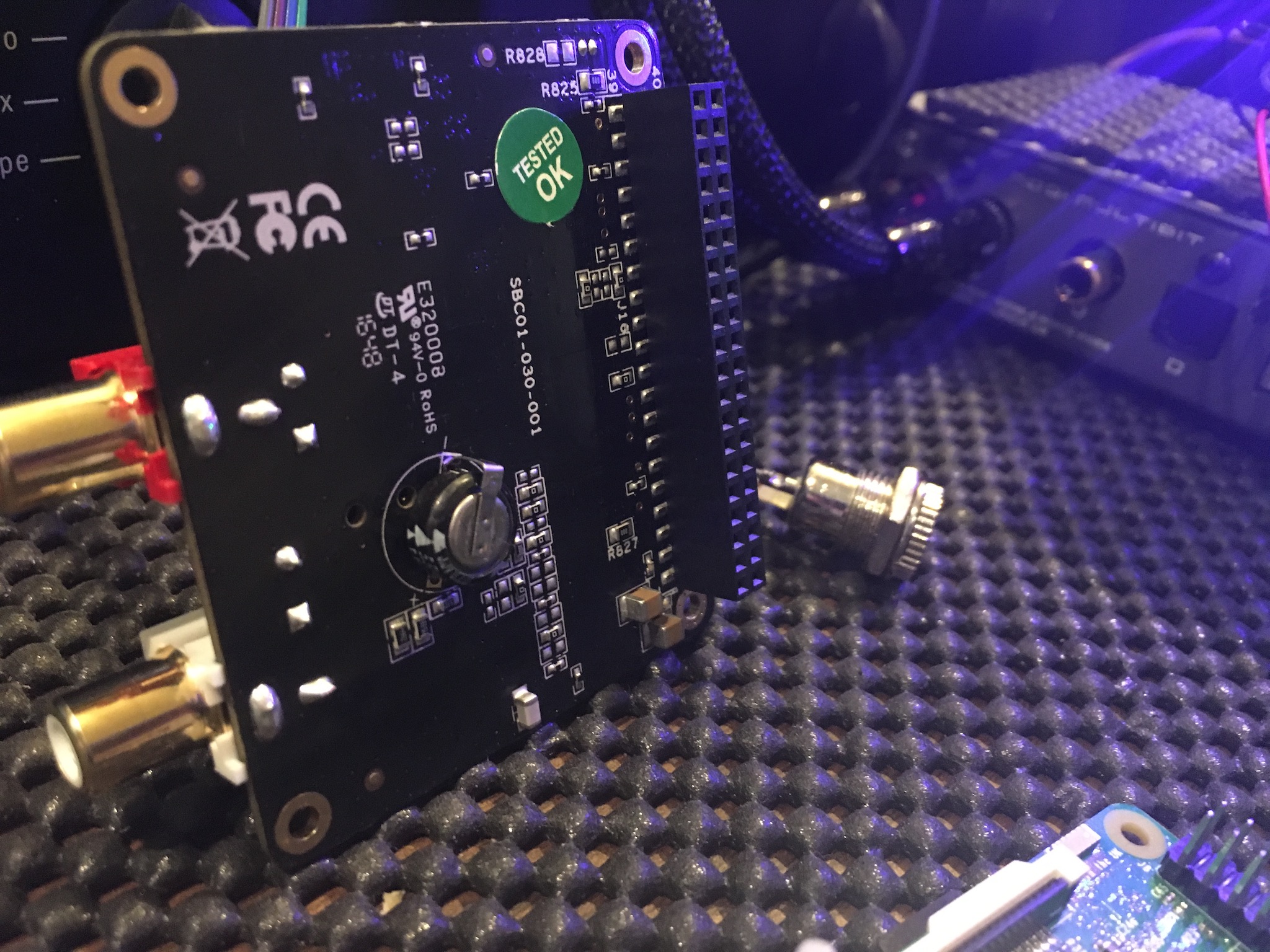

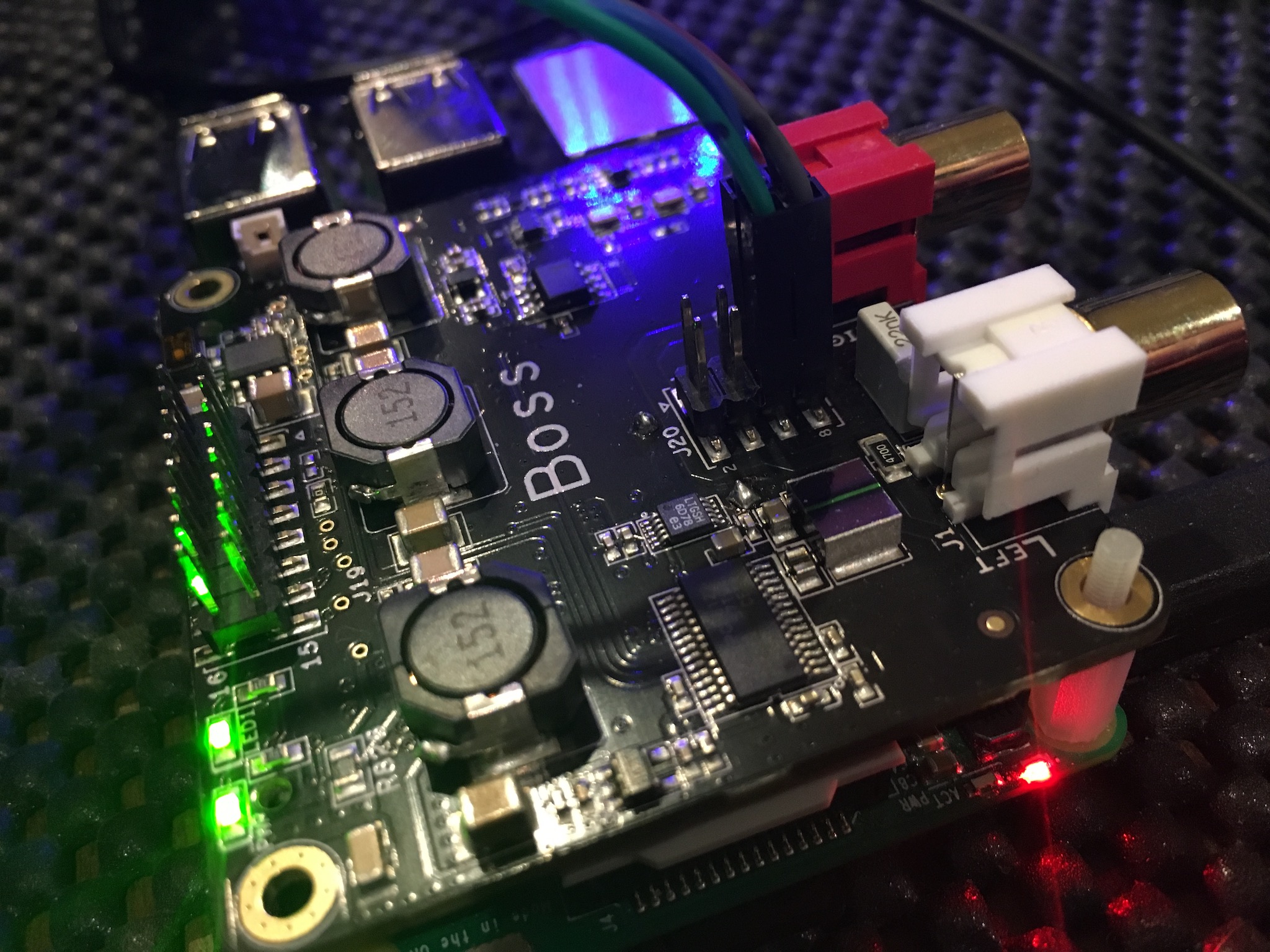

Sure is an exotic looking film cap on the LT3042 analog side:
And yeah! Finally separate regulator/filter on the clocks (just in general):
This hasssss to more than the Ti/BB PCM51xx deserves 😉
Need to get the drivers open-sourced & in the official linux!
...and interesting overkill supercap--
Boss pics look very good. I'm very curious to hear reports on it. And even more curious to get one to play with.
