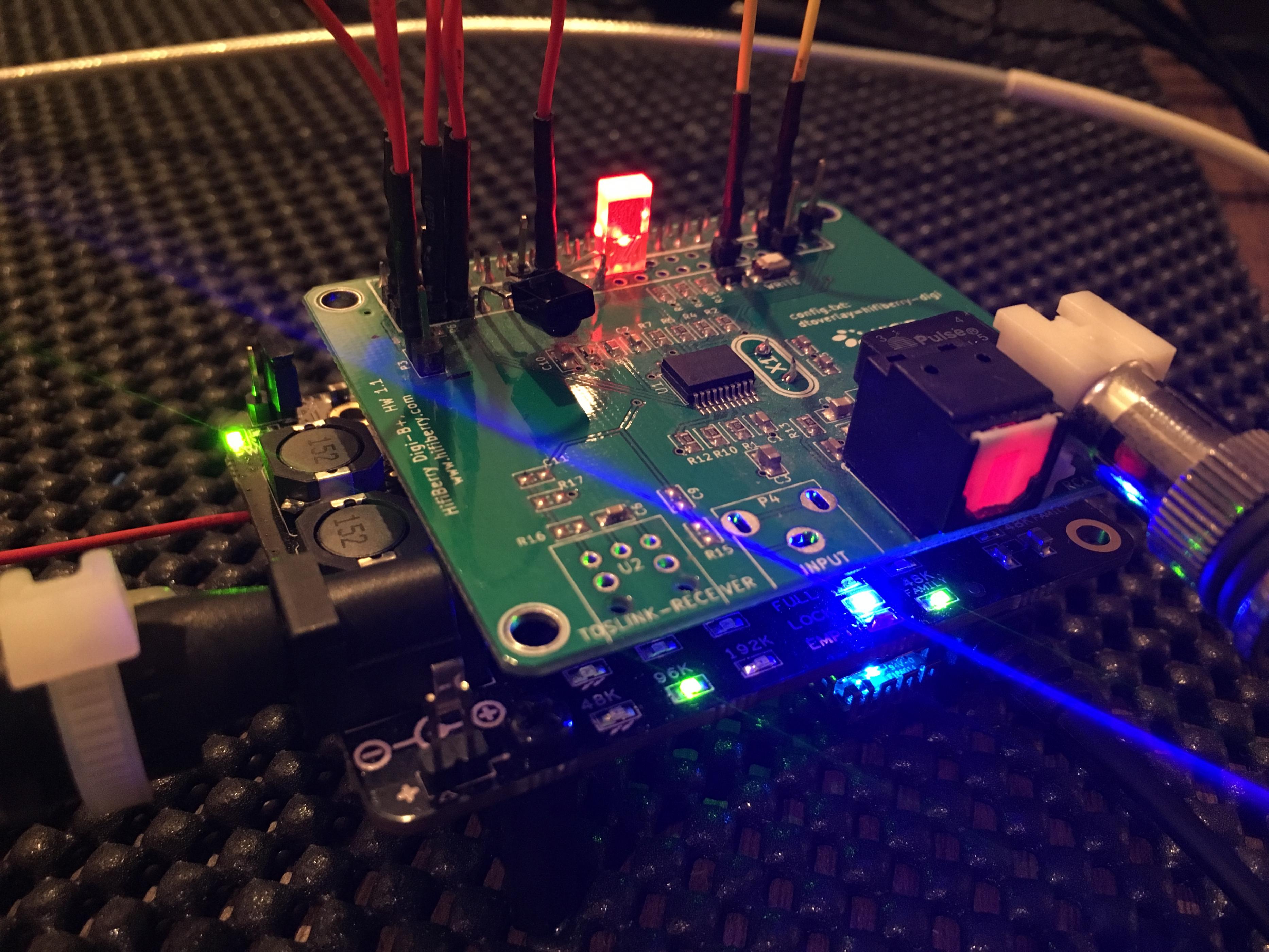

I give you one standard hifiberry digi+
* forced into hardware config mode
* set to slave mode in hardware
* kali MCLK pin29 --> digi+ MCLK pin36
All with jumpers 🙂
sitting & working on the the kali (using the generic ES9023 driver)
( it did take an oscilloscope to slowly figure this out, the wm8804 datasheet & pin layout. What can I say, was bored this morning )
It's playing music!
Now to see if it's worthwhile (don't now if PLL still involved, all that crap) BTW, this is one of the buggy kali192's
(signals look crappy 'cause resolution goes down on the scope the more channels you use... can't get the full 1Gig samples/sec)
channel4 is spdif, then continues on to a Dac, listening now:

...more re: kali <--> digi+
verrrry sensitive to the MCLK jumper, just tap it all kinds of interesting distortion-- will need to change that. No wonder Ioan added a U.FL connector for that underneath.
notice the digi+ running without its always on green LED, maybe that's set on with the driver, interesting.
that orange GPIO LED is just set on by squeezelite, just something I do
Thanks Greg!
Didn't even expect to make that post, but it lit up & worked...! 🙂
Will follow up on sound quality. See if it's a go or not.
Kinda cool, huh... set a few pins low, jumper the clock over. So simplistic once you are there.
