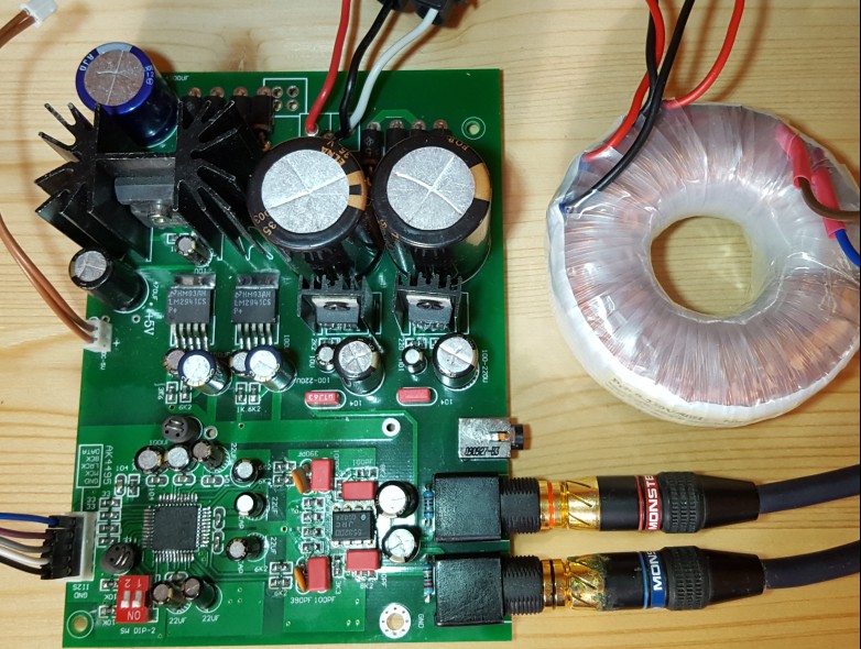

Isolator board for RPI/ i2s/ i2c
We are working on a isolator board for RPI . The basic design is over and I just want some feedback .
i2s isolated---configurable as master or slave
i2c isolated --bi directional
GPIO (1)
Power:
On board isolated DC/DC convertor 5V (380ma) ... ripple less than 15mV
5V pass through ---3.3v using LDO 200ma
External :
Batteries linear psu etc... a minimum of 6V (to 19V)
LDO1---5v standard (but configurable 7V , 9V and 12V output ) 500ma
LDO2 ---3.3V standard (but configurable to 7v , 9v , 15v) 200ma
You can use only one PSU at the time (disabled if not used by SW)

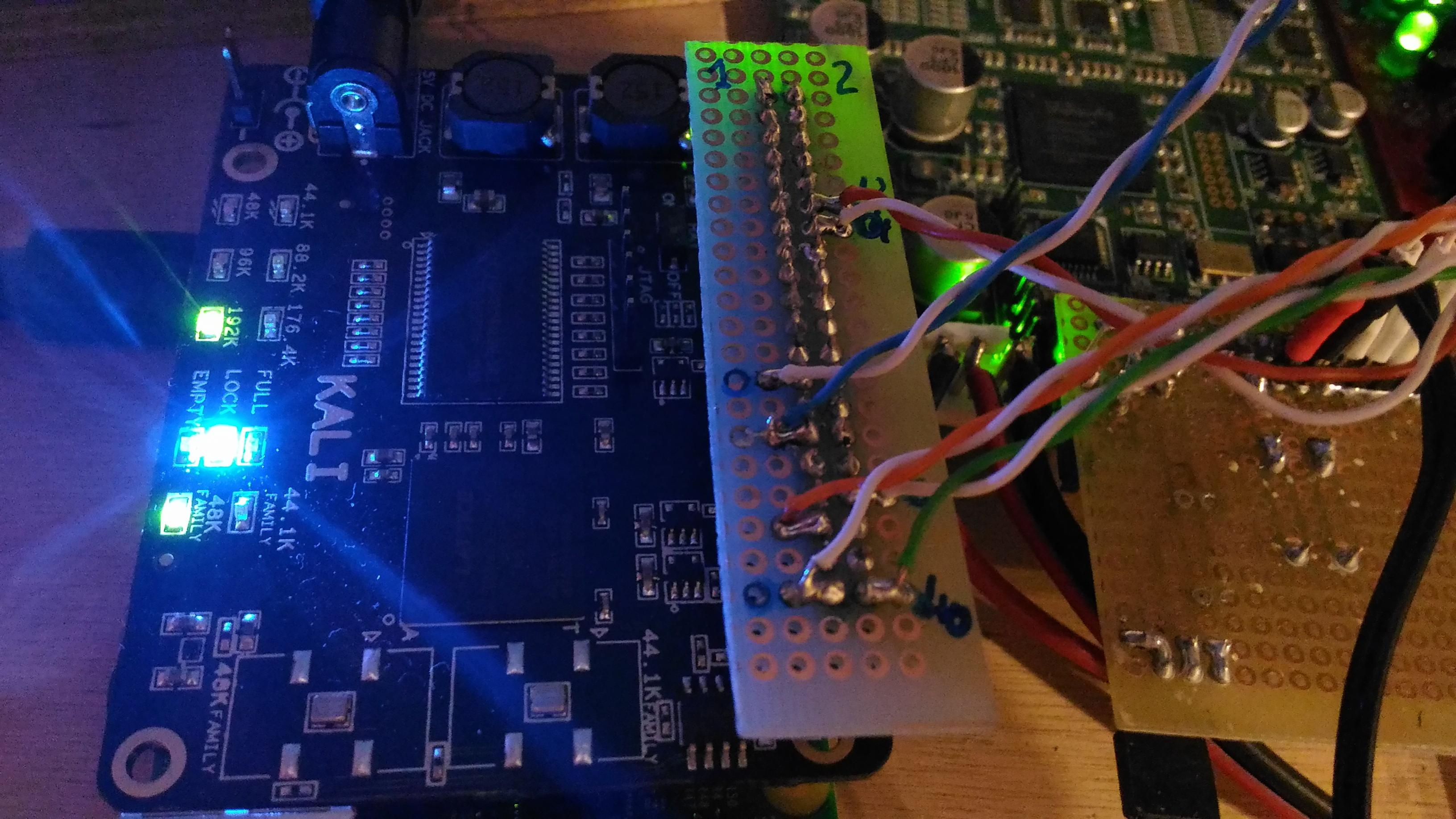

Hello,
I'm slow but fanatic!
3rd test:
Cubietruck + Runeaudio => I2S => DAM 1021
VS
Raspberry Pi2 + Runeaudio => I2S => DAM 1021
Both systems work well, Raspberry is a bit more silent but the sound of Cubietruck is more dinamic and life like.
4th test:
VS
Raspberry Pi2 + KALI + Runeaudio => I2S => DAM 1021
DAM1021 is insulated and reclocked but with Raspberry and Kali everything seems ok, no harsh and full of life.
For the moment in my system Raspberry and Kali are the winner.
I hope this help.
Regards
Guglielmo
