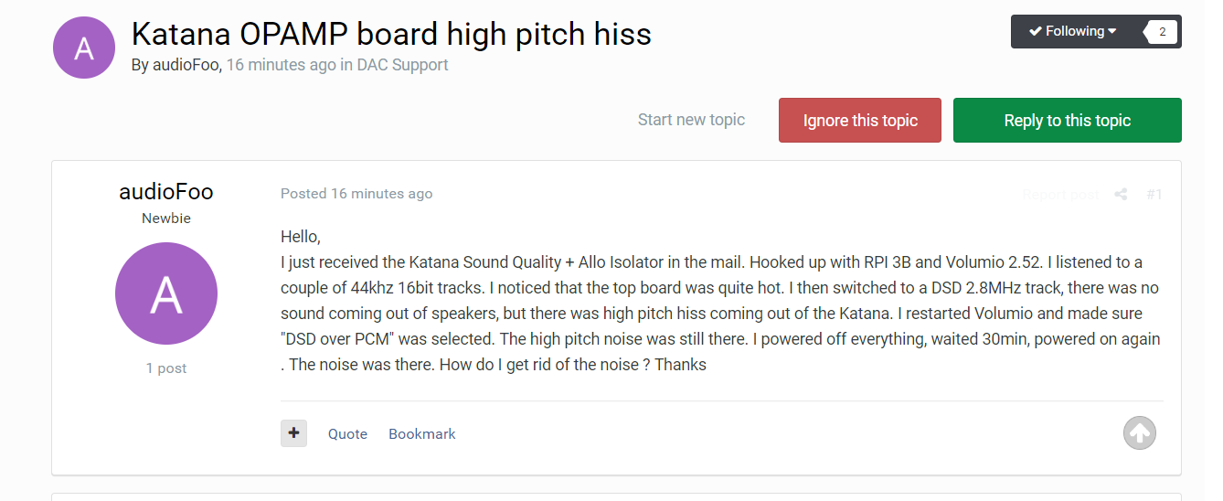

Cdsgames,
I think heating issue is not only encountered by me. I see a dejavu with my unit. Very Identical issue.
Look at this complaint of katana use in A/S forum!

sent it to sudeep.. i dont know what failed.. but it was damn hot..
the guy confirmed.. we have the same issue..
i think my replacement Katana was not the lone defective unit..
good thing it is replaced..
