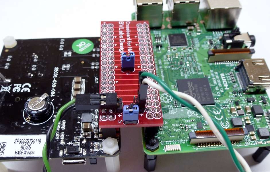

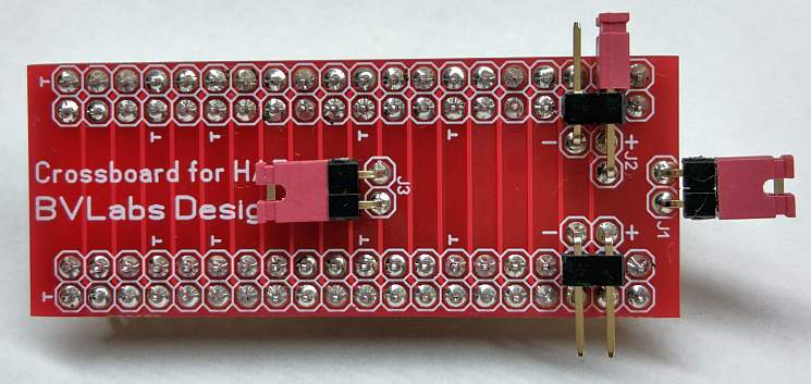

This device was developed by me for comfortable conducting experiments with separate power supply. Jumpers can flexibly switch power 5 and 3.3 volts. Also through these pins, you can apply separate power to Raspberry Pi and HAT.

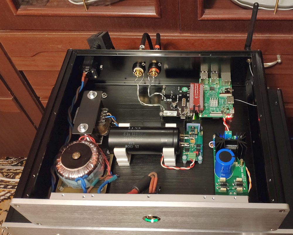

I finally have my 4 Linear (3 physical units, one has two halves) hooked up to the Allo Katana DAC with Isolator board.
I could not get the player to work at first. I kept getting ALSA and MPD errors. I flashed a the SD card with a fresh install of Moode 4.4 and still I had the same issues.
This is what I had to do. I have a DIY board based on the LT 3042 Voltage Regulators. This is powered by a 6 volt dual winding toroidal Transformer. This board has dual halves so you can use it for the low amps boards. I am using it for the Katana DAC and the MC board.
I had to power up the board is this order to get the unit to work.
1.) Katana Dac Board
2.) SQ output board
3.) MC Board
4:.) RPI Board
I have wires soldered to the MC board underneath and I also have wires soldered underneath the RPI board. I am NOT using any of the USB inputs.
I did wait like from 15-30 seconds between powering up the boards.
The unit is playing into my powered speakers and later tonight I will hook it into my tube amp.

MC side takes almost 1A..lt3042 are rated at 250ma unless augmented by a mosfet
Jrocker,
You are correct. I have a military Linear regulated +/1 15 Volt PSU powering the SQ board. Tonight I listened for the second time and I am so amazed at the musicality I am having.
The Ball LF's seem to be going down 1-2 octaves. The unraveling of complace such or classic music is a joy. The resolution is better, the separation of instruments and vocals is better. The vocals are clear, I can fellow them better than ever. Across the board, the music is better and that is what matters most.
Please note: 4 supplies - he has a separate +/-15 VDC power supply powering the Sound Quality OpAmp board.
So, no - the micro controller load is no where near 1A on the LT3042.
