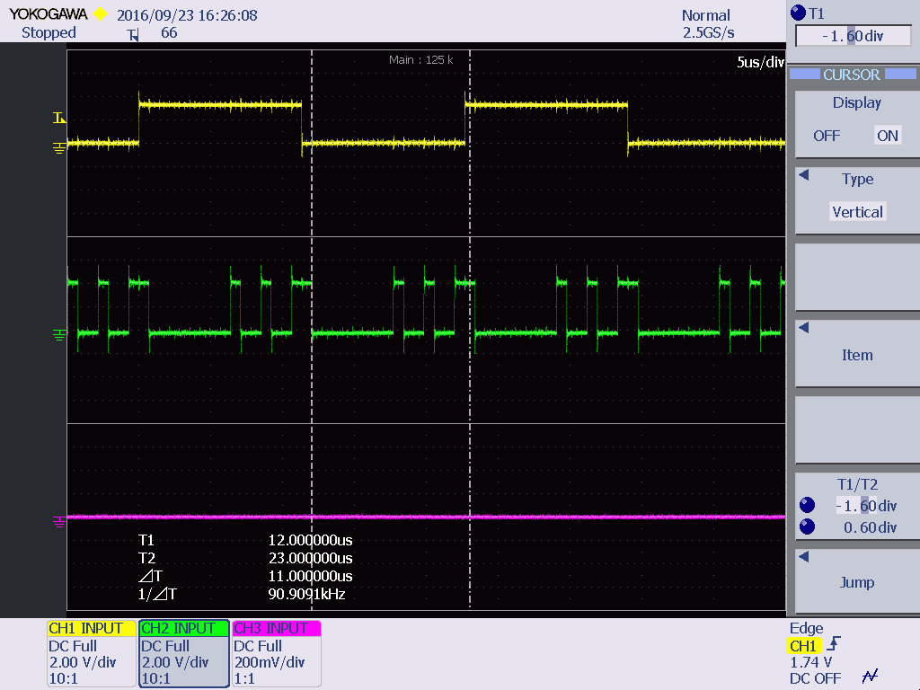

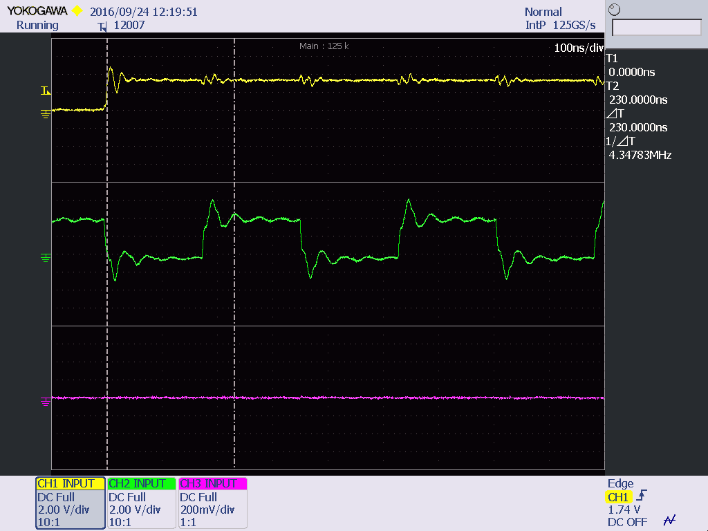

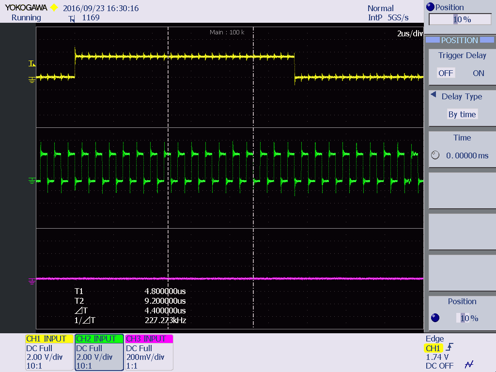

This is the latest reading on 16 bit. It works fine ..
This is done with lots of wires around..lots of ringing because of it, a better capture is coming that reflects better .

@ first picture is Latch L/R yellow, and System clock (BCK) magenta
BCK has to be inverted. (IF latch follows L and R datas...)
When L/R goes from 0 to 1 rising edge, BCK goes from 1 to 0 fallen edge...
Please correct software.
And MCK should be also going from 0 to 1, same as the L/R and BCK (after inverting)
Hi, Yes please try to invert the BCK green line.
Wheh LR goes from 0 to 1 rising edge, BCK goes opposite from 1 to 0 falling edge...
Should be like this:
And MCK output AT The same place should go from 0 to 1 also rising edge.
One BIT clock BCK after LR change state. Should be no data bits. Most significant bit starts from 1 period of BCK AFTER LR change.
All word formats - all sampling rates

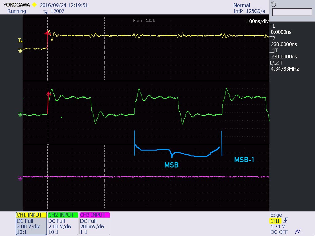

the MSB has a fixed position, whereas the position of the LSB depends on the word length.
The transmitter always sends the MSB of the next word one clock period after the WS (LRCLK) changes.
Serial data sent by the transmitter may be synchronized with either the trailing (HIGH-to-LOW) or the leading (LOW-to-HIGH) edge of the clock signal. However, the serial data must be latched into the receiver on the leading edge of the serial clock signal, and so there are some restrictions when transmitting data that is synchronized with the leading edge
Hi Zoran ,
First lets look at MSB, you are correct that MSB is the second bit...but before the MSB its the LSB or the padding (not exactly sure) of the previous sck..so basically "there should be no data" is wrong.
Second you say that when LRCK is rising , BCK should also rise.. that is incorrect. LRCK rising --bck is falling , lrck falling --bck falling

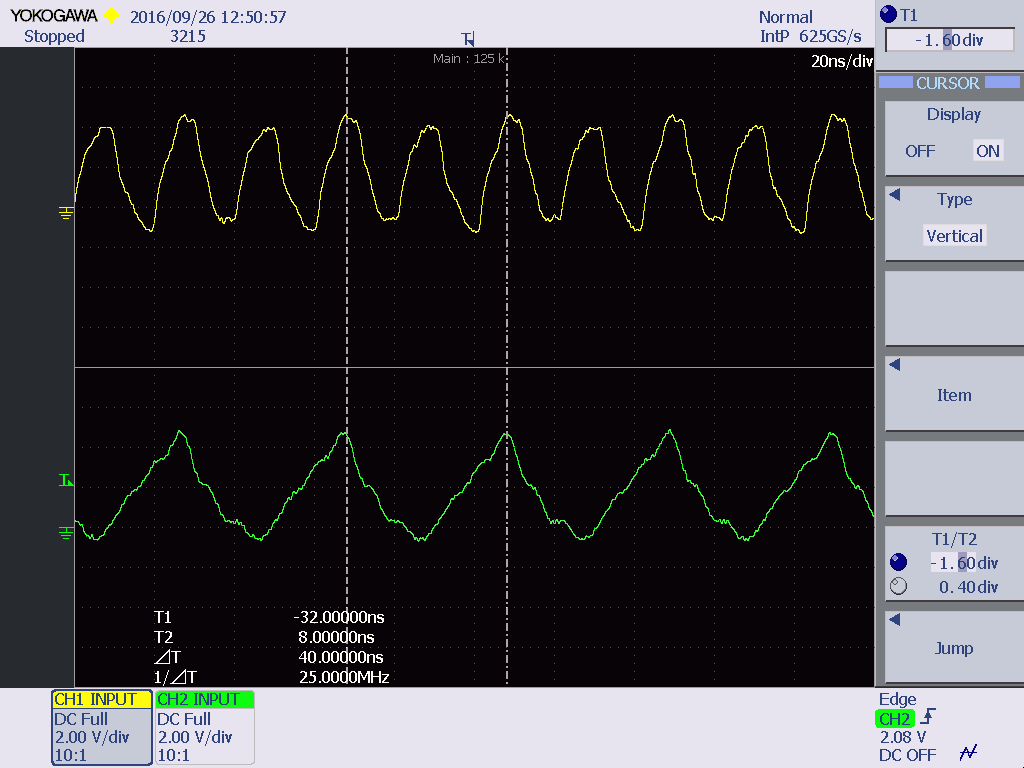

Could You Please post some MCK and BCK signal?
(I am not writing without the reason - preparing to order 2 pieces to test... 🙂)
