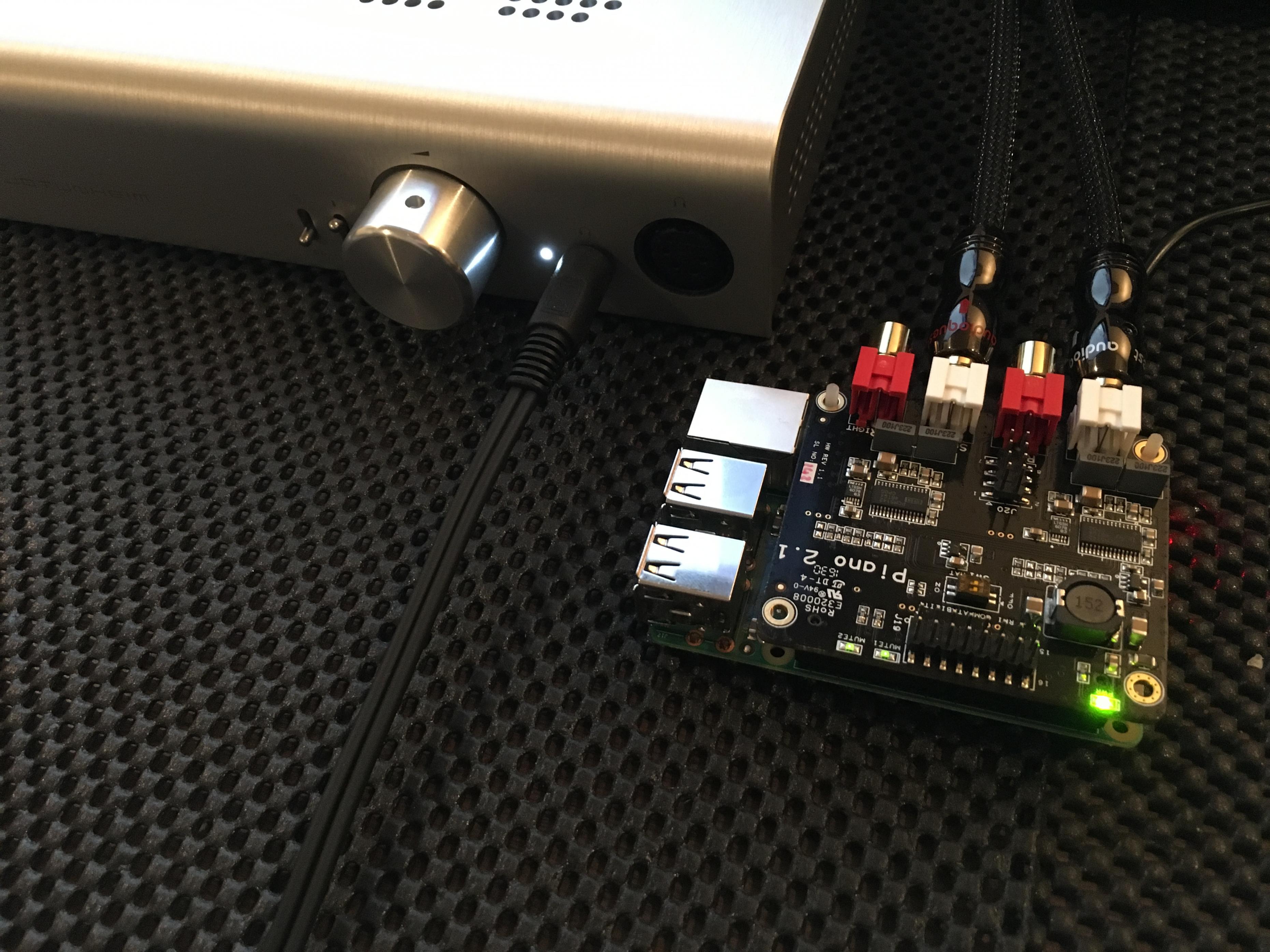

This is completely preliminary, just initial setup/experimenting.
I plugged in the piano, booted with your max2play image... there is crossover high/low output on both dac's (set to 60Hz sub output)
Hooked into my headphone amp, is the output supposed to be so low? In the pic thats the headphone amp set to high gain & volume maxed, and it is still quiet... maybe this is correct for your AMP board? Seems low for the sub output via: RCA

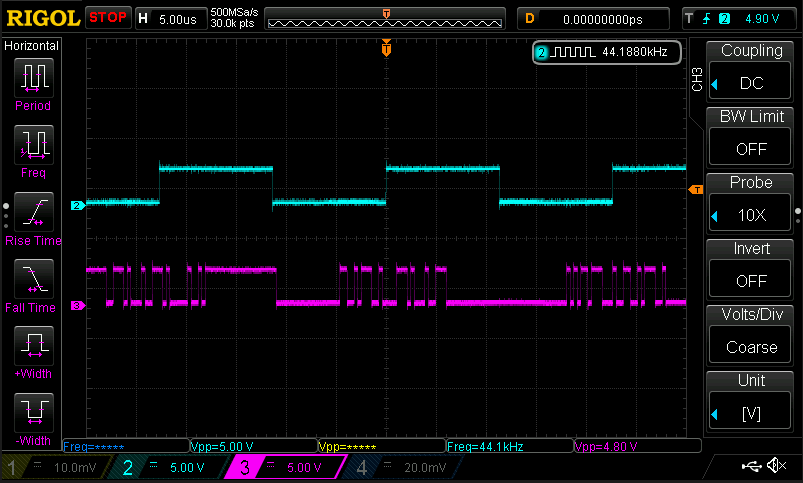

For the record, these are two captures of a 16bit I2S stream, playing a 440Hz sine wave on the left channel only.
This one is the RPi's output:
And this one is Kali's output:
I'm surprised that this I2S stream produced actual music..
IN I2S specs is that MSB bit (most significant bit) is ONE BCK (Sys CLK) after the L/R latch changed...
So I think the input have some bits NOT one bit after L/R change but right in L/R changing state? So in input bus MSB is not present because DAC wil not read it since it expect MSB and other to come one BCK clock after L/R change.
Other one, output i2s bus, should be not producing music... 🙁

The RPi's I2S is definitely bad, but I believe it's worth doing a comparison with/without Kali. It's good to have a baseline..
I agree that a better test is Kali vs. master mode DACs.

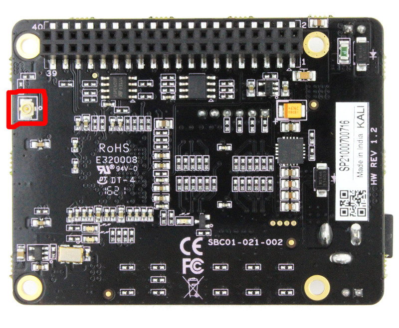

Kali do not have input MCK? But only output MCK selected probably from one og the oscilators present, with a respect to the time base 44.1KHz or 48KHz n x sampling rates.
The input I2S bus - 3 lines, is from bottom pins at the conn
Output i2S bus - 4 line, 3 + MCK
One thing should be checked:
what is going on with the MCK and SCK lines are they from the rising edge of the clock or falling edge. other words if they are like it should be or inverted?
for the reference please take a look on the I2S standards.

Honestly, I am not sure any of the drivers for the R-Pi output a MCK. None of the R-Pi DAC HATS I have here or that I'm familiar with input an MCK from the Pi. Even the HiFiBerry DAC+ Pro which runs in Master mode uses the BCK as the master it sends to the Pi.
Also, none of the other reclockers with which I am familiar, Ian's Async and Acko's synchronous setups input a MCK.
Also while the output glitches are clear in the scope pix, the Kali works and the improvement is clear in using the device. I DO expect clearing up the glitches will only improve the sound.

Hi Zoran ,
Kali receives data on raising edge and sends on falling edge.

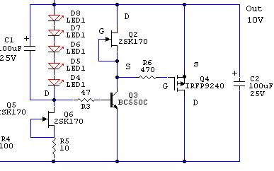

if anyone wants the ''best sounding reg'' for 5v, i'd go with salas shunt regs, especially for 5v and above. I have tried many regs (superreg,ldo's,sigma22,tl431,lm317(the lm317 sounds surprisingly nice for some reason...),etc.) and that one is without any doubt the all around champion. There are many versions that will give different flavors and each part substitution gives a different sound. Right now i'm using the attached topology wich i find the best. i'm not using these parts though.....the first part swap i'd make is change the ccs and shunt mosfet for irfp9240 (or irf240 for a negative version). As for the rest of the parts, it's a question of taste, according to me.
i also have a very nice 3.3v version using 2sj313 as shunt , but it is not a widely available part....i'm still trying to find a good sounding one that can be ordered about anywhere.
so just my impressions, but i've spent many hours comparing and listening 🙂
edit:
just wanted to add: there is a ''digital'' salas reg i have yet to try, so this is not a final testi have done, but it's a good (very) start 🙂

Hi Greg, right,
that is why I asked, IF there is INPUT MCK to the FIFO then could be option of sort of sync. mode. But the FIFO is targeting Ras Pi, which as i catch does not have MCK output.
According to I2s specs:
VLow < 0.4V
VHigh > 2.4V both levels able to drive one standard TTL input (IIL =–1.6mA and IIH = 0.04mA)
Input Levels:
VILow = 0.8V
VIHigh = 2.0V
The I2s Bit-clock (BCK) taken directly fron the RPi GPIO meets the above specifications (output level I2s specs).
Obviously, the ultra HF noise shown on the osciloscope traces is significantly higher in the case of a RPi , but within the safe zone.
A proper termination of I2s lines is needed at the receiver end (i.e. the DAC) and this might further improve the performance of the RPi2 I2S lines
