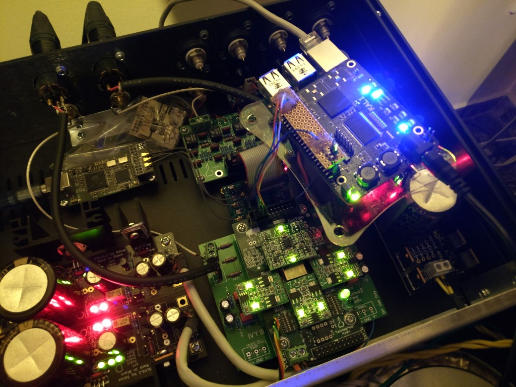

Last night we got together with tuxx and a couple more friends to have a listen to the Kali in my system.
The audio chain was as such: Raspberry Pi 2 running Archphile -> Kali -> Buffalo III -> Hypex UcD400s -> my DIY floorstanders.
The RPi was powered through Kali with an SMPS capable of supplying 5V/4A.
We listened to a few test tracks both with and without Kali in the audio chain. When we were not using Kali, the RPi was powered by a second SMPS (5V/2A) of reasonable quality.
It did not take us long at all to come to the conclusion that Kali made a very substantial improvement. In fact, I can say that I haven't heard my B III perform this good before, and I am comparing the RPi+Kali combination to Amanero & XMOS designs. The difference was so obvious that our eyebrows were raised almost instantaneously.
So I can definitely say that anyone who is using an RPi as an I2S transport has a lot to gain by putting in a Kali. The RPi does indeed put out very bad sounding I2S.
Congrats to cdsgames' team for making a fine piece of hardware (and software).
Next up is teaming Kali up with my Amanero, plus of course trying out the Piano 2.1 board.

@ tuxx and Dimdim:
Given that you hear a clear improvement with Kali, I would be interested to know how the Rpi + Kali into the Buffalo now compares with whatever is your preferred reference source into that dac. Does the Rpi still lag some way behind?
John
I have a feeling that the RPi + Kali bests my reference source (Squeezebox Touch with EDO + Amanero).. I will do more tests and let you know.
Btw, I think I figured out what is going on with the channel swap. I'm awaiting confirmation of my findings from the designer.
If the channel swapped that could lead to the other lines in I2S bus inverted.
Like data bus - if data bus inverted than with channel swap you will have ot of the phase, booth channels, signal after the DAC.
It should be measured with osiloscope with dital signal option and check
is the master clock is at rising edge or falling edge, System clock, data, and L/R latch line too.
And compare vs I2S standard.

The pin header on Kali has the same pinout as the RPi's GPIO header so I2S is located at the same pins:
Yeap we got it...on the 16 bit files there was a swap and some nastiness ...seems it was fixed on new firmware.
Could you elaborate on "nastiness" please? 😛

Perhaps you can explain to the people how they get the new firmware onto their Kali?
Paying customers will receive exchange units for free.
Testers, we are ready to send a new Kali (up to 384Khz this time) with the corrected code. Note that the bug is only seen on 16 bits.
Thx to Dimdim for finding the problem.
Oh, I see. When I said explain.... I was thinking you were going to make a firmware file available and explain to the people with the necessary skills/ability, (of which there are more than a few on this forum), how to upload via JTAG header...... But if you are going to send them another board, that's cool too!
Yes, thank you Dimdim. It's not like anyone else even noticed the channels were swapped! LOL.
Guilty!
