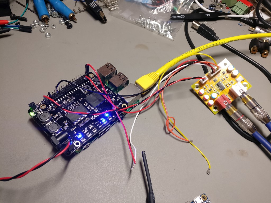

Last night I spent some time listening to the Kali board on my workbench.
My test setup was: RPi with Archphile -> Kali -> ES9023 cheap DAC -> α20 headphone amp -> Fostex t50rp mkIII headphones.
Archphile was running mpd, fed from a NAS (Ethernet).
The RPi, Kali and DAC were powered by a benchtop SMPS.
I did A-B tests, with the only difference being the introduction of Kali to the chain.
I did not have much time, so the first audition was a short one.
The difference in SQ was pretty obvious.
It was not related to frequency response or anything like that.
Kali made the music sound more real. There was a lot more detail, the $8 DAC suddently started playing actual music.
All this happened with the very out-of-spec I2S wiring that you can see in this picture:
attachment.php
Things might change a bit once I do a proper setup, but I suspect that most of the improvement will still be there.
I am very curious what will happen when I hook it up to my Buffalo III. Stay tuned..
<SNIP>
<SNIP>
<SNIP>

Does anyone know of any other options for SPDIF output that would work with the Kali?
Ioan, perhaps you could put something together...? ��
Kali will not work with DACs that run in Master
spidiff output from Kali its possible with a shield to sit on top of Kali.
Still,I remember that spidif ICs (i2s to spidif) add about 40ps of jitter.
I guess this would negate the benefits of the Kali?
I wonder how that level of performance would compare with the jitter of the HiFiBerry Digi+ Pro, which is a Master with 44k1 and 48k clocks.
