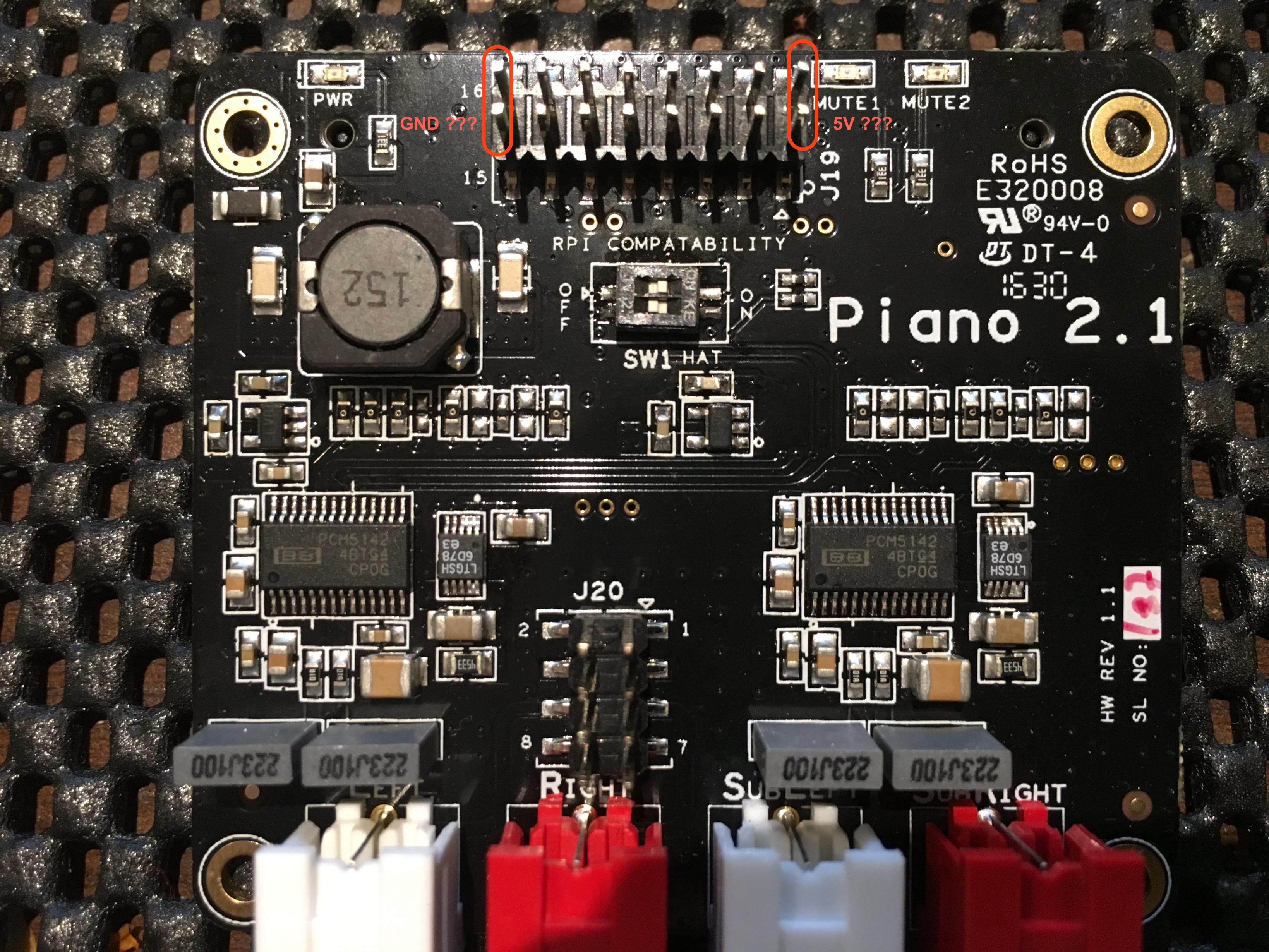

@cdsgames
Can the piano be powered externally on these pins?
