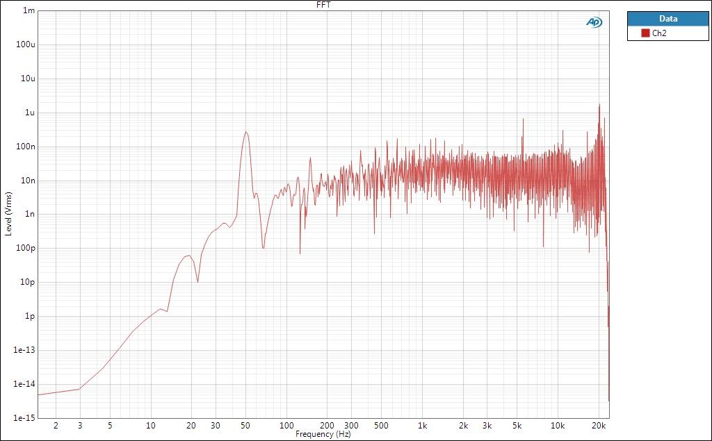

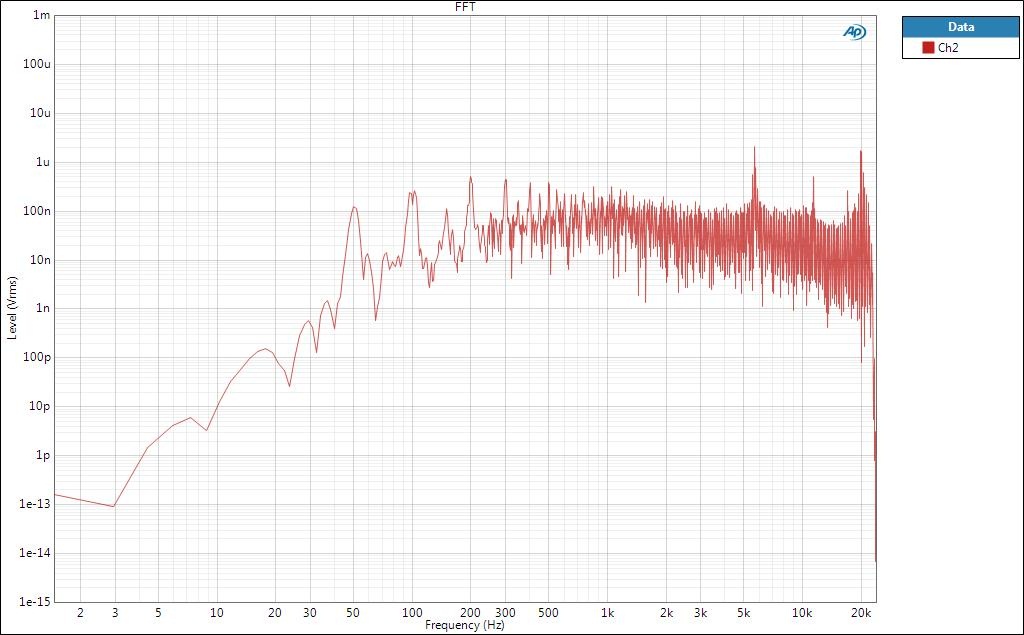

Nirvana PSU
0-3.1 A max power
5.2V output at 0.5A
5V output at 3A
We are awaiting new PCBs for Nirvana PSU. Production is still pending on new PCB testing , FCC approval , so its not for right away
I am attaching some readings taken at 1A and 2A.
Please note that those are real readings in real office environment . In controlled environment we get about 15% less noise
In our testings no SMPS on the market has less noise. (even if their marketing says otherwise)
Differential noise at 20Khz is only one thing... still HF noise is important. Also think about common node noise and leakage currents.
Nirvana was made to shine in :
0-20Khz DM noise (and up to 10Mhz)
Common mode noise is very low
Leakage currents (very low to beging with) can be removed by grounding the DC side using a sw (or left floating)
Impendance (right at the output connector , yes Klaus we have the screw in at that point , we added some capacitance and supercap)
Before I forget...one more noise we took care of. Diodes (and mosfet SW) are filtered multiple times so your mains (AC) wont be polluted by RF. We really made a lot of efforts to clean it since lots of people will use Nirvana with sensitive audio equipment . CMC , RC snubbers were used across every switching element along with inductors on ground and +
Since this is not analog , I am confident what machine testing say : Nirvana is an over engineered SMPS that was designed to be the best 5V power supply in every aspect of noise.
