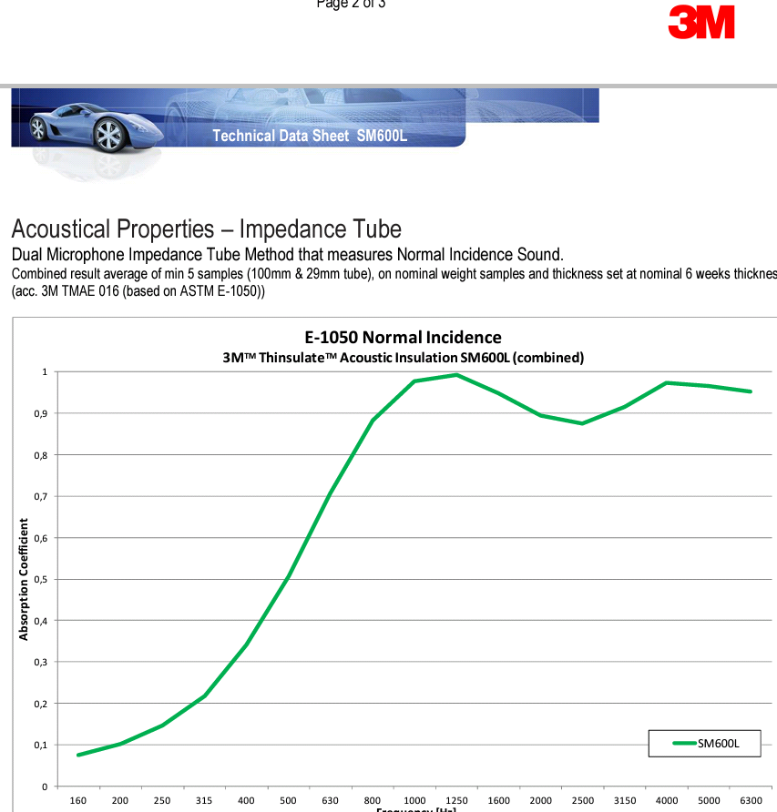

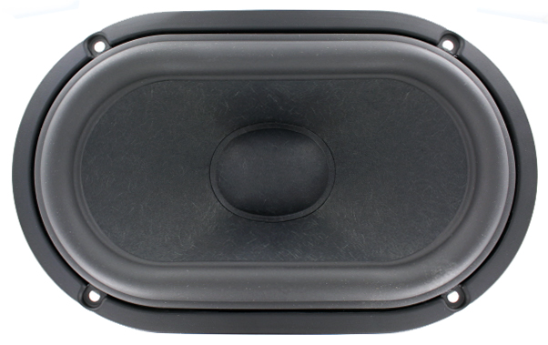

AMT's arriving here in Michigan on Friday(!!), working through 2 possible configs:
1) Nearfield SLOB with smaller woofers, so that the slot cancellation frequency increases from ~500 Hz to maybe 800 or so. These 5" deep by 8" tall SB's have twice the area of a single 5", so they're currently interesting
SB15SFCR39-8
SB Acoustics SB15SFCR39-8 5x8" Paper Cone Woofer
2) LX mini style with "back wave absorption" tube/thingy for placement near the back wall. Long story short, we're building a truck-bed camper and some analog XO LXmini's as a reference for really small spaces. We're using insulating material (3m thinsulate) that seems to absorb very much like the high pass XO.. We'll see what happens 🙂
SB15SFCR39-8
