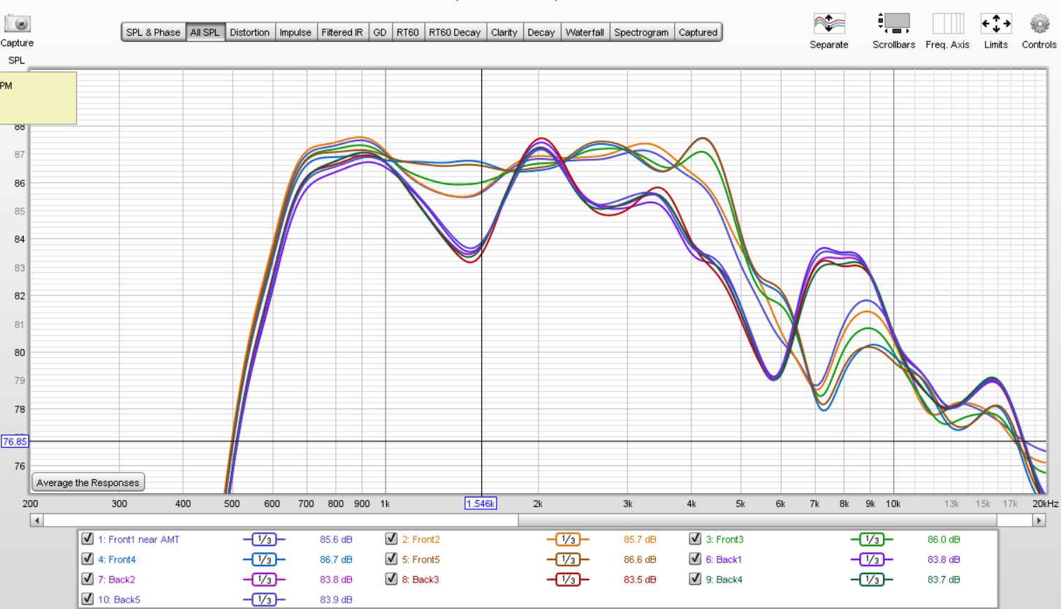

Hi Nelson,
I would like to get back on your offer... (though I could not send a PM, hence the public address). I recently found that one side of my (Heil) AMTs sounds quite different from the other side. One side (normally the back side) sounds more dull, the other side more bright & clear. Is there any explanation for this given its construction? One of my diaphragms was mounted wrongly I think, but changing the polarity does not fully fix its response. Only a flip does.

Fedde,
I think you are already on to the problem.
  • Check and compare the magnetic poles on your units, are the magnets oriented "the other way round" on one of them? (basically one could argue whether it's the magnet or the entire housing with the ESS logo that is turned 180 degrees)
  • Measure the impedance of your units, do they match? if some folds are stuck together then part of the conductor might be shunted out and the impedance will be lower.
  • Measure the acoustic response, and pay attention to the phase response, this must be identical (not just within 45 degrees) on the units or the polarities are wrong.
  • Even if the impedance is roughly the same approximately 3.8ohm +/- Check if any of the folds are stuck together - I have had this on nearly all mine, as the glue used is a type that does not dry out but stays sticky

Thanks for the good advice Norgaard. I did not consider the scenario that the magnets are oriented wrongly yet, but it looks they are. I have my left AMT currently flipped and in this configuration the magnetic poles are the same left-right! So you could conclude that the only thing that is wrong now is the location of the logo...
I also made some (somewhat rough) nearfield measurements, including EQ and crossover filter. I repeated them five times front side and back side. Distance is <0.5cm, center of AMT, USB mic Umik1 hold by hand. Take them with some salt, but you can clearly see a different spectral behavior between the sides...

I wanted to do a comparison measurement but I am on a different system so it does require quite some moving around, and I haven't found the time for that yet. - Sorry for the super slow response!
I do however not recall these dips from when I did a manual spinorama measurement on my OB's
Back reflections from the microphone holder ;-) is another thing to take into account. Did you spot any folds stuck together on the one (back)side of the membrane? The white grid in front of the membrane on either side is typically stuck in place also - which must have either a damping effect or potentially generating rubbing noises, not that I have been able to pinpoint any issues - yet....
Looking at the peaks between 7 and 9k the crossover does not work well at all as implemented. As the ESS is ruler flat on the impedance except for a very small curl at Fs, I would not expect to see such a poor stop band performance - only the ESS connected at the measurements?
