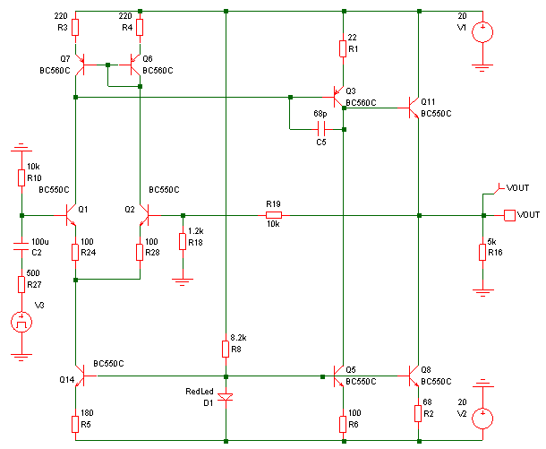

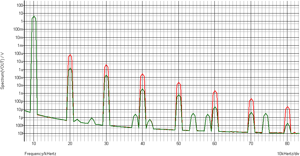

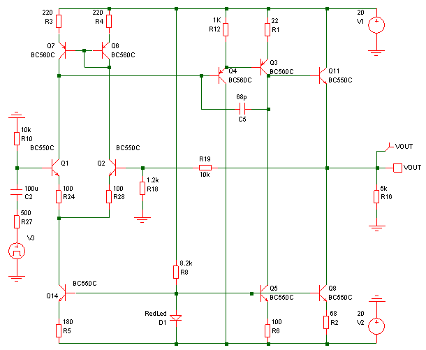

Is that an assumption or have you simulated or measured it in this circuit? You may be right, but it also changes other things such as the amount of feedback.
Only simulations but the results are well beyond the simulators
error margins.
The difference is quite large not to say of orders of magnitude
while the added complexity and cost is negligible.
