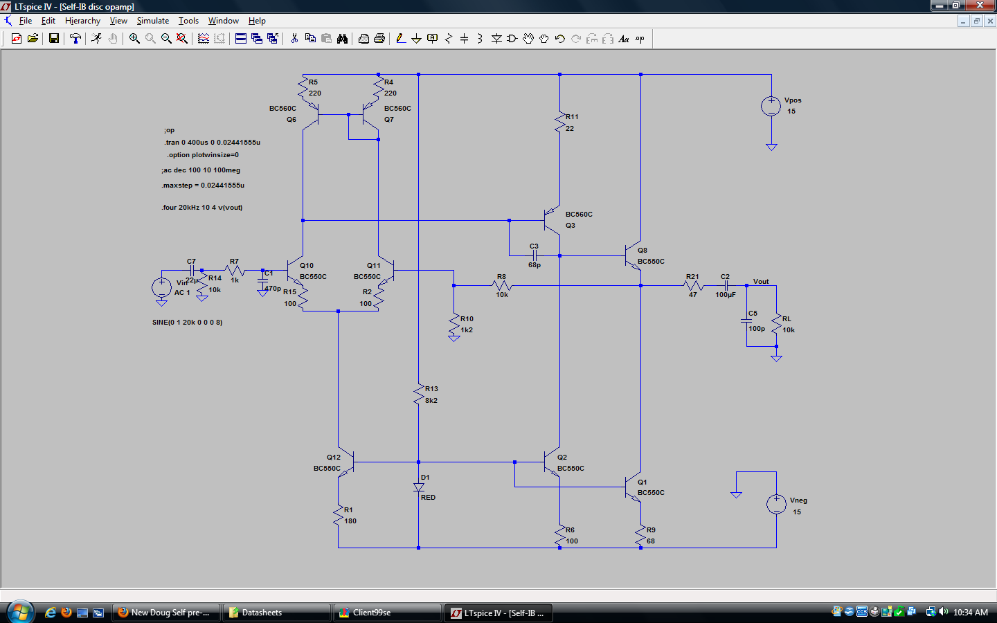

Would Mr Self object if I posted my simulation schematic here given the component values are different? IIRC he had the circuit free to view on his old website so maybe he won't mind. If he doesn't I will post it.
Post away.
But you're wrong about "darlington and cascode enhancements" they reduce distortion significantly. You won't convince me that the sound of non-linear Cbc is better than not having it.
Thank you Mr Self.
Here it is. Please bear in mind that although it might look sub-optimal in some ways from a purely objective analysis, this is what I ended up with after extended testing of various configurations and listening over long periods. There is a relay attenuator up front which expects to see 10k, hence the low input bias resistor. The output offset is high at 0.5V, but since the output is AC coupled and it sounded better without the feedback cap I left it at that, figuring the headroom loss was insignificant.
I never disputed the improvements in objective peformance that VAS enhancements bring, and who am I to argue with you two distinguished gentlemen anyway 🙂 All I said is that the VAS enhancements sounded worse (to me and in this particular circuit). Pointless arguing about that and I would not expect to convince you Mr Self!
I found the whole process very interesting, having expected that as the THD was improved by increasing gain in the VAS the sound quality would also improve, but this did not seem to be the case in practise. My methods were hardly scientific, but I was only doing it to suit my own ears after all...
The worsening of SQ mostly seemed to be an increase in midrange "forwardness" and "hardness" where eg strings took on a screechy quality. There are some nice audiophile adjectives for you 😉
I did carry out some distortion measurements on the circuit as shown using a friend's Cyril Bateman rig from his capacitor distortion articles. Just looked up the measurements and it seems at 1kHz I was getting:
@ 1V input and 1V output:
2nd harmonic: -110dB, 3rd harmonic -113dB
@ 1V input and 3V output:
2nd harmonic: -106dB, 3rd harmonic -122dB
Not too shabby. In theory the VAS enhancements should have lowered these even further but the levels should already have been inaudible. I thought the overall SQ was audibly worse though.

It's a pretty conventional Lin topology stage.
Do you think it sounds better than an audio targeted opamp like a 553x or a 4562?
It's clear tha you can probably get more drive out of it than an opamp, since there is no current limit, but at the levels you are talking about (1V out)I'd say this is hardly an issue.
Thank you for that astute observation, the thought had never occurred, hence why I mentioned it a couple of posts ago... 😉
In normal listening or A-B comparisons it sounds much better than the opamp preamps I've compared it to. I also did some single-blind testing of this cct against a single NE5534 configured with the same feedback arrangements and after careful listening to about 60 tracks found that I preferred the discrete circuit about 78% of the time.
My thoughts are that the devil is in the detail, however optimising this topology (or perhaps any) for THD and or noise alone looks nice on the spec sheet but doesn't necessarily equate to subjective improvement of SQ. Perhaps it comes down to the relative levels and distribution of the harmonics, though I guess if anyone really had the answers this would cease to be a topic of discussion and audio reviewers would have to go and get real jobs :cheeky:

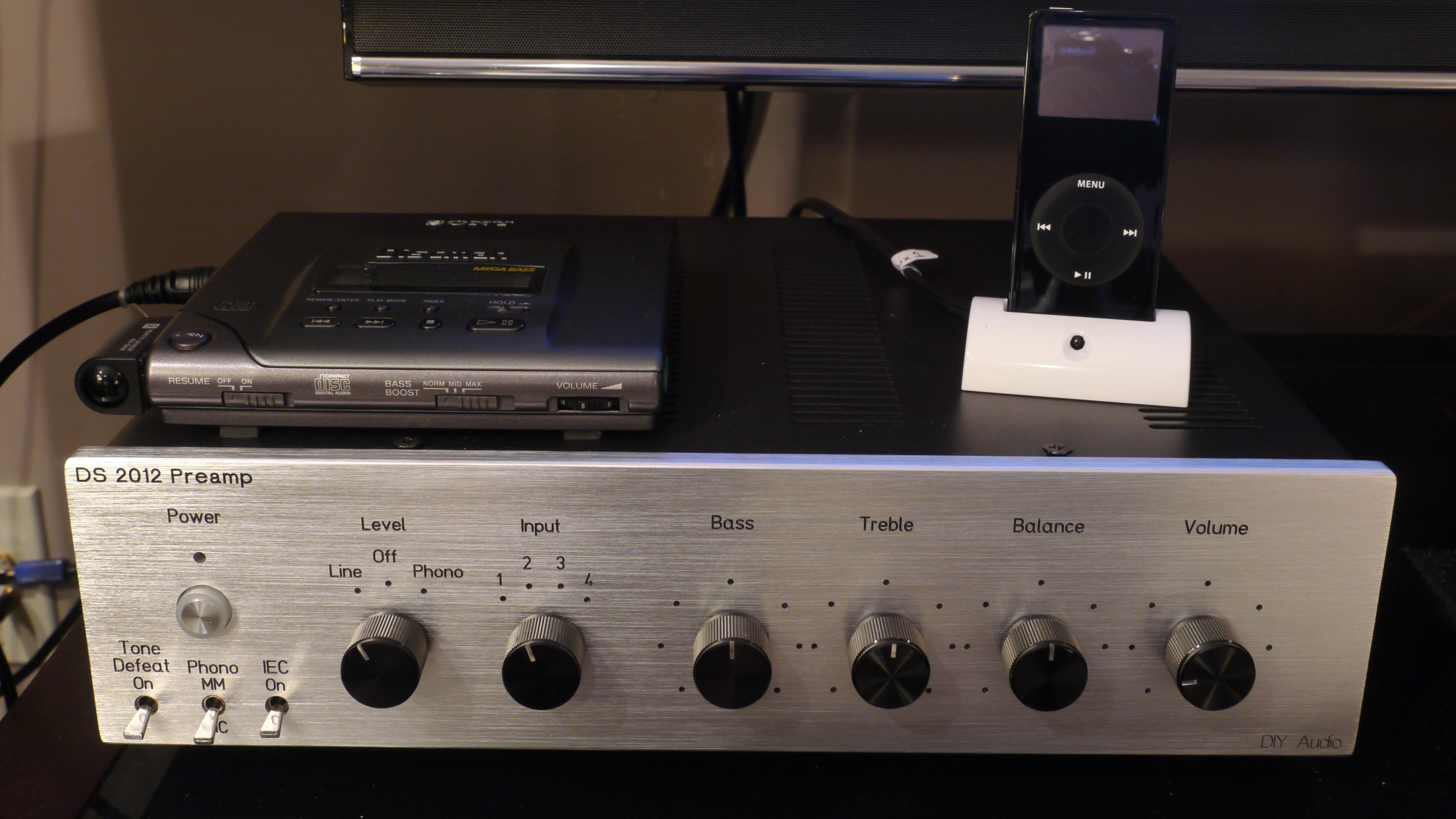

My Finished DS Preamp
Hi all,
Thought I'd post a pic of my finished 2012 Doug Self preamp. It sounds wonderful and is clearly the most expensive piece of gear in my modest system, and my most challenging DIY project of the year. But it was worth it! Thanks again Doug for an excellent sounding design and implementation.

redjr... very nice job 🙂
Thanks Mooly. It was a fun, time consuming, and at times frustrating project, but I never got deterred. This was my first time using Front Panel Express for the front and back panels, but they turned out great. Laying out the panels was very trial-n-error, until I got it right. A nice, well-laid out, machined, and lettered FP adds a very professional touch and look. A little expensive, but not bad in the big picture.
I'm very happy with it and the sound continues to amaze me. It's everything I had hoped it would be.

Hi Rick,
That's a VERY nice job!
Is that a Front Panel Express front panel?
Where did the enclosure come from?
Bob
I was looking at that front panel too... enclosures and panel work are always major issues (for me at least 🙂) and deter me from many a project.
I was just googling "Front Panel Express". I'd never heard of it before. For a "proper" project something like that is worth the expense for sure.
It is an excellent job.

Hi Bob,
Yes. FPE machined the front and back panels, but I sent them the blank ones that came with the enclosure. I did all the layout in FPE, plagiarizing from another member's (muskyhuntr) work where I could. It's a real trial-n-error process until you get it right. Unfortunately, my eBay supplier is not offering that exact same case anymore. Not sure if he'll have them in the future or not. As it turned out, the case worked, but was a little smaller than I would have liked. Layout was cramped inside, but I did make everything fit. I don't appear to be getting any induction, or ground loop hum, but all signal wiring is shielded. I've attached a picture of the final inside, sans the FP.
Rick

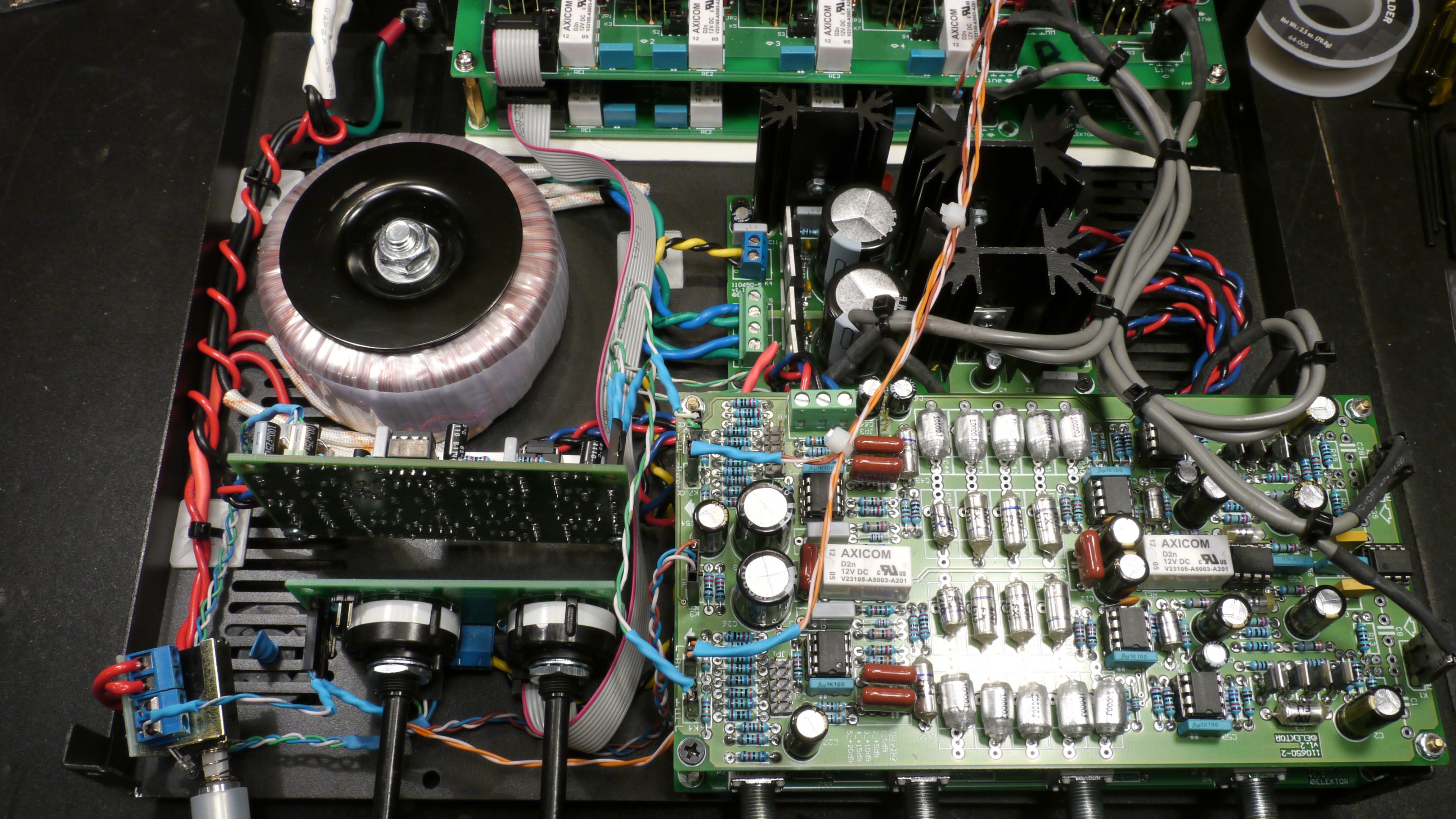

Hi Mooly,
I think getting just the right chassis, or enclosure for a project is critical to its success - for me anyway. This was the first 'advanced' project I've ever tackled, so it was good to know the FPE was available for the mechnical and final fit-n-finish part of the project. I don't have a drill press yet, but it's on my list of bench tools that is a must have for projects like this. FPE offers a nice service, and free software that gets the layout job done. All you have to do is upload your files, supply the material (not necessary), and in about 2 weeks you'll receive a nice package from UPS. The total machining and lettering cost me about $160USD.
