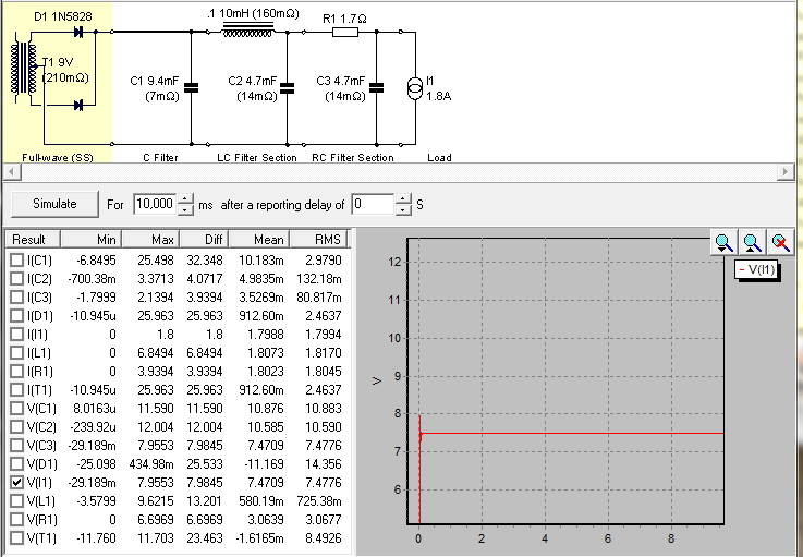

Hi Randy,
If you are using a power conditioner, I would hope that common-mode noise will be rejected better than before.
The Coleman Regulator does not usually need extra (differential-mode) ripple-rejection, so CLC will not make much difference, except maybe on very low level stages in phono amps.
However, a plain LC filter has scope to improve the system overall, not due to any effect on the filament supply, but because the choke-input will calm down the peak recharge-pulse currents into the rectifier's capacitor. High recharge pulses can pollute the local mains, if the local network impedance is unfavourable (makes little difference for me, but will be supply dependent).
In practice, a CLC made up of (eg) 10uF MKP at the rectifier, a choke of 10mH, 160mOhm, 5A (Hammond 159ZJ) and 10000uF/35V will be very quiet, and take the recharge current right down.
PSUD2 must be used to design the raw supply, and choose the right transformer.
I usually have some example PSUD2 files for choke-input supplies, if you need them.
I don't think that any of this amounts to major effects - but some folks like to build things the absolute best way possible, and if this is you, a choke-input raw supply is worth a look.
Here is the simulation I did in PSUD for a 45.
But, to complicate things, I would like to be able to use either 300b or 45's in the same amp.
I think if I change R1 to 1 ohm, should give around 10v at the 300b load.
BTW, I would rather "overdesign" and not have to worry that I could make it better by adding a LC later.
Hi Randy,
For choke-input version please try C1=10uF, rather than 10mF in the PSUD2. The transformer voltage will need to be increased to about 12V, but with only about 2.5A rms capacity.
Comparing the peak currents in (eg IT1 or ID1) will show the potential for what choke-input can offer.
