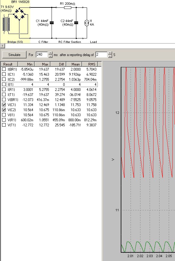

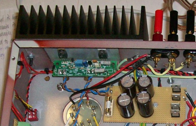

I thought I'd post this here instead of emailing as it might benefit some readers. I've got a couple of queries on the boards I'm using with sv572/sv811. I changed my original RS 2x9v 100va frame to a toroid as it was buzzing loudly. I changed to an airlink toroid 2x9v 120va. This allows best part of 9v@7A for each regulator.
It gets very hot, 60+celcius(by my rough dmm thermometer). As the transformer for sv572 was not mentioned in the app. notes I was kind of working in the dark, but correspondence with Rod enlightened somewhat. It seems I need 3 times the end current at the transformer to start with. In my case thats 12amps, for a 4 amp sv572. I hope I'm understanding this correctly. I'm currently looking at a 2x9v frame 200va.
Notwithstanding the transformer issue the results are superb as I've lost most of the noise from the amp. But.... the barrier diodes, MBR1045, are getting really toasty, 105celcius(by the same dmm as mentioned before). I don't have any experience with these so I'm wondering if anybody can offer thoughts. I'm not sure if this temp is ok, or whether I need sinks on the diodes or whether I should move to an external sink to get the heat out of the inside of the chassis. At the moment I do fear for the health of the adjacent caps.

Hi Ed,
We can look at a PSUD2 session to analyse the current.
The dc current of 4A translates into an rms current of about 8A in the secondary winding - hence the recommendation to use 9V 12A: it is best not to run a trafo at 100% full load for hours of listening time!
Best buy for UK DIYers is the JMS 150VA trafo, configured with 9V secondary, 240V primary:
150 VA
This should run quite cool.
The rms current in each diode is about 5.7A, so heatsinking may well be needed at this high level, or you could try MBR1645 for lower drop. Beware that the TO220 package tabs are not isolated -please use a Mica insulator and grease.
I am pleased that you like the sound!

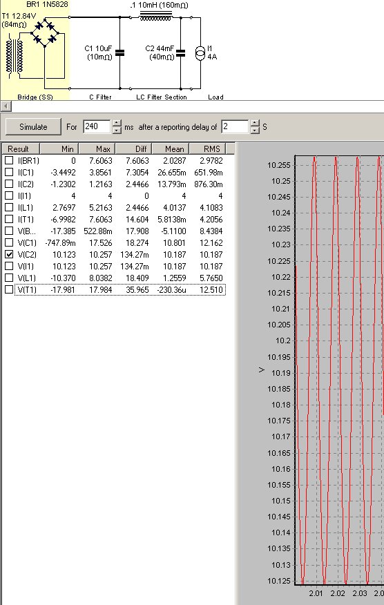

A much better supply can be made with a choke-input arrangement.
The transformer is 12V 6A trafo (eg Hammond 266M24) and a 10mH 5A choke e.g. Hammond 159ZJ.
The rectifier diode current drops below 3A, and the pulse-current drawn from the supply are much lower, meaning less chance of EM-coupling to other wires or trafos.

Hi Rod,
I'm considering how to update my TRAM with your regs. I use 2A3s. I could do choke input similar to the above if I use a 2nd chassis attached under the TRAM. heatsinking will then be easy to organise. The trafo and diodes will need to be different. Have you spec'ed anything similar previously?
