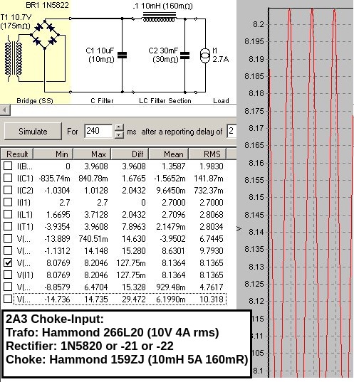

Hi Clive,
I recommend short wiring from trafo-rectifiers-caps, because long wires (which carry the heavy pulse currents) will risk coupling to the signal wiring.
If you buy a 7,5V rms trafo, you can use the standard CRC raw dc circuit - this is given in detail in the application notes (please click my name -> send email for the PDF documents).
Alternatively, a choke input circuit can be formed from a 10V 4A trafo (from JMS, or a Hammond 266L20 -- and a Hammond 159ZJ choke. this would be a kind of Rolls-Royce of a raw dc supply.

I'll measure up how close I can get the heater outputs to the 2A3 sockets, my initial estimate is that I should be able to arrange things so the heater wire to the valves are about 50mm to 60mm, it this ok? The trafo wiring can be really short, far shorter than it would be if it used the TRAM trafo.
If I go this more expensive route, I would I hope derive benefits from the choke input PS and by reducing the load on the TRAM trafo. Given that a DHT preamp is a very sensitive beast I'd hope any improvement would be audible. Of course I'd never know as I can't do a side-by-side comparison. If the improvement is likely to be debatable then I might as well stick with a single chassis which would look more attractive - overall sound quality is the more important factor.
Hi Clive, provided the filament wiring avoids running too close to power transformers, the length can be 200mm. The only risk is picking up common-mode EM radiation, so in quiet locations, it can be longer still. The Regulator stability (with the rev 4 design) is completely independent of cable length.
Use fairly heavy cable, and twist lightly.
It's hard to predict whether the choke input will improve the preamp - the difference will not be on account of the filament supply, so much as the improvement in the B+ supply, where the filament rectifier recharge pulses will no longer be coupled into the trafo, and indirectly into the signal wiring. And you are right, a DHT amplifier in a high resolution system can highlight almost any improvement!
