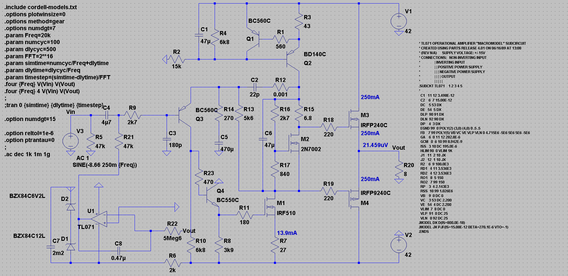

Dear Mooly!

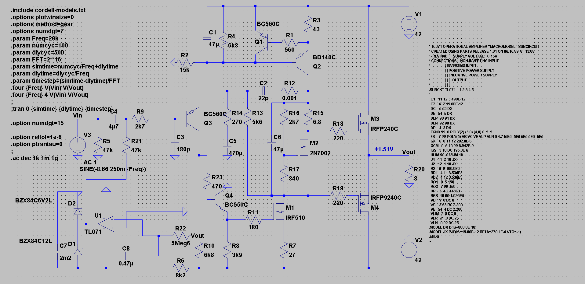

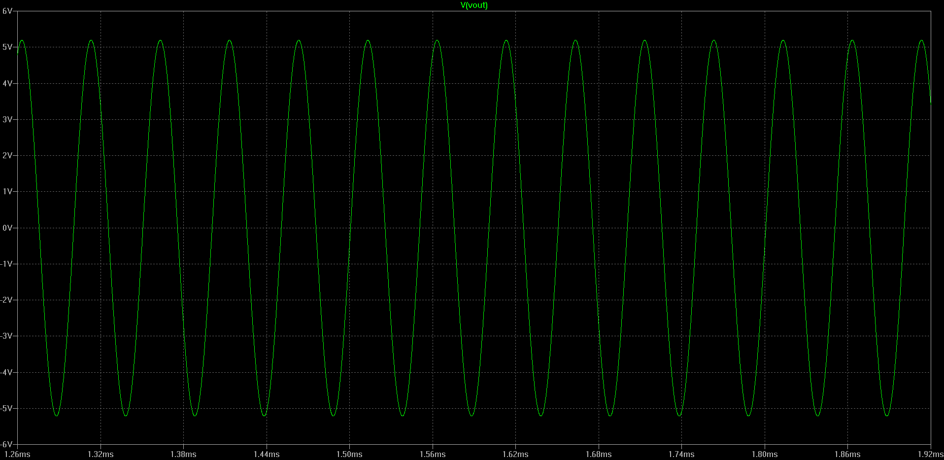

I decided to build this amp but I cannot set oVDC at the output, with right schematic I got +1.5V at Vout, which component should be changed?
attached sch and asc file,

Interesting to see a sim of it. You need to drop the value of R6 to 2k in the sim. The TL071 model draws more current than a real device and its pulling the zener regulated supply down.
Edit... also make C7 a 1uf for the sim transient to run.
thank you very much, now it works🙂
attached files for interested

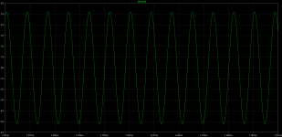

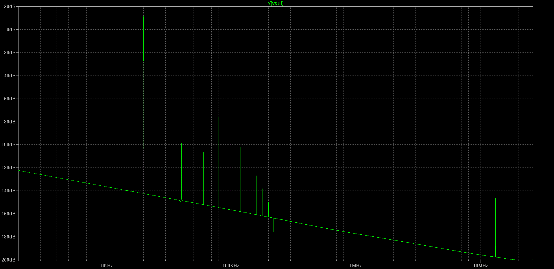

N-Period=1
Fourier components of V(vout)
DC component:-0.00467607
Harmonic Frequency Fourier Normalized Phase Normalized
Number [Hz] Component Component [degree] Phase [deg]
1 2.000e+04 5.207e+00 1.000e+00 -4.75° 0.00°
2 4.000e+04 4.686e-03 9.000e-04 99.27° 104.02°
3 6.000e+04 1.380e-03 2.650e-04 8.03° 12.78°
4 8.000e+04 2.144e-04 4.118e-05 -82.93° -78.18°
5 1.000e+05 4.898e-05 9.408e-06 -172.27° -167.52°
6 1.200e+05 1.079e-05 2.073e-06 97.52° 102.27°
7 1.400e+05 2.603e-06 5.000e-07 7.72° 12.47°
8 1.600e+05 6.333e-07 1.216e-07 -81.24° -76.49°
9 1.800e+05 1.434e-07 2.754e-08 -175.10° -170.35°
Total Harmonic Distortion: 0.093919%
Thanks for posting the sim and pictures 🙂 Just under 0.1% isn't to bad at all on the face of it.

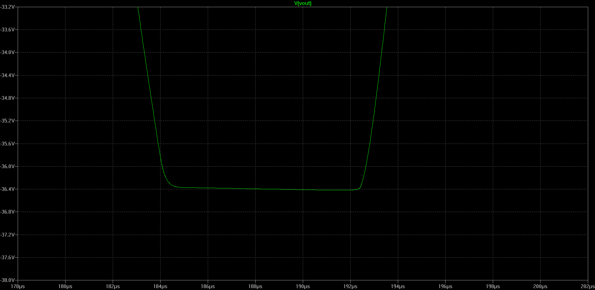

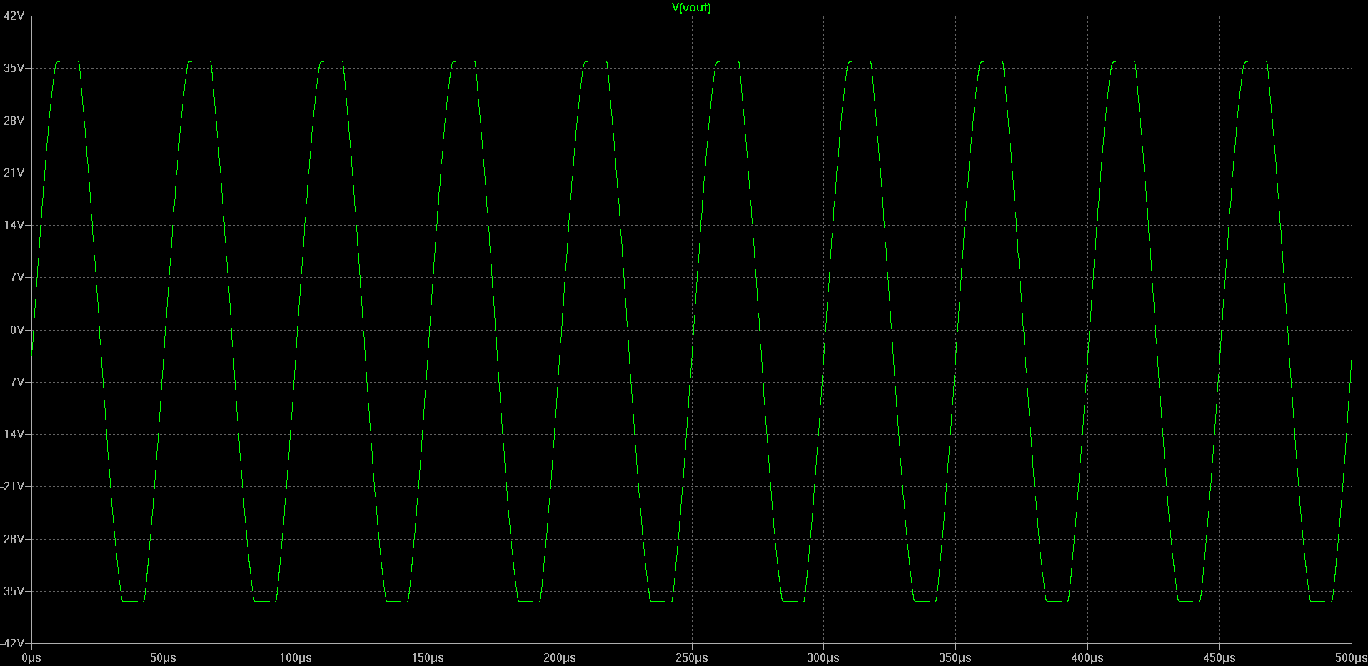

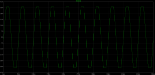

in meantime clipping show:

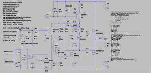

Here you go. The files are "as is" with the servo over ridden by the DC offset programmed into the input voltage source and the feedback return cap replaced with a voltage source.
I'm not sure what state all the other files were left in but they should be essentially ready to roll 😀
Open circuiting the resistor marked "FB Set" will make it run without global feedback.

Hmm....the Mooly Amp, but on steroids, lots of LATFET steroids.![]()
Thanks, its something like that 😀 I have an AC coupled version too, which includes an experiment into "current drive" (where the output voltage depends on varying load impedance).

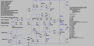

This one includes a SS output relay and rapid forced charge of the coupling cap to ensure totally silent switch on/off.

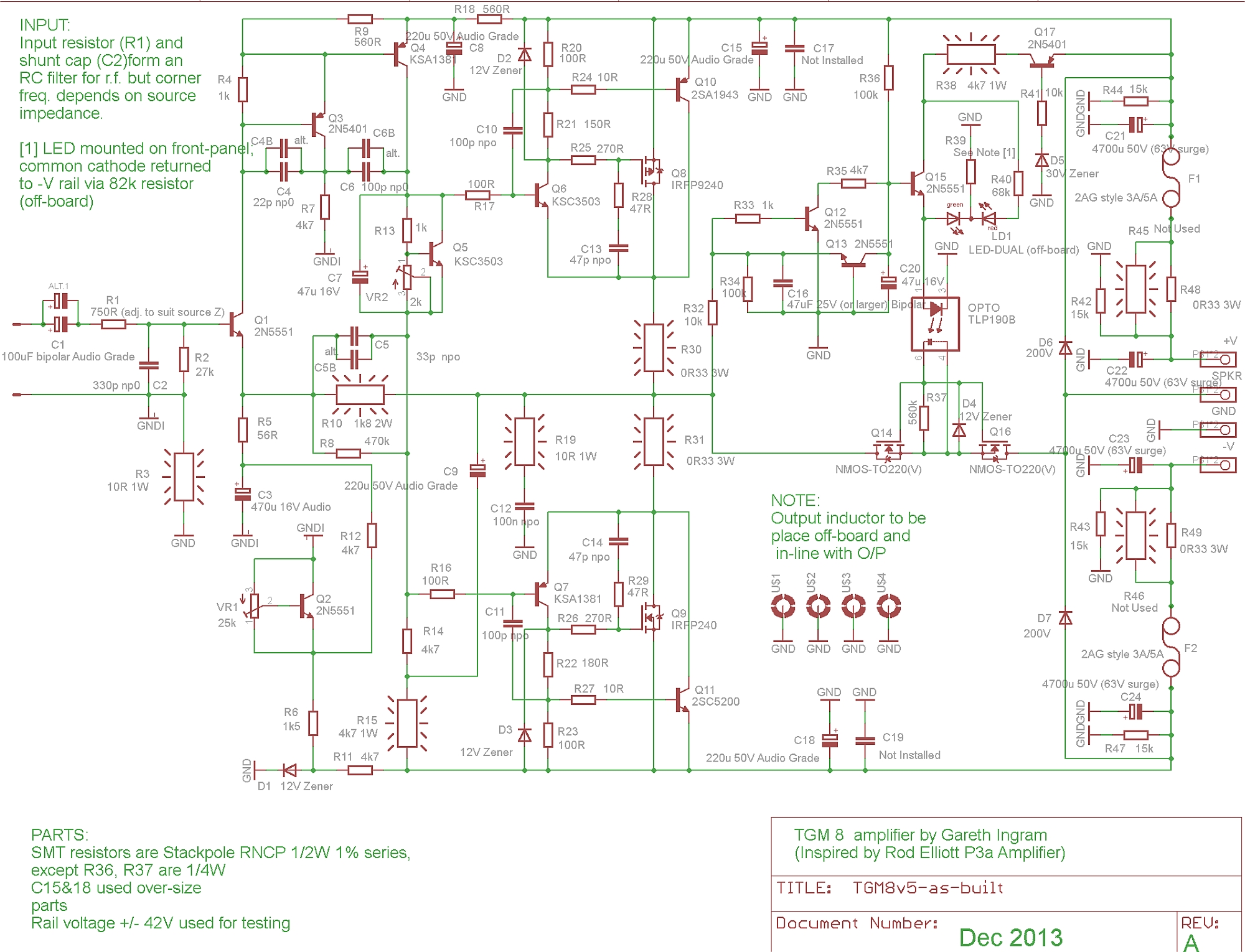

This is getting closer to my TGM8 amplifier. Both have singleton input and buffered VAS (although I used the buffer to bootstrap the singleton for higher input gain). Both have a VFET to provide 'low angle assist' and both have solid state relay on the output. However, instead of LatFET I used BJT output and I used CFP output - you don't have CFP but still your topology is close to CFP. I can tell you the sound is very good 🙂
You could almost take the TGM8 and use a LatFET in place of the BJT output and you'd be almost there.

I became a convert to the singleton input and latfet outout with my now somewhat ancient original design, but as you say, they sound wonderful.

This is quite different to mainstream thinking - and design obviously - to anything I've seen here. I won't ask what you've been eating for breakfast lately but I'm interested in the why and how you arrived at the section "speaker" including the pulsed charging voltage.😉.....This one includes a SS output relay and rapid forced charge of the coupling cap to ensure totally silent switch on/off.
The VAS is also "something else". Is U1 developing a protection/disabling voltage for it? Would you care to walk us through it some time? 😕🙂
Thanks for the interest Ian... remember its just a concept/ideas at the moment rather than a fully worked design.
The quick charge for the speaker coupling cap is just a way to use a single FET to connect a 10 ohm (R28) to ground for a predetermined period at switch on to rapidly charge the cap. During this time the SS speaker relay is off (open). When the speaker relay closes the "charge FET" would be turned off. The diode bridge allows use of a single polarity FET to achieve the switching. A single FET on its own wouldn't be suitable due to the "built in" diode across D-S.
The opamp is just an experimental idea, nothing more at this stage, and works by modulating the VAS stage allowing some approximation to current drive. As the load impedance rises, the amplifiers output voltage rise too.
