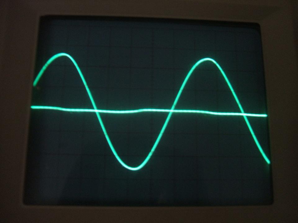

Your results look promising, and certainly show the error correction at work. I will try with real speakers as a test load as well, not the B&W's but a pair of Celestion SL100 I still have.
The loss I measured at 16 volts output was around 0.67 dB but this loss varies a bit with absolute level. I must do some more critical measurements when a PCB is done as there are at the moment high resistive losses in the wiring to the outputs.
Going back to Bobs work again, to be honest I really wanted to try the simple approach. To see if there was any major subjective difference in audio quality with the outputs running "free standing" so to speak.

I can't say what sonic differences there may be in using them without EC. I focused on the distorted waveforms and decided it looked terrible. However, I was trying to create an amp with very little distortion so I didn't go any further down that road with any listening tests. Lately I have constructed a follower circuit, a "black box", so to say. It includes a Vbe multiplier and EC. The Vbe multiplier is a separate section so the error amplifiers can be physically located near their related circuit components instead of way out on the heat sink as Bob did. If this circuit was connected to the VAS, the VAS would become the CCS and input bias instead of the way it is now. It's set up to be driven by my function generator at 0VDC. My goal is to eliminate nfb around the "black box" circuit.

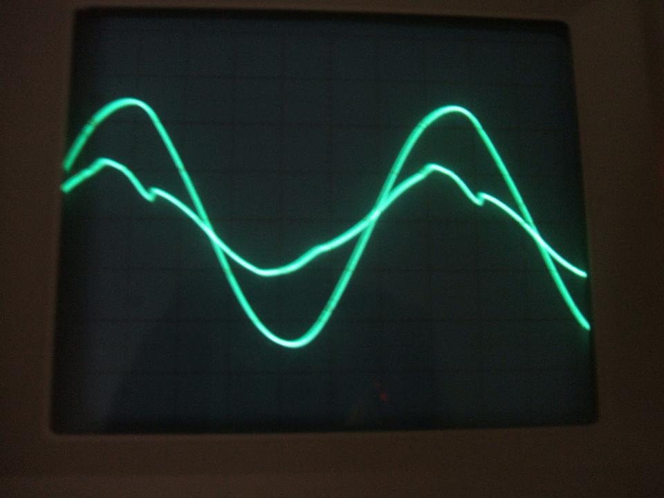

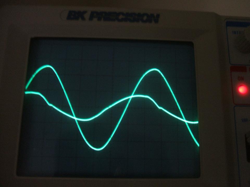

To demonstrate that the gate drive becomes a function of output impedance I measured the output vs the error signal for different load conditions. This was done using an input signal transformer to isolate the function generator from the circuit, grounded the scope reference to the output node, measured circuit GND with ch 1, and ch 2 connected to node A in the circuit, then inverted ch 2 so the phase is correctly oriented to the output.
This first picture is with no load. Frequency is 30KHz.
Output is 12V, 5V/div
error signa is 1V/div
As you can see here at 200KHz with higher frequency the error becomes larger as more drive is needed for the faster change in state. Now you can get an idea of what the error might be like driving a real speaker that exibits different impeadances with different frequencies.
These errors will be included in the output if EC is not employed, this is why I decided to use EC instead of straight hexfet followers. Each stage should be as linear in operation as possible, IMHO, but to each his own.🙂

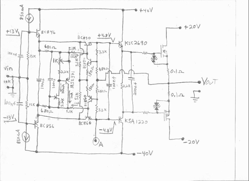

I have built 3 disco/guitar amps using vertical MOSFET's.
100W, 300W and 500WRMS using various pairs of MOSFETs on the output. I use 3 pairs on the 500WRMS amp.
I dont set an exact current through the output resistors but use a scope to tune out the crossover distortion. This results in less standing current.
I just used a bipolar transistors bias cct and this seems to work fine. I tend to over heatsink and dual fan the heatsinks so temperature is not usually a problem

I dont use matched MOSFETs.
I use 0R22 source resistors.
I have measured the voltage across them and it does vary quite a bit.
I use IRFP240/9240.

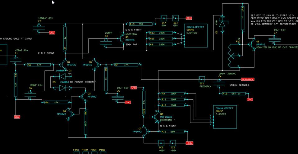

Mooly said:So here it is, very much work in progress, but with a few actual shots to show what really happens.
What I really want to know ? Anyone --- how does taking the outputs out of the loop affect sonics.
Each to their own, but running the output stage out of the loop without class A bias will give you an awfull lot of crossover (nasty high order) distortion with these devices. Full amplitude distortion may be in the vicinity of 0.5-1%, worse with decreasing amplitude.
