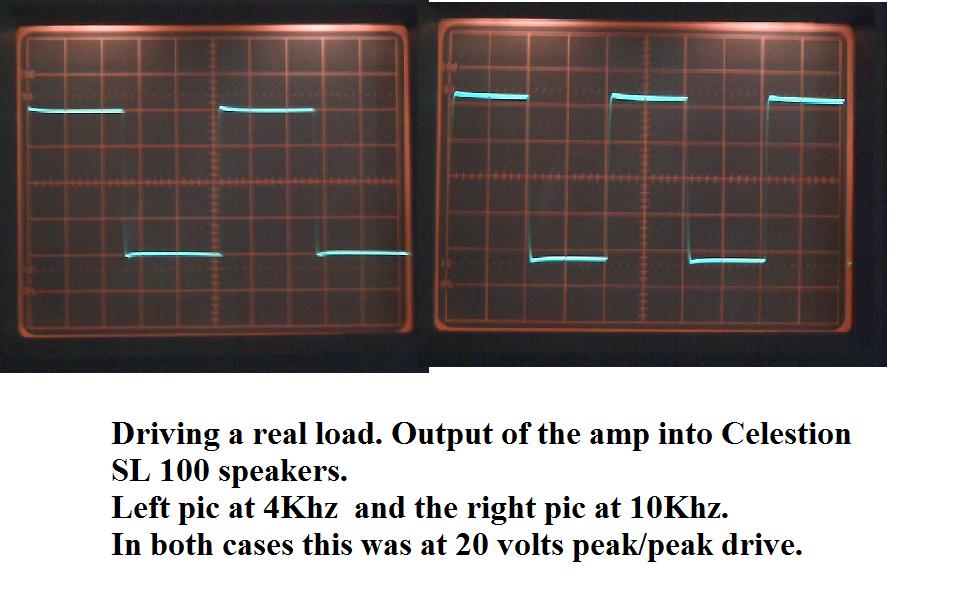

Mooly said:Driving a real speaker at 4 and 10 Khz.
for being such HIGH VOLTAGE output = +- 20 Volt peak
those are close to perfect squarewaves.
There is no overshooting. No ringing.
The square also show that this amplifier is quite FAST.
= good and high bandwidth
(Because we can see a slight rise in upper left corner. Even on the 10 kHz)
Congratulations 😎

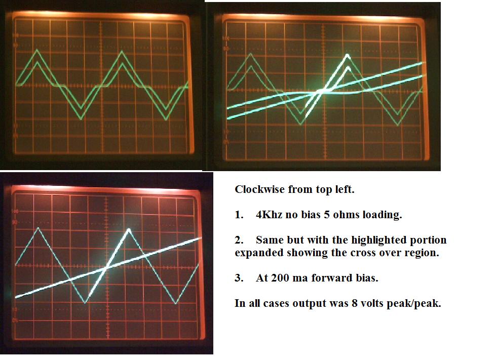

Class AB without feedback by voltage?
Unbelievable!
🙂 Mooly & Wavebourn
That crossover distortion Shot
and by biasing 200 mA in IRF240 / IRF9240 output stage
remove the same.
Great 🙂 And very instructive.
This is also very much according to what we know about HEXFET.
They need a bit higher Idle Bias than bjt.
200 mA is a figure I have seen in several other MOSFET AB Power Amplifiers.

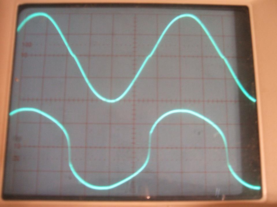

G.Kleinschmidt said:Each to their own, but running the output stage out of the loop without class A bias will give you an awfull lot of crossover (nasty high order) distortion with these devices. Full amplitude distortion may be in the vicinity of 0.5-1%, worse with decreasing amplitude.

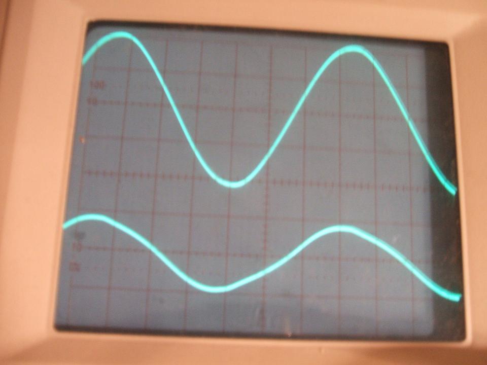

This picture shows the output at 10Vp @ 30KHz across 5 Ohms resistive and the error (1V/div) when the output fets are under bias in class B and have lots of crossover distortion. The slope of the error signal at crossover indicates the very high frequencies needed to correct this enormous error. As fast as the error amplifiers are, they still cannot correct for all of the crossover as it is still visible. (Vgs Th for the fets is 3.8V and here Vgs is 3.2V.) Without the EC the crossover notch would be much more pronounced.

Higher bias is needed for the reason Bob explains in his paper. However, even with bias there will be some bit of crossover that will have to be dealt with via GNF or EC. In this picture, the same conditions exist as above but with 300mA of bias. You can still see a slight variation in the slope of the error signal at crossover. This indicates that even with 300mA of bias you still cannot get rid of it all without correction....or class A bias.

This is one reason why Nelson Pass drives his HEXFET in Class A
or at least at very high idle currents.
Look at his Pass Alephs amplifiers 😎
They simple like more idle currents, those IRF mosfets.
How much is up to you.
The level of feedback used is one important factor.
Will correct crossover distortion a bit.

By using a local feedback loop, the distortion seen by the GNF loop from that stage is much less. It is best to have the global feedback loop "correcting" as little distortion as possible, just like you want each stage of the amplifier to work as little as possible to drive the next stage. Therefore each stage within the loop must be as linear as possible. Relying on the global feedback to correct all ills is the reason why some people criticize fb, unjustly IMHO.

Lineup - if you look at the shots driving the speaker there is a slight rise in amplitude at 10Khz caused I think by the impedance of the speaker increasing. The relatively high output resistance of the FET's highlighting the effect. In absolute terms ( in db ) the effect is tiny.
