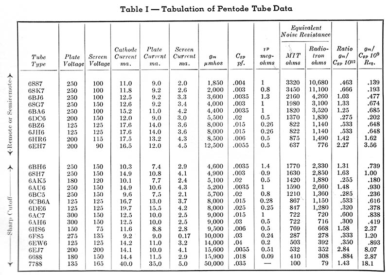

I found this list of equivalent input resistance for some tubes on the Web. Look 1/2 way down the page to the post by Alan Douglas.
Antique Radio Forums • View topic - Vacuum Tube noise figure
6JC6A is quite similar to these tubes below, and costs $1 on the ESRC Dollar Days list:
6688/E180F (R = 330 Ohm)
6EJ7/EF184 (R = 352 Ohm)
6JK6 ( R = 282 Ohm).
12HG7, 12GN7, 12HL7 are cheap 10 Watt frame grid pentode tubes, $3 to $6.
12HG7 (R = 148 Ohm ) is just beating D3a at R = 150 Ohm.
And then there are 5 Watt pentodes on the $1 list, with 20K+ gm frame grids and a spare triode:
6LQ8
6LY8
6KR8
6KV8
Just so happen to have the article mentioned:
These measurements are reliable. Radioamateurs from the 60`s used tube receivers in which signal/noise ratio was crucial, especially for low band DXing.
I think that they are "calculations" not measurements.
one has to get a bunch of samples and measure as Scott did in his article.
