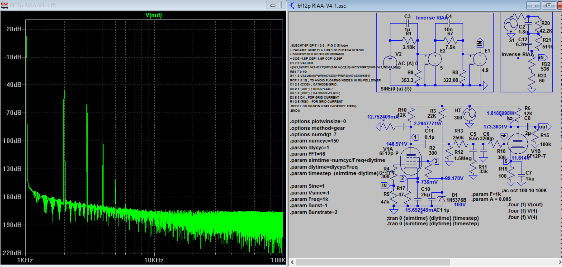

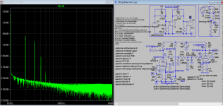

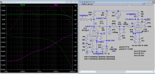

Some say you can use 6f12p instead of DA3. I just almost completed sim with 2 models, one painted myself and one from the net. The overall gain is 1700X or 17dbs, cathode fully bypassed. Here are the models, if you're interested to sim futher and share the result noise level etc, I can upload the source asc. I have clean up floor noise in FFT sim result as attached.
