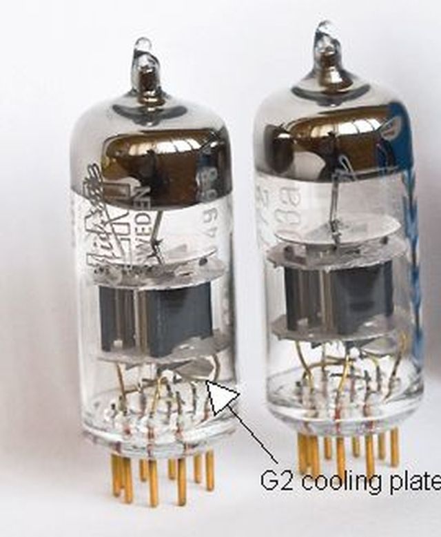

Uhm, what is the big deal about the D3A? Do people actually enjoy the dark sound it produces as triode? Dark in comparison to E280F, E180F, C3g.
Does people really enjoy the dark sound it produces as a triode?
Dark in comparison with C3g.
Yes, mostly.
But LM Ericson D3a is different. This tube does not sound dark.
I think it is because of a somewhat different interior design with a visible small plate that looks like a G2 "cooler".
Yes, mostly.

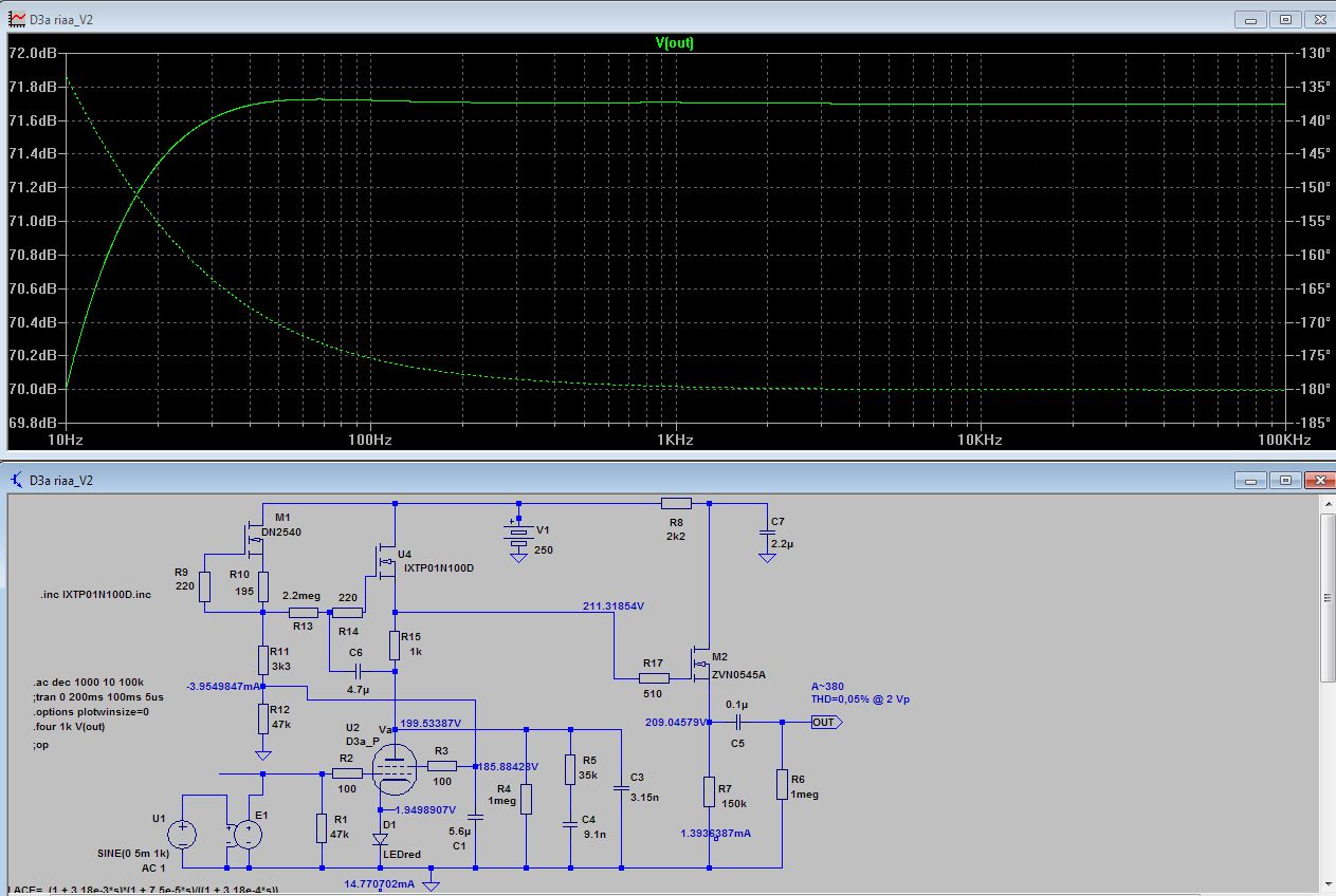

I am very attracted to D3a as a pentoda in one tube riaa preamp.
I did not try it, just simulated and looks very good.
I used Bartola idea for pentode driver in general. I switched it to RIAA preamp.
Yes, pentode works a lot like cascoded triodes. 😉
for D3a, Cag1 in pentode is something like 0.035pF while in triode it is quoted at 2.7pF - this results in a huge difference for miller capacitance. Will the RIAA network in your design increase miller capacitance? I don't think so..

Useful tips, thank you very much Kevin
I've just taken them into my scheme.
I very much liked the idea of Ale Moglia for pentode driver and I immediately got the idea for implementation in the RIAA preamp.
PS. Ian,
I switched to 10 Mohm. 69dB gain (or 1,5Vpeak).
Say if you need a .asc
PS. Ian,
