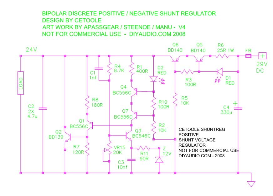

R6 has about 1V across it. Why the need to specify 1W when dissipation is ~50mW?
R5 has been discussed at length. Change it!!!!

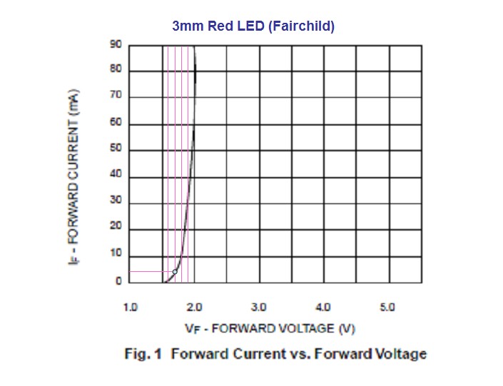

I have no idea about the actual relation between the forward current and the forward voltage of the red LED. Do you have any? Please give it to me. Then, I could choose proper R6 and R5 myself.

My bad, i just send a schematic that was lying on the table
I forgot about R5 that was changed to 10k. The latest changes to the Toolreg took place in the GB thread, and it seems that You (that is JH You😉 ) Didnt follow that particular thread. Here is a link to the thread, it might be worth reading through it: Toolereg GB
Regarding R6 I suggest a somewhat higher value. Around 25-27r is probably as good as any, allowing for some excess current flowing through the shunt. The final value should optimally be as low, as your heatsinking of Q2 allows for.

your red LEDs are likely to drop 1.5V to 1.6V at the normal 2mA to 5mA that is commonly used.

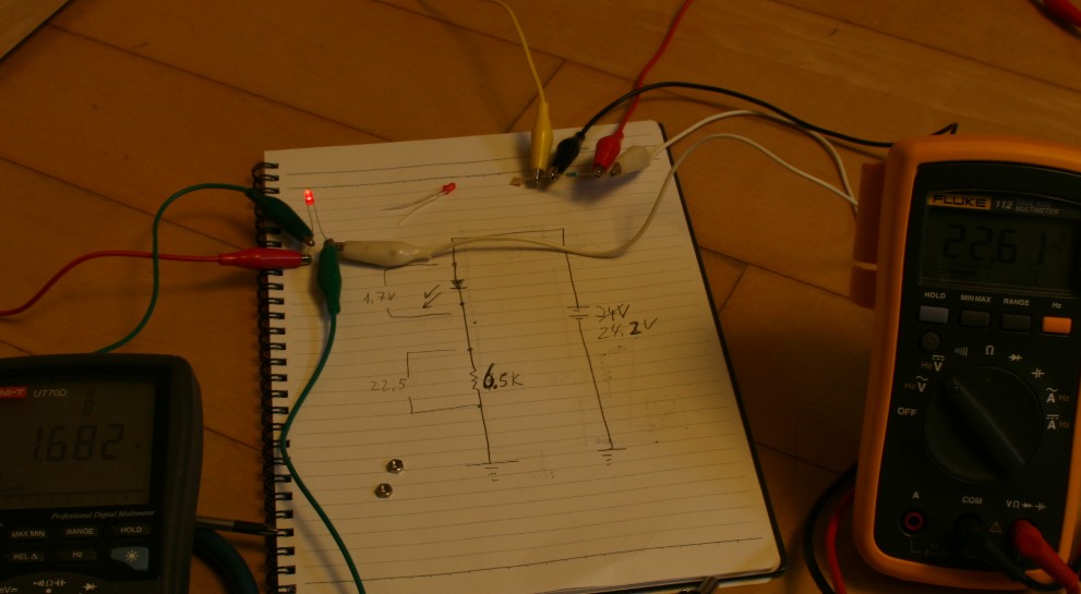

I had a simple test with two red LEDs. According to the test, the red LED met about 1.7V drop on about 3.5mA current. I will go with this 3.5mA for my test of TooleReg . . .
Hairr-Babo,
very few LED datasheets show an accurate If/Vf graph in the 0-10mA range. (e.g. a high efficiency 5mm LTL-307)
A LED still is a semiconductor, measuring the range yourself is the only way to find out.

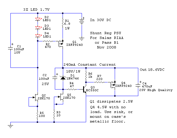

Stuff like J309 or BF245 are pretty cheap, considered a 3-piece J-CCSuit ?

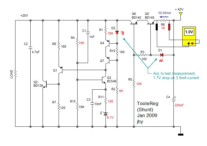

By the way, any one measured voltage across R8 of Toolereg?
Do you have any figure? Thanks.
One day, I will give it a try.
Babowana said:voltage across R8 of Toolereg
Mr Samson You still needs to grow a few more hairs.
=> Vbe of Q2, R7, R8.

Thanks to your and friends' advices, I sum up my toolereg as shown, hoping this will work fine. The unregulated input voltage of +42V and red-marked resistors are considered because I want to utilize things in my pockets. Any further advice?

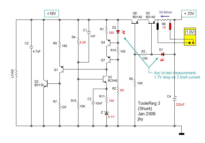

I have a smaller secondary transformer 2x12Vac (50VA).
Retouching the values . . .
That should work just fine. What do you have in mind for the raw supply? If you do a CRC, a volt or two could be dropped there, cleaning up the supply a bit at the same time.
