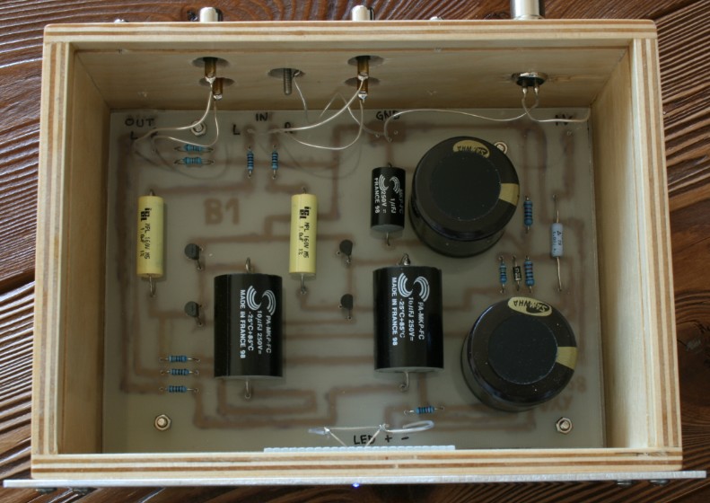

Here is a close-up view of my baby B1.
I made exactly the same PCB as shown in the post #1, but the size was adjusted to a bit smaller dimension, 170mmX120mm, fit for the box.
Two fat electrolytic caps are Korean made, Samhwa. One black film cap of 1uF is parallel with one of the two fat caps. Two black film caps of 10uF are output-coupling caps. Two yellow film caps of 1uF are input-coupling caps (Icel of 1% tolerance). I got these film caps from my old diy-projects
All resistors are Korean made, except Panasonic 1-ohm-2W resistor just behind the +19V inlet.
By the way, you might wonder with . . . You see?
The input and output RCA connections have (+) wires only. Where are the (ground) connections?

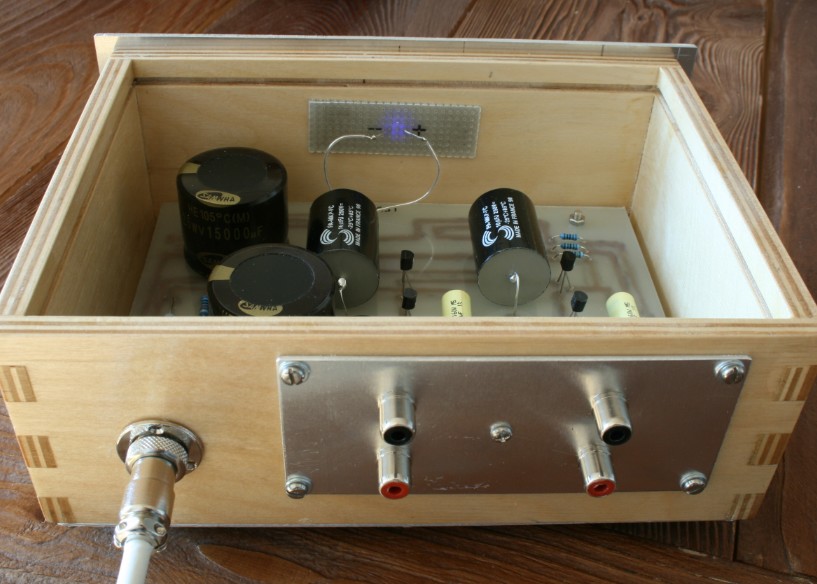

Babowana said:..... Where are the (ground) connections?
ya have backplate , grounding them all
Here is back side (or rear side) view . . . which English is correct . . . ?
The aluminium (or aluminum) back plate is a common ground for the all RCA connectors. And, the center of the plate having the same distance to each PCA connector is connected to the GND point of the PCB.
Either one is fine.
Seasons Greetings,
Very attractive build, Babowana.
Babowana,
Thank you for the additional photos.
I have researched the PCB method you used, very smart for one-off use, simple, draw the circuit, etch the board.
Very nice looking unit.
John
John

Some tips from personal experience on this PCB method. Clean the board well ..Do not use a scotch pad or the like but rather use a methylated degreaser ... no fingerprints allowed. I've had fair results with "Sharpies" but better for this are oil based paint markers . I bought UNI-PAINT Markers $2-$3 on line. I also bought a dispenser of liquid flux $7 from Mouser to coat the traces
after etching so that a coat of solder would flow their course. I still use P2P ( I find it relaxing) and will post some Pics of my F5 boards if I can figure out how to post pictures on the forum. I'm envious of the beautiful artwork and resultant boards . Babo's boards are'nt as pretty but they WORK ...in the end that's what this is all about!!
PS. Use new board material rather than old oxidized stuff. Keep it from the air untill you are prepared to use it, clean it and go to work. Good Luck!!

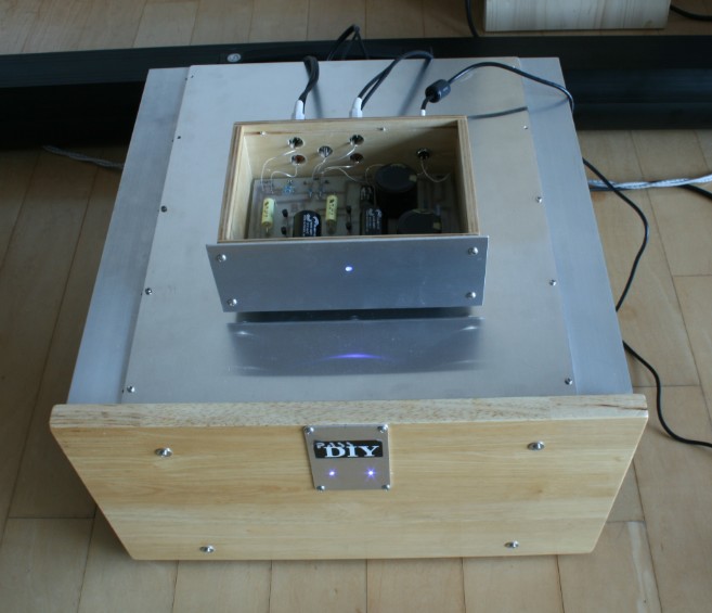

I think that B1 is a really really good pre for me to fully enjoy the first watt music together with F5 and with my 85dB speakers (ATC SCM7).

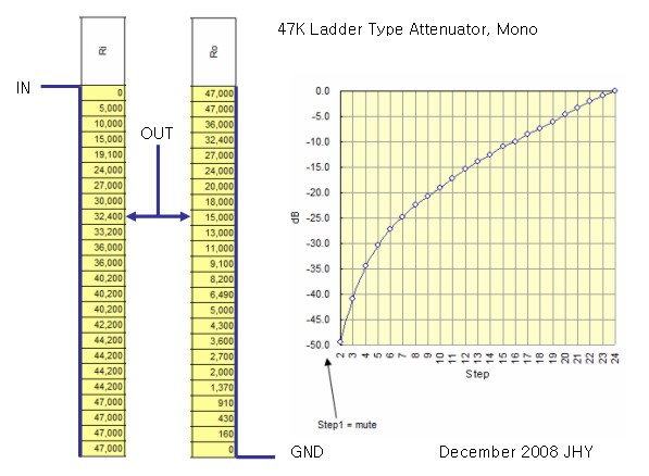

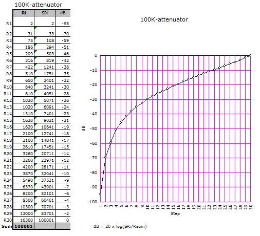

For the time being I'm using 100K 30-step stereo log attenuator (series type) for the volume control.
BTW, our living room has asymmetric shape so that the volumes between the left and right speakers are also a bit asymmetric. So, I have to move my music listening positions here and there. This is not very convinient. Mmm . . . I need to consider a new volume control -- e.g. two mono 47K log attenuators (ladder type). And, if I give these to B1, it must be that I could have a possibility of adjusting the left and right volumes independantly at the fixed listening position, then without moving my heavy aass here and there. Is this just a excuse to maintain building of something . . .
Seasons Greetings,
