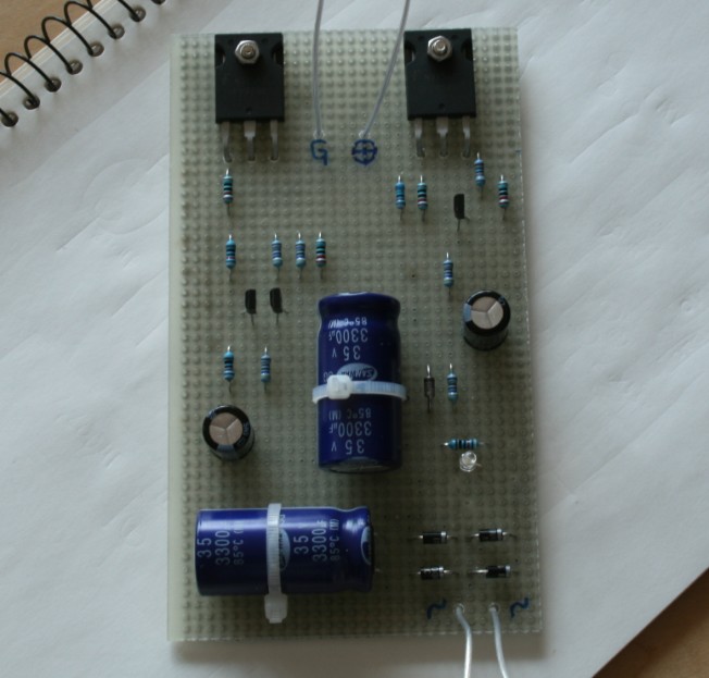

Okay, let me try to build it with mismatching Q3 and Q4 and with no thermal coupling between them. I'd like to see what would happen . . .

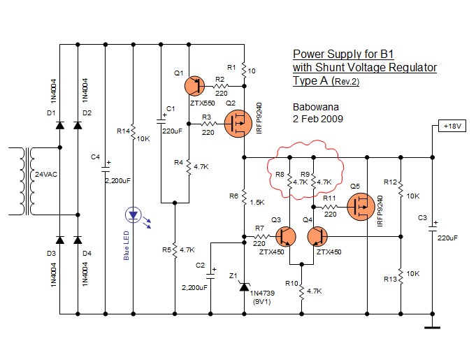

The Long Tail Pair (LTP) is measuring the difference between two voltages and sending the error signal to control the output voltage.
As a differential amplifier it works best if designed to operate as a differential amplifier. That means matched transistors, operating at the same Vce0, operating at the same Ic, operating at the same temperature and operating with constant current in the tail.
When the LTP detects a pulse or glitch it sends a correction to try to shunt the pulse/glitch to ground.
If one can arrange the circuit to make the AC or noise or pulse sensitivity higher, then all the better.
Is there room to substitute a tl431 and two resistors in lieu of the Zener?

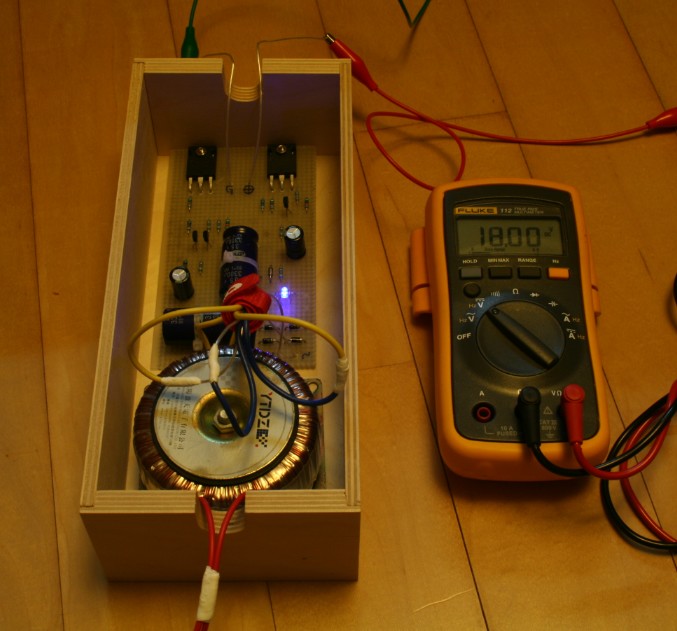

Thanks, Andrew and Salas, for your kind advice 🙂
Well noted and I fully agree with you that the matching TRs give much much better performance.

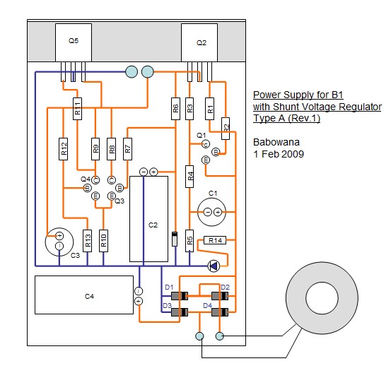

Oh . . . by the way, I have reduced R8 and R9 from 10K to 4.7K, to see the minimum collector voltage of Q3 and Q4 at about 10V on the condition that all the tail current flow through either Q3 only or Q4 only.
neither, I'm serious.
R4 & R5 do the same job as R14. Why add an extra resistor?
And if the LED lights it confirms more than just DC voltage on the supply rail.
A green one would indicate "go"
Similarly, a green LED in series with ZD1 would indicate that you have output voltage as well. To accommodate this reduce the Zener voltage to ~7V.
