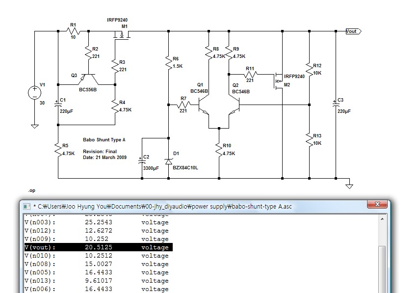

Hi All,
By chance, I have downloaded the free LT Spice and, as a first trial, I have tried it with the schematic in post#206, Babo Shunt Type A.
Since LT Spice doesn't have 9.1V zener, I have put 10V zener instead. And, I have replaced ZTX TRs to BC546/556.
Hah . . . 🙂 ! It seems working. With Vin of 30Vdc, Vout appears as 20.5125V. It's interesting. I have tried DC analysis only . . . I need to learn other LT Spice functions too! How learn . . . is a big question tho . . .

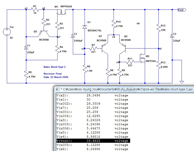

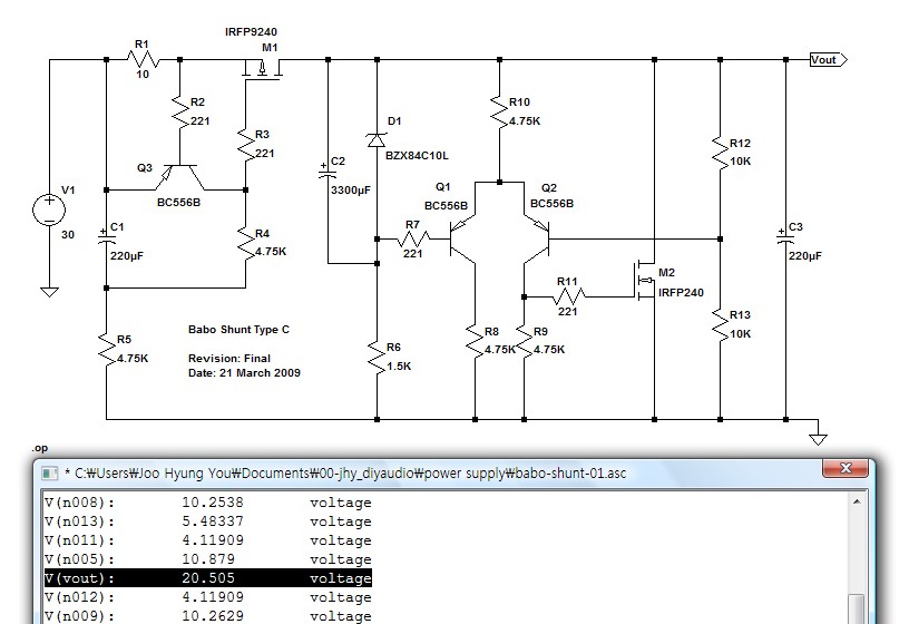

Hi Babo,
what are the voltages across the two collector loads of the LTP.
I think you will need to reduce these collector load resistors slightly to balance the LTP.
Breadboard it and measure the real voltages to find Vgs of the output FET.
your circuit works by comparing almost identical signals and outputing a factor times the difference.
The comparison is done by a differential amplifier and this is the LTP part.
An LTP works best as a differential amplifier if both halves operate with equal amplifying abilities, i.e. matched devices, matched voltages, matched currents.
This way a true difference signal is the output, subject to the distortion and noise limits of the amplifying devices.
Try adding a pair of parallel resistors to the existing pair of 4k75, start with 18k or 20k and measure the voltages.
The next value, 16k, may be too low but worth trying anyway.
An alternative is to add a trimming pot in parallel to the third (tail) resistor and use that to adjust until voltages match. But that requires you to remove the existing tail resistor and replace it with a higher value. Probably 7k5 // 20kpot. The disadvantage of this method is that you can't define the tail current in advance due to the unknown Vgs of the FET on the output.

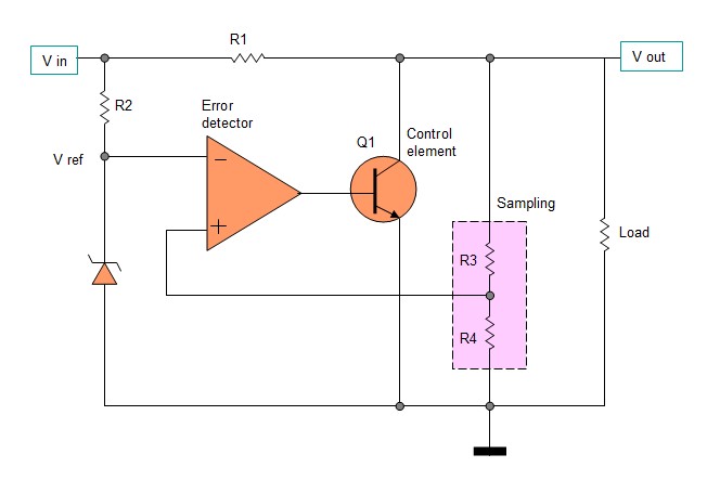

Hi Andrew,
I will decline any comment about the distortion.
I don't think there is any "true" different voltages between non-inverting and inverting inputs. Pls refer to the attached simplyfied shunt regulator (from a text book). There should be a "certain" voltage difference between non-inverting and inverting difference so that there should be a "certain" output voltage to drive the control element (bipolar or mosfet or else).
I think that we need to see other things regarding the noise . . .

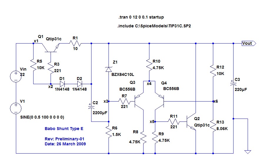

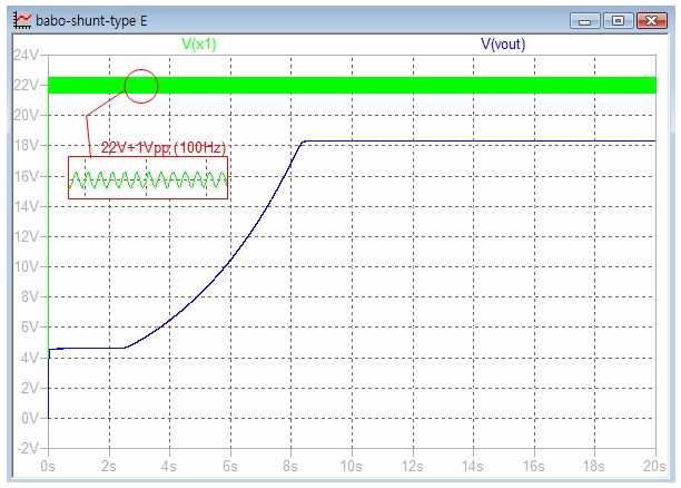

Yeah . . . I need to make myself happy doing what I want to do. I'm thinking to build one more B1, using another shunt regulator, say Babo Shunt Type E.
I have a 10VA EI transformer of 2X18VAC secondaries. I believe that this size is big enough for B1. Meanwhile, I have found few leftovers of TIP31C bipolar TRs, which I have bought times ago when I have built my first BOZ. So, I want to use these for a new shunt regulator.
The attached scematic is the LTspice model only for a simple simulation. When I actually build it, however, I think I need to change some parts, for example, R1, R5, D1, D2, Z1 and R13 . . . most probably . . .
In the LTspice model, I have given two input voltages--22Vdc and ac sine voltage having 0.5V amplitude (1V peak to peak) at 100Hz.
