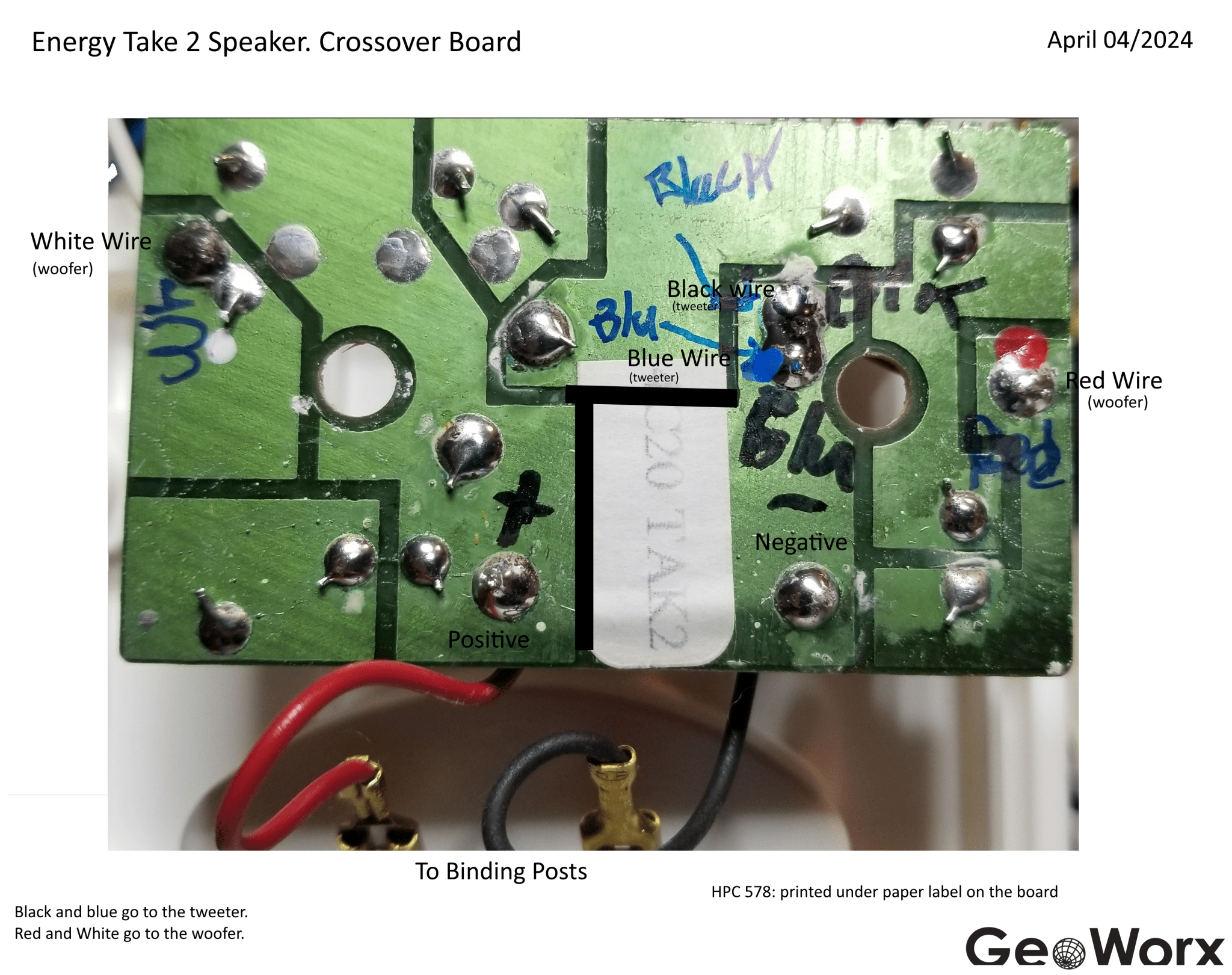

In my quest to understand crossovers, I disassembled a satellite speaker I own and took out its crossover for a look see.
The donor in a ENERGY Take 2. It is a two way satellite speaker and there were four of these in the house when we moved in (I have two still in use).

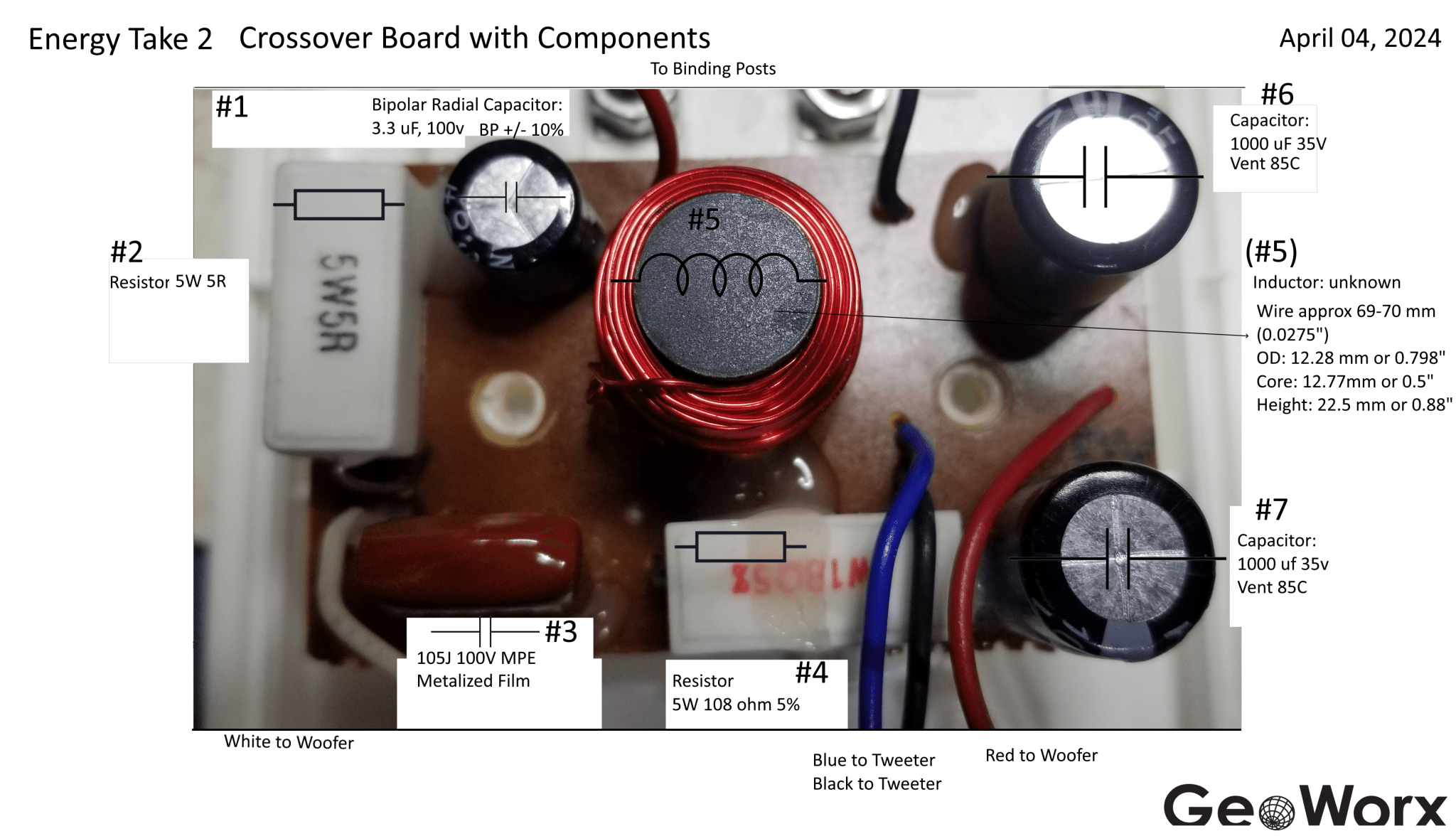

Can the community help me understand what all the components are?
I started labeling them and poking around as to what they do.
The ones I need more information about at #2, #3, #, and #5 the copper inductor coil.
George
brown component in the lower left corner
1 µF capacitor, 5% tolerance, metalized film, according to the text on the image.
https://circuitdigest.com/calculators/capacitor-value-code-calculator
For 3 digit’s capacitor code, the first two digits are the capacitance value in pF and the third digit is a multiplier factor of first two digits to calculate the final capacitance value of the capacitor.
The 3rd digit ranges between 0-6. It can’t exceed more than 6.
If 3rd digit is 5, it means multiplier factor of 100000.
