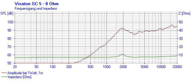

I think you are correct. The Dayton RS 180 7" has a terrible frequency response curve and I've been trying to use Xsim to tame it. I think I will stay with the Tang Band W5" for now.
The Visaton tweeter is my choice because it matches the sensitivity of the Tang Band and the dimensions of the driver means it will fit in the box. As the box is, there is not a lot of room from the center of the tweeter's opening and the edge of the box. And the Visaton will cross around 4,000Hz (3,600 approx.) and the Tang Band begins to drop off at around 11kHz.
In looking at those drivers, you’re assuming that the specs are accurate and that the mid woofer won’t lose any dB once mounted. Both of those assumptions are probably incorrect.
Re the RS180, the FR can be tamed by putting a small cap ( say 0.22 microfarad) on the woofer and careful selection of the parts values; relatively easy.

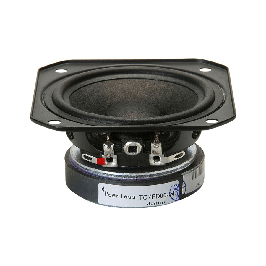

Future parts supply aside, your tweeter cut out could accommodate the little Vifa TC-6 or TC-7 full range drivers (2" and 2.5" respectively) , which have been used in place of tweeters in some builds. I don't know, but suspect, that they would sound nicer than the mylar Visaton tweeter.

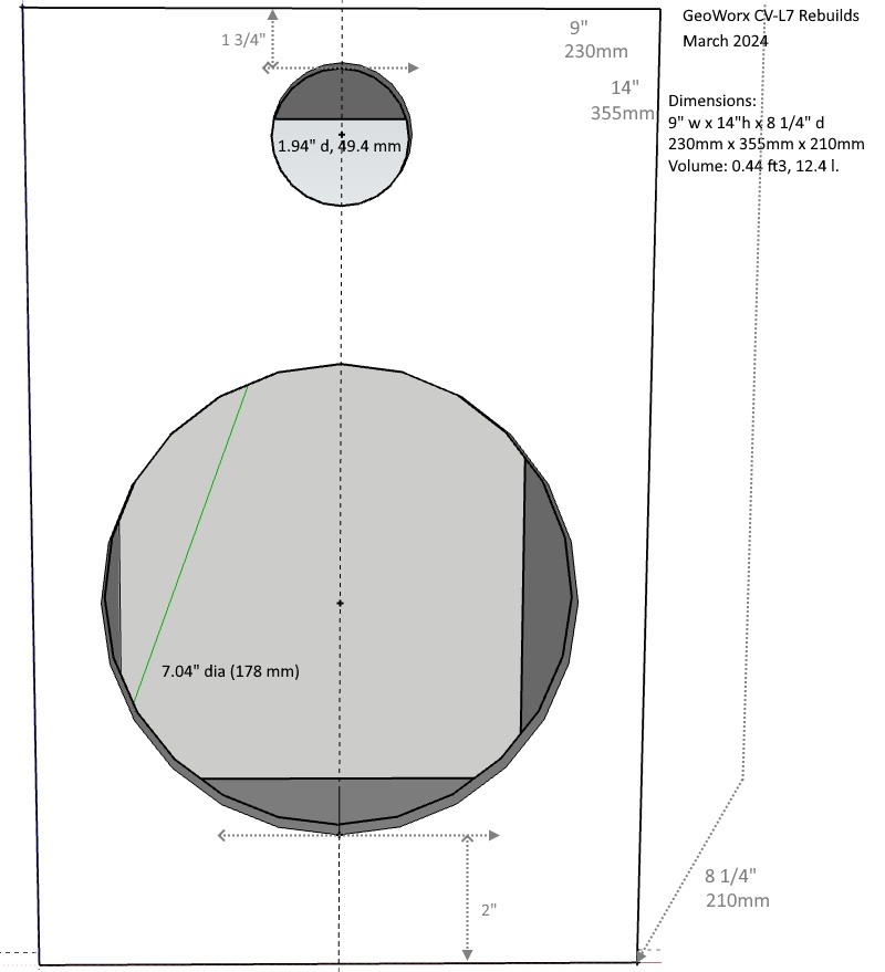

Would you be capable of making changes to the tweeter cut-out?
What I understand that you will be adding a layer of ply/MDF on top of the front baffle to make the woofers fit (as it might be difficult to find a woofer with the the same cut-out spec that will work in this cabinet)?

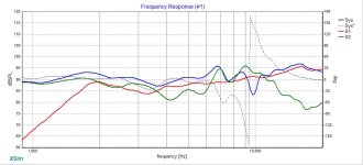

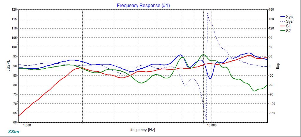

If you use the same data inputs to a crossover program, you'll most probably get the same results.

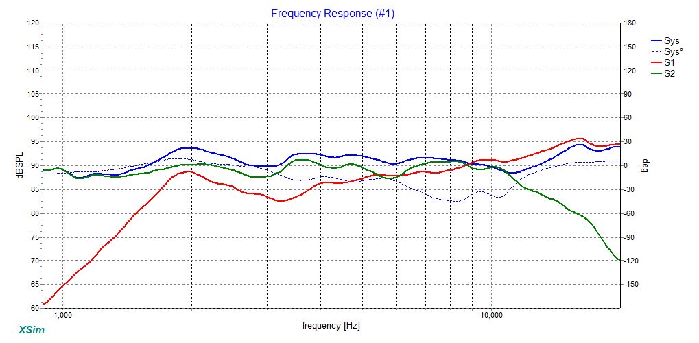

I've posted this a few times, but here's the Xsim version of the well known Classix II speaker, for which I used the manufacturer supplied graphs and fp trace, compared with the real world measurement. The top graph is Xsim, the second is what it really looks like.
The same crossover values were used, so you can see from these graphs that if you rely on supplied data your results will not be accurate.
Geoff
Geoff

An alternative approach, if you want to mess around a bit, might be to consider making a new baffle to fit on your Cerwin Vegas.
Then , choose a mid woofer and tweeter which have smooth responses (suggest getting ideas from Forum members) and are relatively easy to work with. As noted above by zman, you may have accept a little loss of bass performance due to cabinet size, but you say you have the bass covered in any case.
Once you've decided on the drivers you can cut a custom baffle.
Then, read up on the 'designing crossovers without measurement' thread on this Forum and your crossover book and have a play. Paul Carmody and Curt Campbell's web pages have good articles on this topic, too.
With your baffle width, I'd go for a 6"-6.5" mid woofer and a 1" tweeter to give a good range of options, paper rather than aluminium mid.
