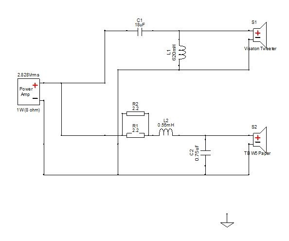

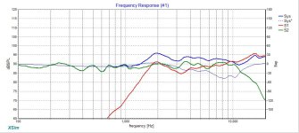

I am looking for advice with crossover design. I am attempting to rebuild a set of Cerwin-Vega! L7 Bookshelf speakers. I have decided to use the following drivers:
Visaton SC5-8 Shielded 1/2" Polycarbonate Tweeter 8 Ohm.
Tang Band W5-2143 5" Paper Cone Full Range Driver 8 Ohm.
The enclosure volume is 0.44 cubic feet or 12.4 liters. I am reusing the existing port (1.69” x5" cut down to 3"). I am stuck with the 0.44 cubic feet as I don’t want to cut open the boxes.

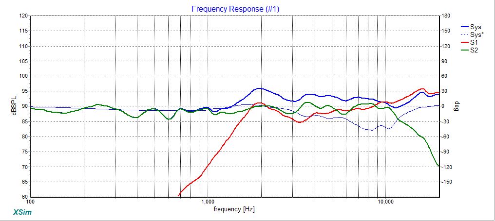

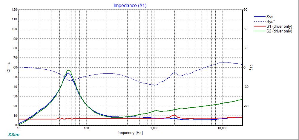

I have been experimenting with Xsim for designing the crossover but have a couple concerns, mainly around the impedance curves. I am not sure what is going with the impedance curve for the Tang Band W5 driver, it has a massive spike at around 54 ohms. Nothing seems to smooth it out and I am wondering it this has any potential ramifications to harm my amp or the speaker itself.
Andy help would be greatly appreciated. I have attached a couple images from Xsim.

A few questions/comments:
  • have you used measurements in box or used manufacturers' data? If the latter, it won't generally give optimal results. I recall from somewhere that Tang Band's published measurements of some of its drivers may not be as accurate as other brands.
  • have you bought the drivers or just considering what to buy? How did you choose them? The L7 looks like a 7" two way design, so a 5" driver will require a new baffle.
  • If this is the case, why not look for an existing two way project with a 6" or 7" woofer which would work in that enclosure?
  • my understanding is that resistors in line with a mid or woofer - e.g. to try to reduce its output - are not a good idea due to heat build up, but I'm happy to be corrected
  • just looking at what you've provided, it will probably be a bright sounding speaker with weak bass.

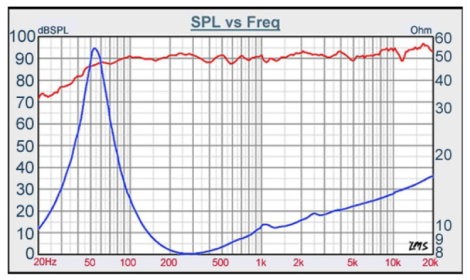

With a wide-band driver like the TB W5-2143, there should be adequate top end to use it without an additional tweeter, thus reducing cost of the tweeters and the cross over parts. The TB-2143 costs quite a bot more than similarly sized woofers/mid-woofers.
According to Parts Express product page, the BR-1 port is 1.5" x 6"; another design which uses the DC160, the Classix II (15l cabinet) , has a 1.5" x 4" port. Not sure what these dimensions mean in comparison with the 1.69" x 3" in the L7 cabinet.
Geoff
This is the TB stated frequency response and impedance curve graph, taken from its website.
Looks rather good, but then it's an expensive driver - $100 each from Parts Express. I think there are some builds on this Forum which use this driver without a tweeter.

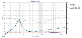

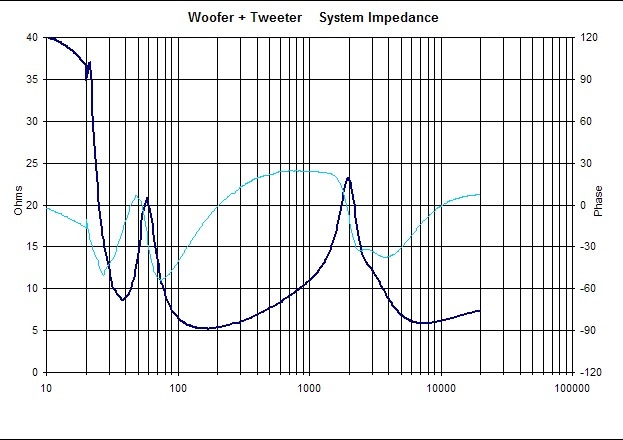

That's from resonance. It's a normal feature of a woofer in a sealed box, infinite baffle, etc. In other types of boxes the shape changes, but peaks are still common.
Impedance peaks at bass resonances are normally left alone. The components to flatten them are large (expensive), and with modern amplifiers impedance variations like this are rarely an issue. If you want to fix it anyway, you need an LCR series notch filter. Those 3 components go in series, and that group goes in parallel to the driver in question. This type of filter is more commonly used in tweeters to improve crossover performance. With a tweeter, the large rise in impedance can be in the range where the crossover is working, so it makes the crossover less effective. At bass resonance, passive crossover filters are not normally doing much.
https://www.diyaudioandvideo.com/Calculator/SeriesNotchFilter/Help/
If you have a tube amp with high output impedance, large speaker impedance variations can cause frequency response changes, but that's a pretty rare issue.
I've seen people using inexpensive class D amps talk about high impedance issues also, but I have no personal experience with that. And if you do, I'd suggest upgrading the amplifier instead of trying to make the speaker more benign to a poorly designed amplifier.

If the impedance spike of the TB W5 is not going to be an issues (this speaker should fall off before 54 Hz), then I wont' worry.
These speakers are being powered by a Sony STR-DE925 (110 RMS, Peak 165 watts at 8 ohms, Peak 230 watts at 4 ohms) set at 4 ohms.

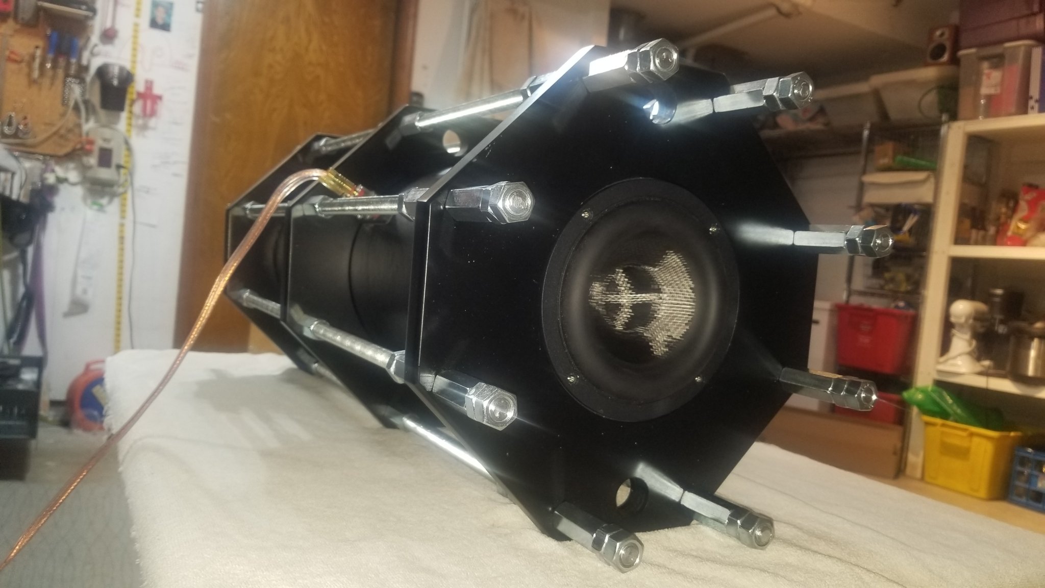

My desire to use a full range driver and a tweeter is my attempts to learn how to "program" a crossover. This project is part of a three part process to building a set of 3-way tower speakers.
Step one was a active sub-woofer, step two is designing a set of two-way speakers and learning the art of crossovers. Step three is the design of the 3-way towers.
Attached is the tube based subwoofer I recently completed based on the Epique E180HE-44 7" DVC MMAG Extended Range Subwoofer. (Dimensions 25 3/4" long. OD 7.7" with a volume of 0.59 cubic feet or 16.7 liters). It is reproducing a response down past 30k (audible).

As for a crossover, I think I will need some "control" to smooth out the sound and the find a good zone to hand off the highs to the tweeter. I'm thinking in the 4-6kHz.
It's all theoretical until I pop some drivers into the boxes.
George
Responding to Geoff's suggestion about using the Dayton RS180-8 7 inch. The sensitivity is listed at 87.1 dB and the tweeter I am considering (because it fits the current opening) is listed at 90 dB (Visaton SC5-8 Shielded 1/2" polycarbonate 8 ohm).
Will I need additional circuitry to math the sensitivity, or will they be close enough?
The stated dB of the RS180 - or any woofer, for that matter - should be taken as a guide, measured under the maker's conditions. When you put the woofer in a cabinet, my understanding is that several dB will be lost due to 'baffle step' issues. Others can explain that much better than me!
Tweeters are almost always more efficient than woofers and need to be padded down in the crossover, e.g. with resistors. With the RS180 (paper or aluminium) the crossover will generally be around 2,000 Hz and the nasties in their response need to be successfully dealt with in the crossover. For example, see how Paul Carmody deals with those issues in his well known 'Amiga' two ways:

Using an 8 Ohm woofer will not automatically guarantee and minimum impedance of 8 Ohms... it will depend on the drivers and the crossover design you end up doing.
An example of a speaker impedance curve with an 8 Ohm (nominal) woofer and a 4 Ohm tweeter attached. A 4 Ohm woofer would bring the impedance even lower though...
As long as the tweeter is higher sensitivity, you can pad it down easily using a resistor. And a woofer with 87 dB measured on a IEC standard baffle will not be the same with a 8"-9" baffle of a cabinet. You will have to factor in the baffle step loss, which might be 3-6 dB... so it is more likely you might be getting 83-84 dB sensitivity and will have to reduce the tweeter output accordingly.
