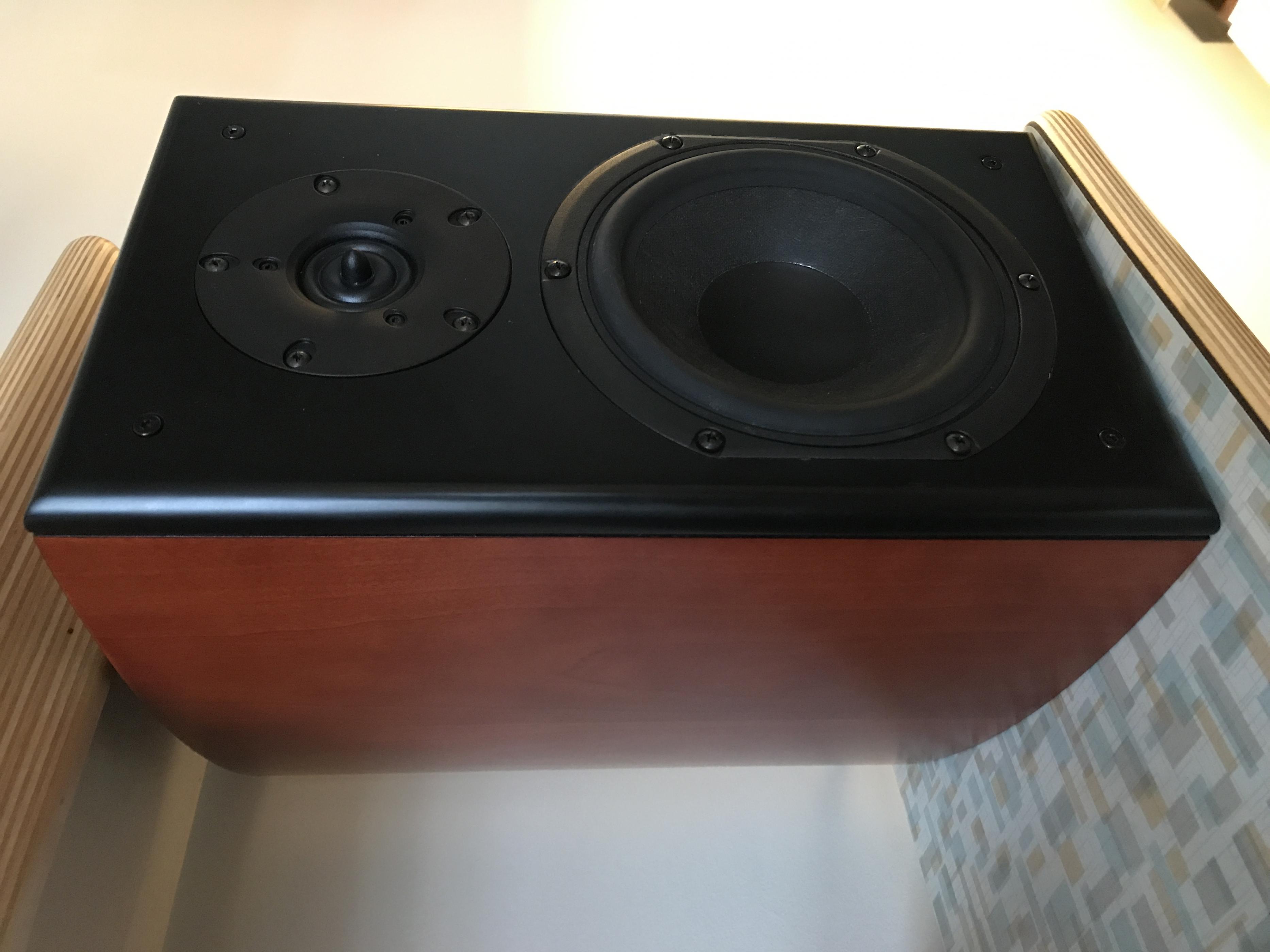

Hello All,
It has been quite some time since I wanted to make this bookshelf design. I chose the Vifa XT-25 and paired it with the 4ohm version of the Peerless 830875 which is the 830510. I cannot find much info on the mids, but went with what I could find.
Since this is my first "from scratch" build I wanted to keep it simple to start with and go from there if needed. So the XO is just a paralleled pair of caps totaling 15.7uf connected in series with the positive side of the tweeter. With the specs on the tweeter imp being 3.4ohms & the mid being 3.85ohms that should give me a XO at approximately 3000Hz.
They sound pretty good, but I have very little experience "voicing" speakers.
I have no testing setup, but instead want to try and help these be as nice as possible without getting too involved in "testing", if possible. I do have more than a handful of parts to mix, match, and swap out for listening tests to help me develop the crossover as I go, but I simply lack direct experience to start jumping just yet.
They are installed in the now discontinued Dayton Curved Enclosures with replaceable baffles. They are a sturdy design with some heft to them. I also added polyfil to the cabinets that are NOT vented. They are being driven by a Denon AVR-X4500H set to 4ohm and everything seems fine so far.
Any thoughts on what I have done so far? Am I missing something or have I done something to this point that could be destructive to the drivers? Again, this is my first set from scratch so I do not want to do anything stupid that will damage them. I have intentionally kept the volume low until I hear some feedback.

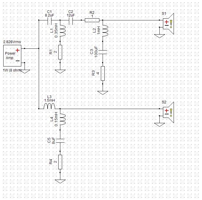

But if it has about the same FR as the 830875 and if it has about 1/2 the impedance profile, which are pretty big if's actually, then you might want to try the attached xo. This is based on a modeled xo for the 830875 and the XT25 - Peerless 830875 & Vifa XT25.............. -
Techtalk Speaker Building, Audio, Video Discussion Forum
- with the appropriate changes for a 4ohm instead of an 8ohm woofer.
No guarantees though but it might be a good starting point. I'm assuming the 4ohm version should play louder than the 8ohm so I reduced R2 from 4ohm down to 1ohm, but this should probably be the 1st component that you'll want to play with. The series impedance flattening notch placed in parallel with the tweeter terminals is essential with that tweeter btw.

A few more questions.......
I would like to gain a better understanding as to the purpose that each section in the XO serves and how it interacts with what I hear or experience while listening.
And as such, using the drawing, this is what I "think"......... the series L,C,R networks in parallel to both the woofer and tweeter are conjugate / notch for impedance flattening and control. I also "think" that L3 is controlling the crossover point for the woofer and either C1 or C2 is controlling the tweeter. R2 is contributing to brightness. I do not understand the shunt combination of R1 & L1 or the remaining cap in series with the tweeter positive side.
Tweeter Parts:
XO Control C1-8.2uf
R1-2.0ohm
L1-.35mH
C2-12uf
Brightnness R2-1.0ohm
IMP Conjugate L2-1mH
IMP Conjugate C3-100uf
IMP Conjugate R3-4.0ohm
Mid-Range Parts:
XO Control L3-1.5mH
IMP Conjugate C5-8uf
IMP Conjugate R4-2.0
IMP Conjugate L4-.15mH
It is indicated that appropriate changes were made for a 4ohm instead of an 8ohm woofer. Which changes were affected and why? I am assuming that by lowering R2 the tweeter will bow down to the woofer sensitivity?
I hope this all makes sense. Please help me clarify my "thinking" and correct me or add info as necessary.
David
C1 and C2 along with L1 form a 3rd order high pass filter for the tweeter.R1 fine tunes the slope. R2 controls tweeter sensitivity, the components to its right are likely there to dampen an impedance hump at resonance. It's more effective with drivers without ferro fluid as the fluid dampens the peak.
L3 forms a 1st order Low pass filter, the other components connected in the bass section are a notch filter to control a HF peak I suspect.

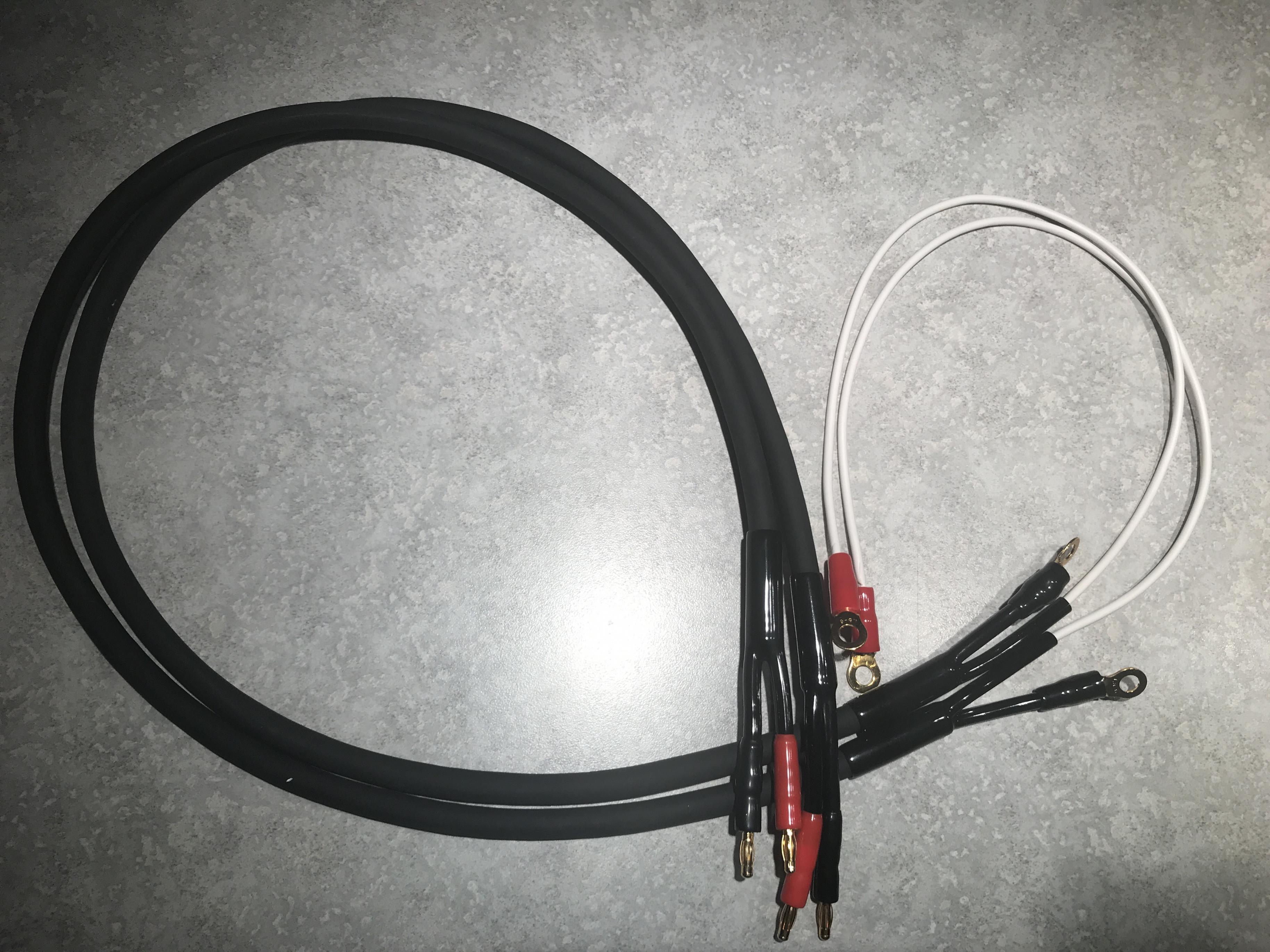

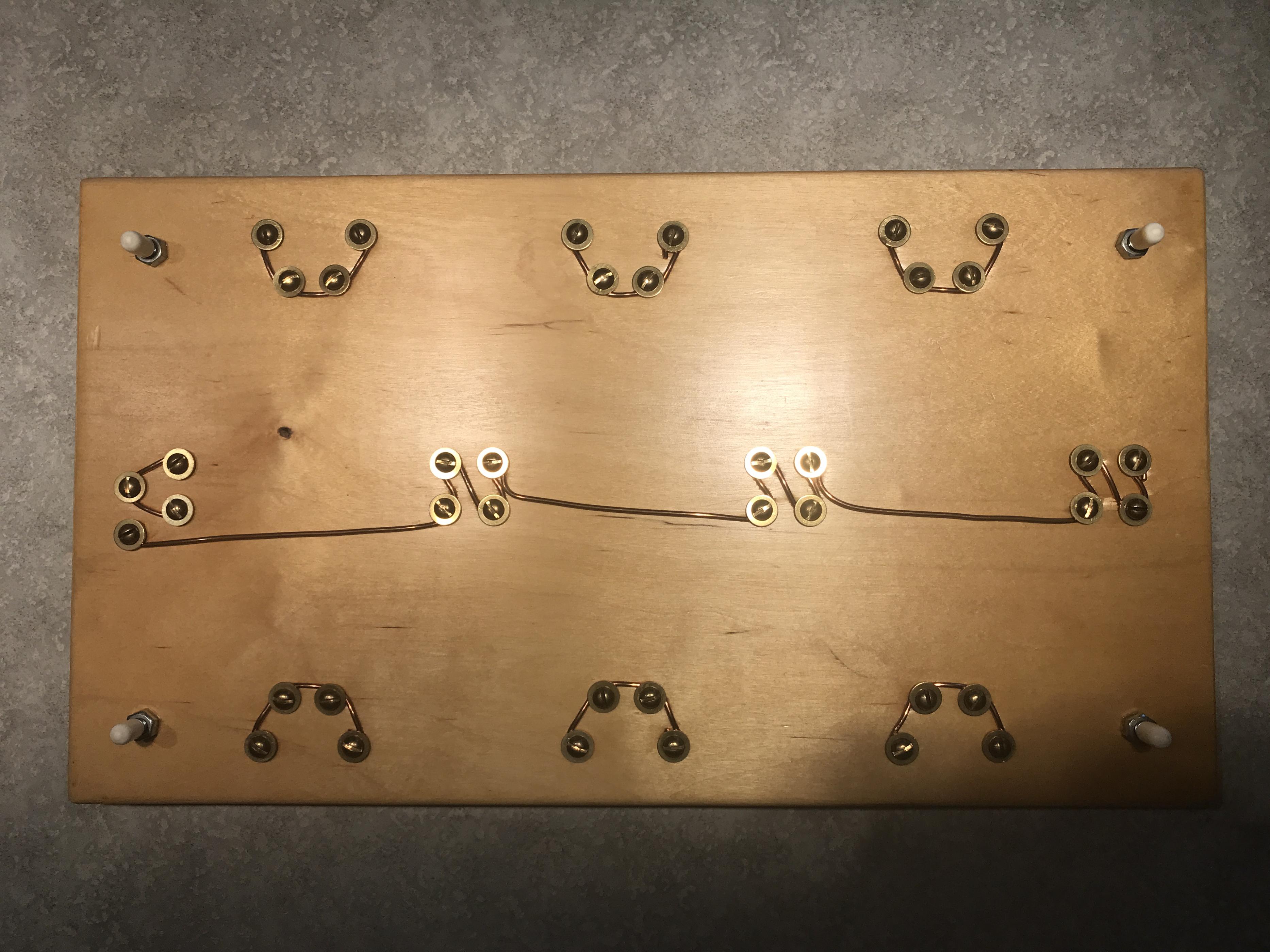

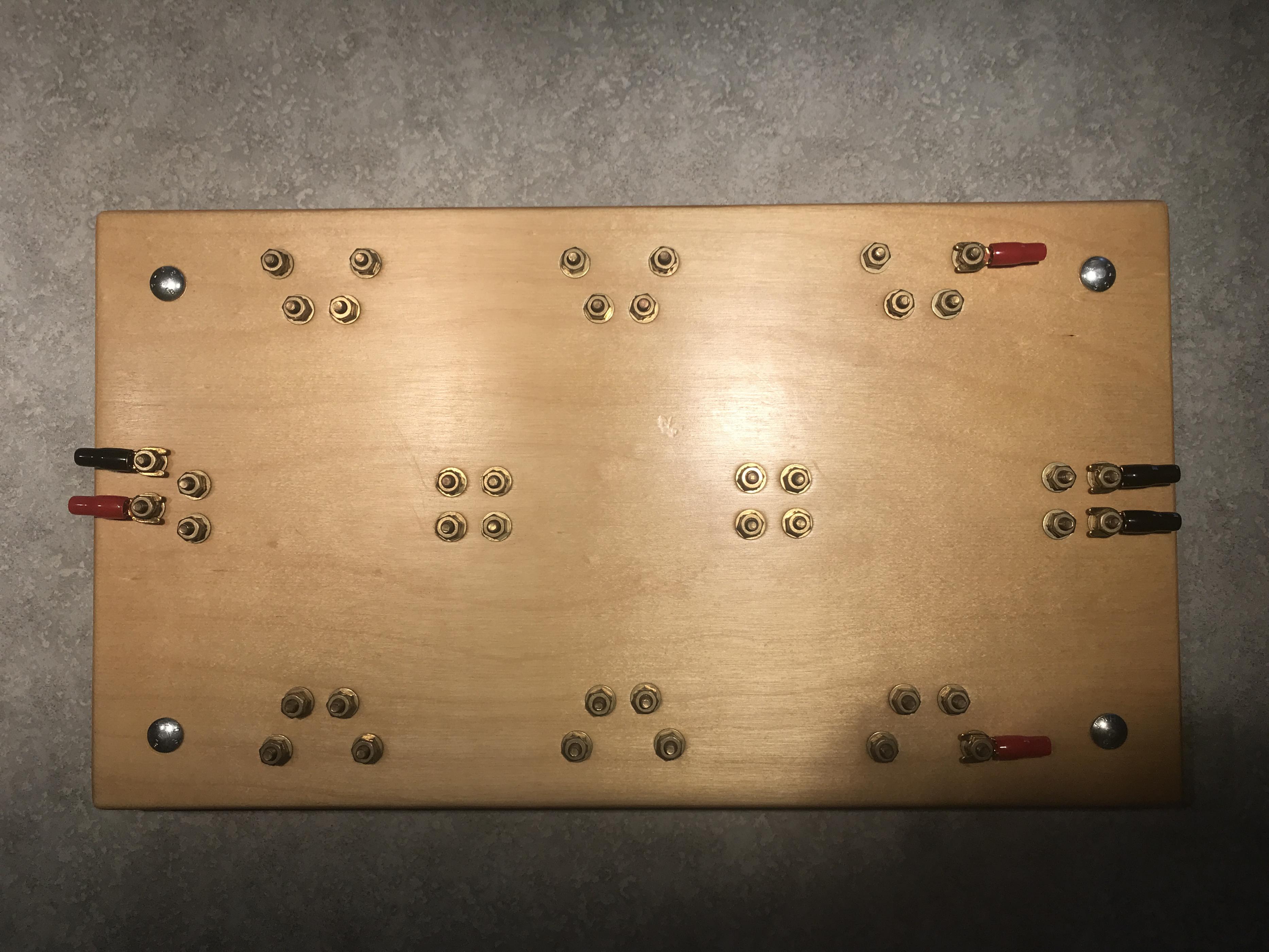

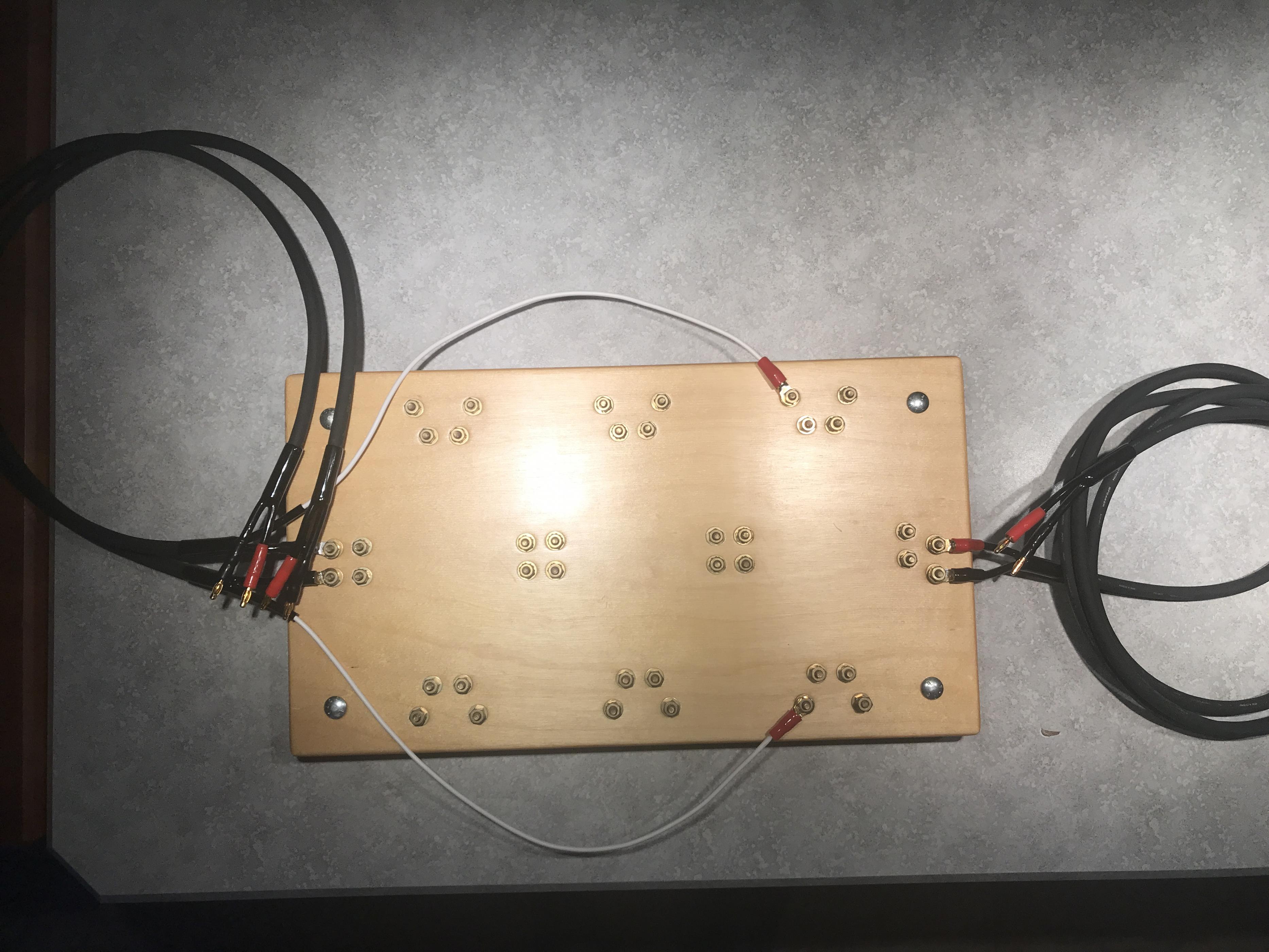

In preparation for the XO work to be as simple as possible I have constructed a pair of Crossover Engineering/Prototype Boards.

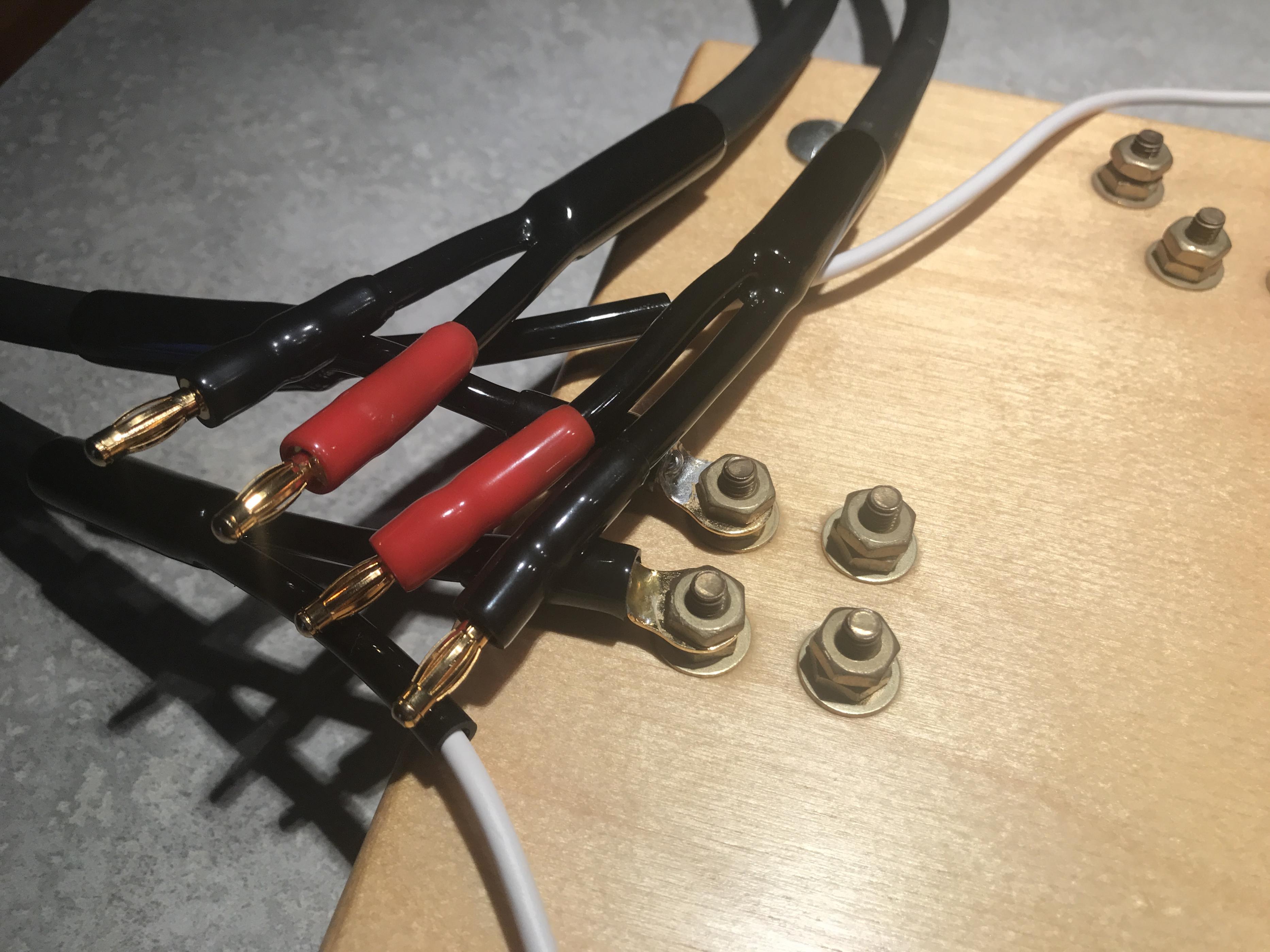

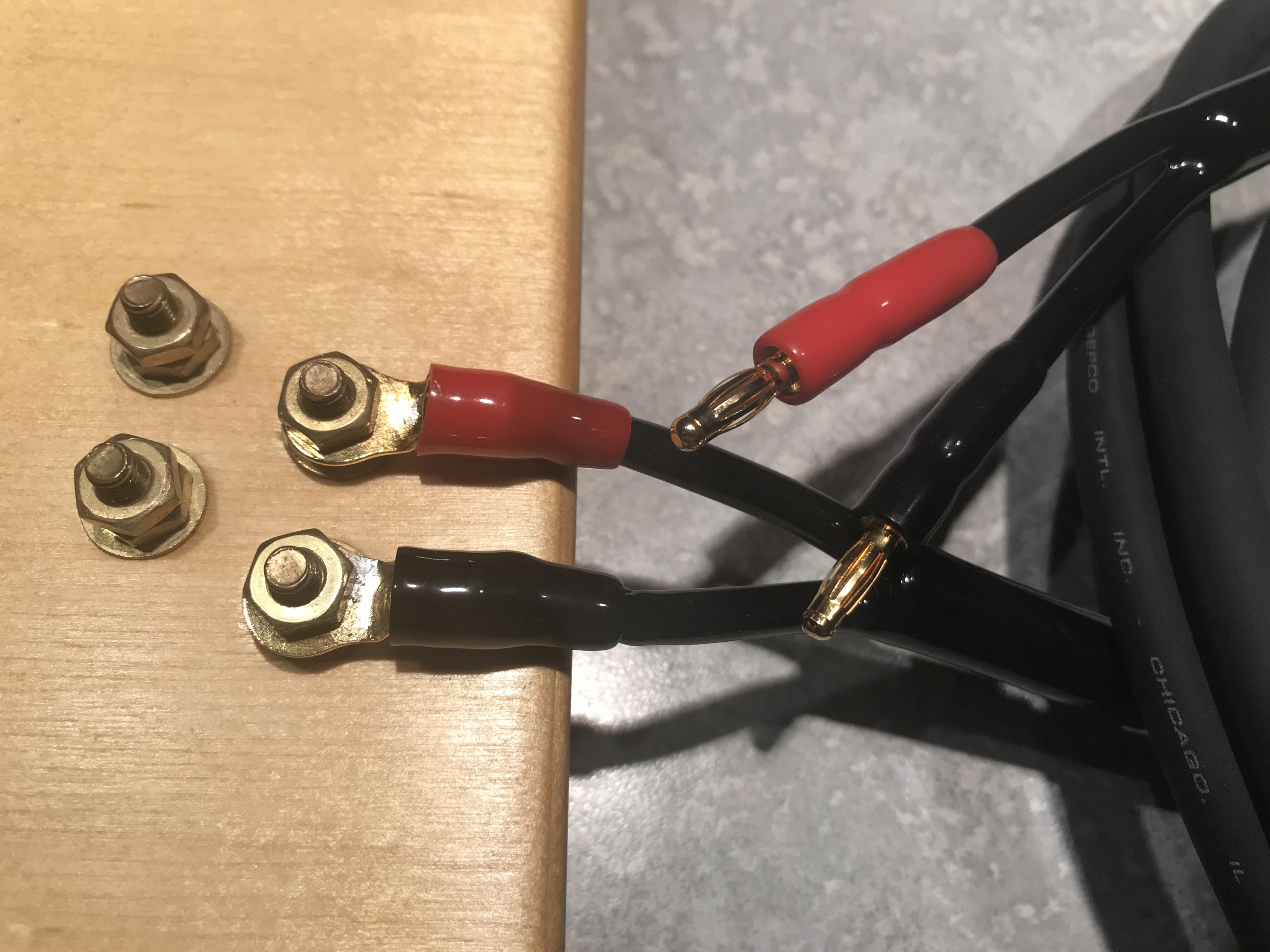

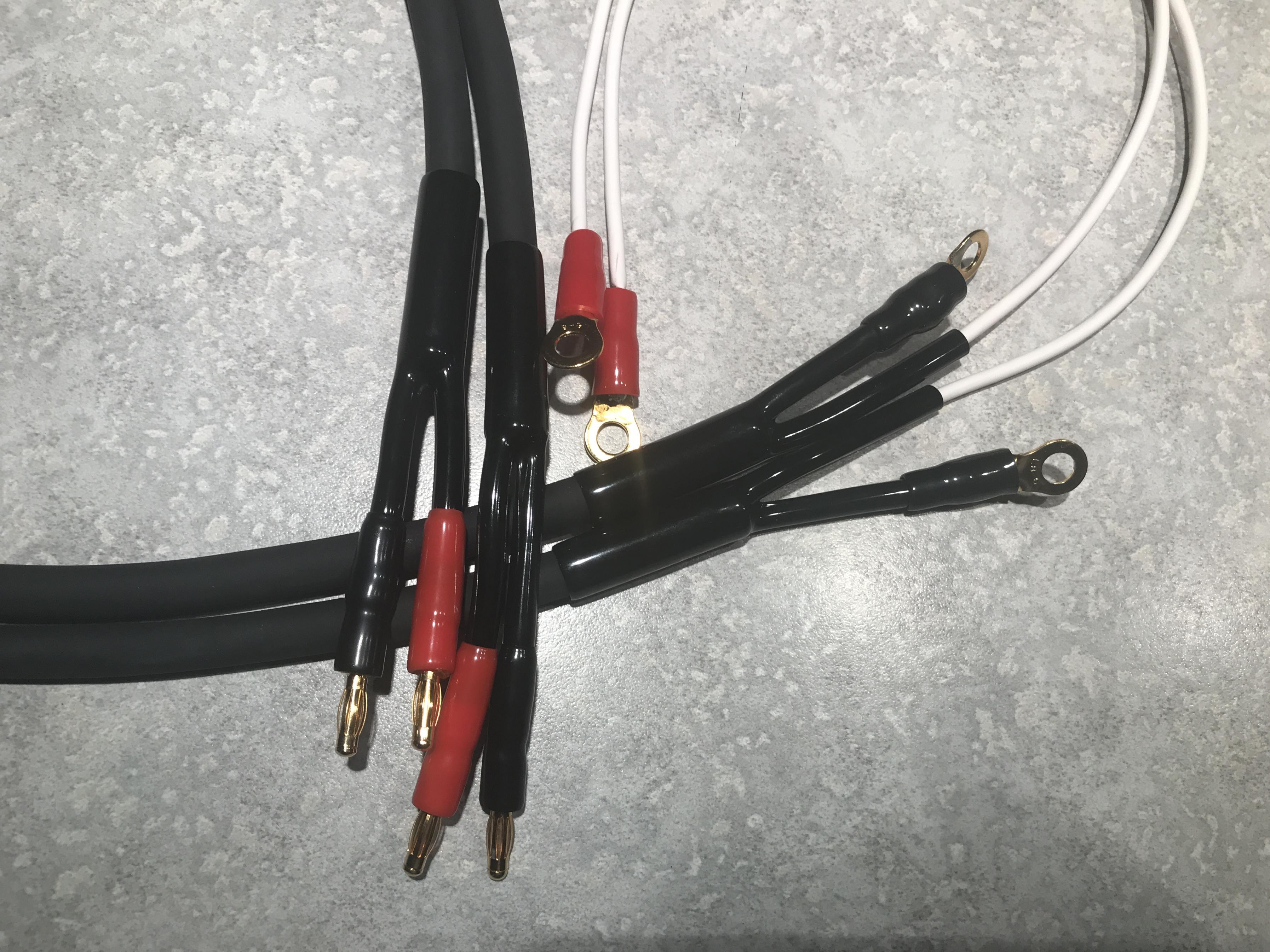

Now I just need to add a second pair of binding posts to the rear of the enclosures and wire each driver and polarity to their own dedicated posts.
And of course a set of wires to connect the speakers to the prototype board.
Good times for sure!!!

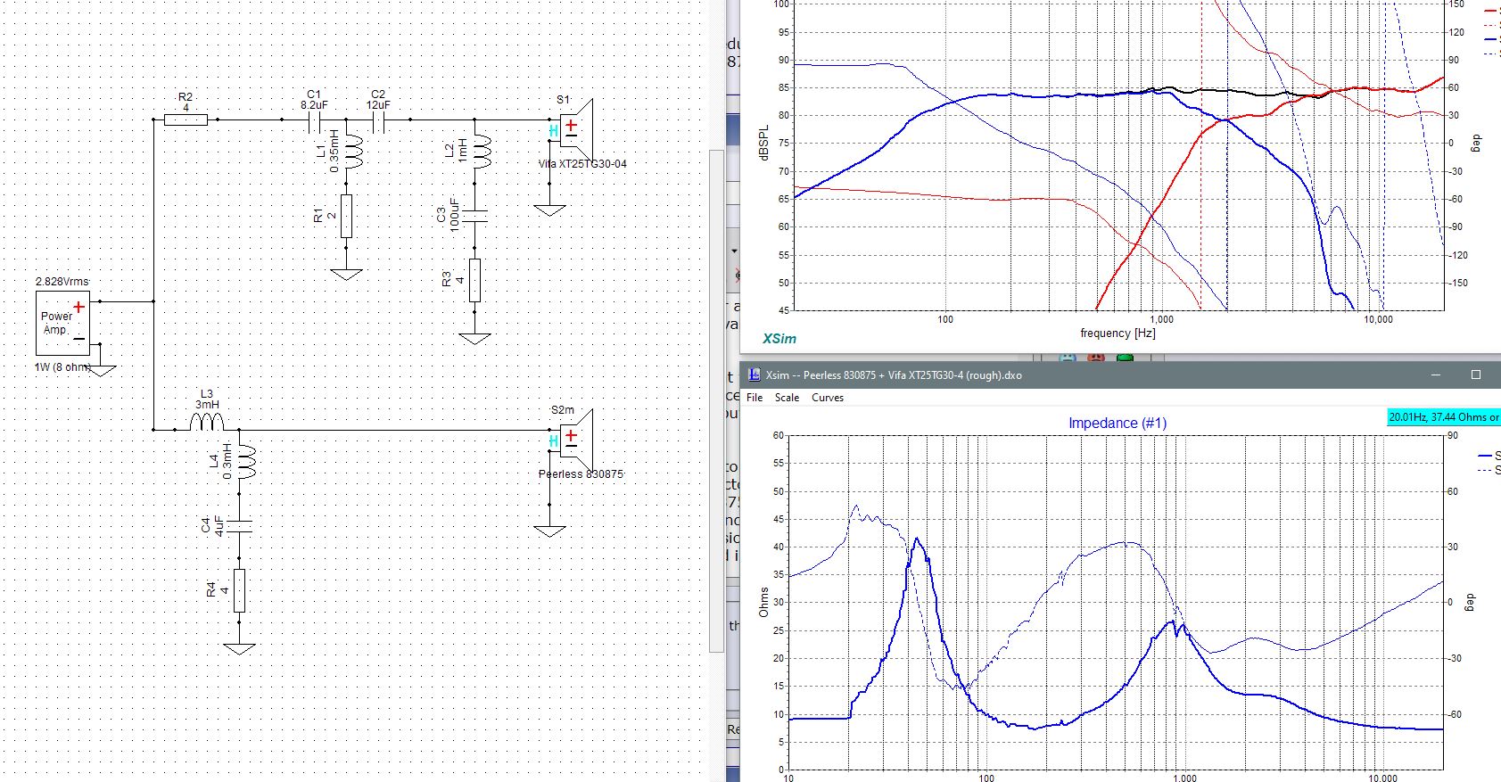

Since you have the Peerless 830875 too, I would go with that one.
I just did a sim to double check the PE xo with that driver and it looks good.
In comparison, there are just a few too may "if's" involved with the other one. If you want a xo that does that 4ohm driver justice, you should really measure both the FR and impedance with the driver in the cabinet. You can play around with sims and xo parts until your heart's content but there's no guarantee to get it right without starting with the correct data, ie. the measured responses.
I concur with TimA's analysis of the xo. Additionally, you can almost always tell the difference between a notch filter aimed at a driver's resonance peak vs somewhere else by the rather large value(s) that they require - 100uF for the tweeter for eg in this case.
Because the xo wasn't diagramed in that thread (only described), I wasn't exactly sure where R2 needed to be placed. The description seemed to suggest that it go after the tweeter xo but when I did the sim, it works better if it's before the xo. Pic attached.
In terms of going from an 8ohm driver to a 4ohm driver, theoretically that means that you need to reduce an inductor by 1/2 and increase a capacitor by 2. However, when I manipulate the 830875's impedance to approximately match a 4ohm version (ie. reduce the whole thing from about 6ohm nominal down to 3ohm nominal), the FR doesn't end up as nice as the the original xo with the 830875. And that's if the 4ohm version has a similar FR and if it has about the same impedance just reduced in value right across the frequency spectrum. Like I said, that's a lot of if's. I played with that xo for a while and I did get something that looked good but I had to change the method of attach slightly. I could post it as a starting point but this time I am hesitant to do so because again, just a few too many if's involved.
