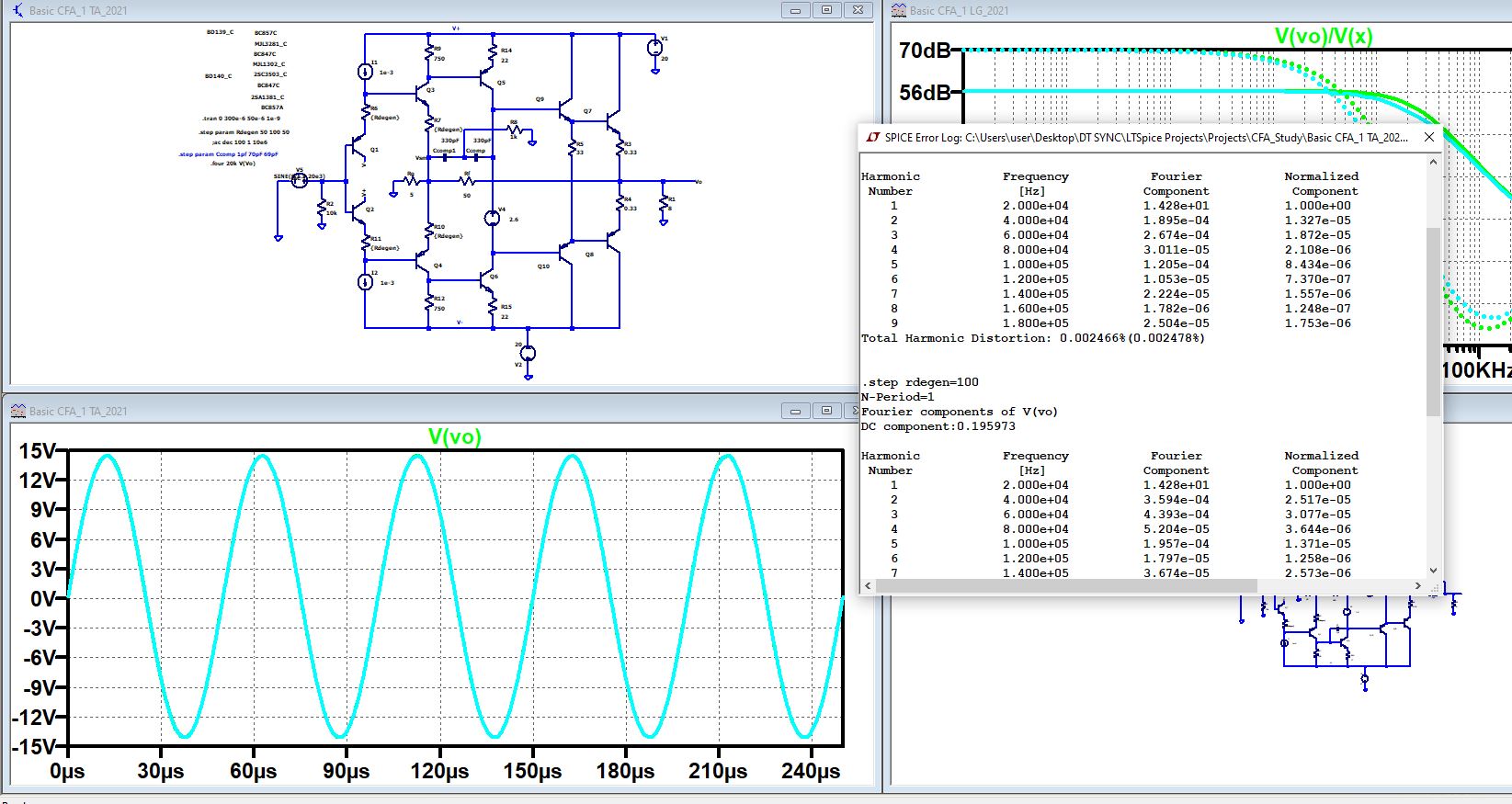

You could find a more realistic (which does exist, nevertheless) example. I'm sick of these synthetic simulations (here, using ideal current and voltage source for bias) plus the crap models available for free.
I love this audio design approach, coming up with unrealistic numbers from simulation to prove a design, then when confronted with the bench reality: "naaah, you cannot hear these numbers, anyway".

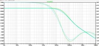

Yes, you are right: that is woefully inadequate.Here's what woefully inadequate looks like.
You are right up to a point: the ultimate proof of a concept lies at the tip of a soldering iron, but the purpose of SPICE work is to gain insights that may not be readily unobtainable with a prototype. Of course, one should always be aware of SPICE's limitations.You could find a more realistic (which does exist, nevertheless) example. I'm sick of these synthetic simulations (here, using ideal current and voltage source for bias) plus the crap models available for free.
But how else do you compare these things from the basic operation perspective? The models are good enough for a 1st order analysis showing loop behaviour/gain/phase etc between the topologies which is all we are doing here.You could find a more realistic (which does exist, nevertheless) example. I'm sick of these synthetic simulations (here, using ideal current and voltage source for bias) plus the crap models available for free.
For operation at audio frequencies, most of the LTspice models work remarkably well in predicting distortion, FR, noise etc. I had parasitic oscillation problems on the first version of the kx-Amp, but that issue was ultimately solved using Spice to model the problem (I recall you also initially had stability issues on the PGP).
A lot of the stuff modelled here on the forum by various people has been built and it works well (measured) and is in close agreement with the sims - just root around on the forum.
You are not in a position to talk about 'naah you cannot here the numbers anyway'. Remember your PGP? Could you hear the difference between sub 1ppm and another decent 20 ppm amp?

A major loop gain of only 56dB at infrasonic frequencies is unacceptably low for an audio frequency amplifier. With a two-stage classical ("voltage feedback") design, major loop gains in excess of 100dB at infrasonic frequencies are readily attainable.Here's what woefully inadequate looks like.

Ok, so what does your simulation show? Very low distortion numbers, that you will never get in the real world with that circuit (unless you will find ideal devices, current sources, voltage sources, etc...), nothing more than that.
Yes for FR and noise (and any other small signal metric) nope for most of the large signal metrics (distortions, clipping behavior, load behavior, etc...). In particular at the levels you quoted, that is under 0.0025%, not to mention Dadod's claims of 0.000044%. It would be extremely helpful if, instead simulating the bejeezus out of the same old dusty examples, more effort would be invested in fixing and improving the existing models, in particular for power devices. Something that Andy C (and a very few others) started many years ago, and Mr. Cordell, other than bringing them in a convenient collection, unfortunately did not. The stock models need to be changed structurally, not only adjusting the original parameters. I know, it's not sexy or an otherwise rewarding work.
I’m not condoning any specific numbers that are outrageous and very few of my published designs show ultra low distortion in sim. My amps MEASURE well and that’s what counts. I don’t chase 1 ppm distortion either unless it’s for s marketing reason (sub 10 ppm at 200W).
We’ve both designed and built low distortion high power amps and know the gap between simulation and reality is paved with good intentions and massive implementation potholes and especially so at 10 ppm and below. However, to get a grip on what to tweak, sims are a great tool. It’s also cheap and easy to measure this stuff today and I do that with everything since 2017 when I got my QA401.

Mike, the loop gain at low frequencies (infrasonic, as you call it) is largely irrelevant. What really matters is the loop gain at HF, in particular at 40KHz and 60KHz, since that’s what helps lowering the 20KHz 2nd and 3rd harmonics. It would be a fair point to compare HF loop gain (with the associated stability margins) at these frequencies.A major loop gain of only 56dB at infrasonic frequencies is unacceptably low for an audio frequency amplifier. With a two-stage classical ("voltage feedback") design, major loop gains in excess of 100dB at infrasonic frequencies are readily attainable.
