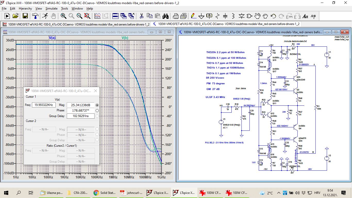

If you meant that VAS/TIS is only stage with gain it is not so, IPS has gain too, look AC plot of this CFA IPS with passive load and overall amp LG is flat up to 20 kHz.
syn08 was always afraid of high ULGF, not sure way, probably never tried to build real amp with ULGF higher then 1 MHz.
Example showed here earlier was an amp with active load as an example how high LG can a CFA have. I did not build it yet, and would probably use more conservative approach wit ULGF between 2 and 3 MHz I used in my already built amps. Many others in this forum built 100W version with no stability problems.

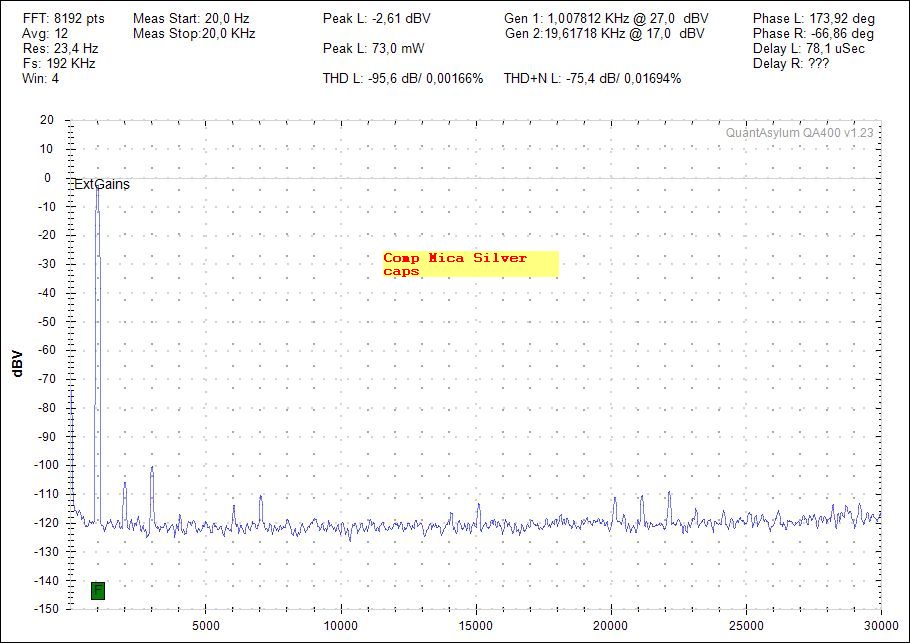

I attache real FFT measurement of my CFA amp(serial combination of ClassA and ClassB) to show that CFA can have quite low distortion.
Damir
