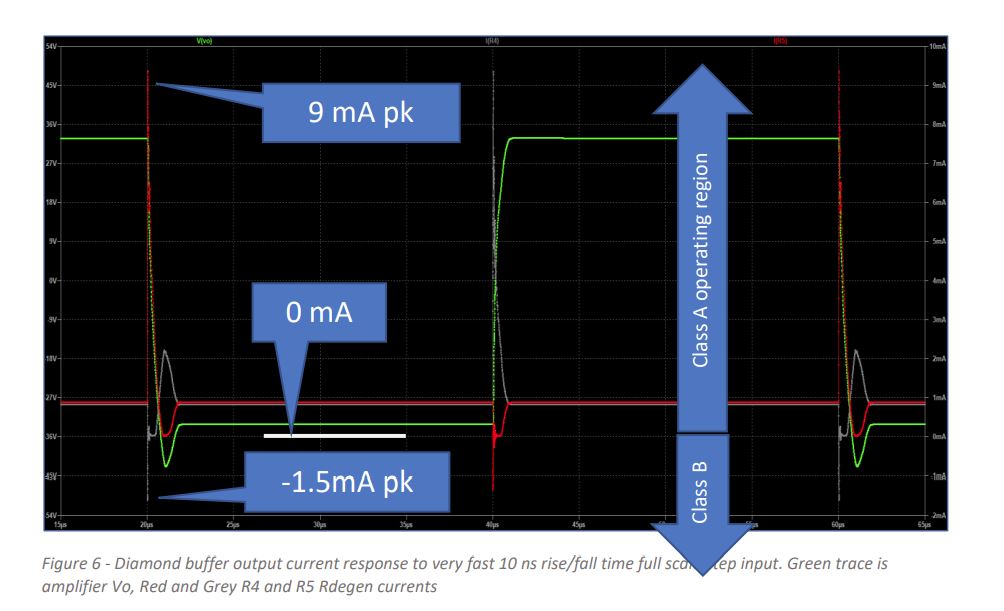

Anyway, in my rebuttal I show plots and also why the DB is a practical power amp never leaves class A.

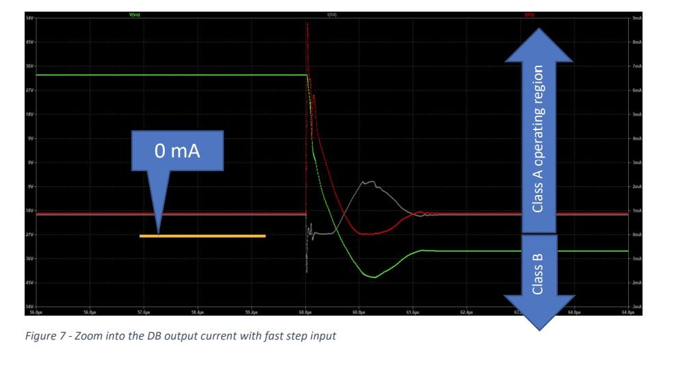

No, that is not correct for a power amplifier. In my rebuttal, I point out that in IC amplifiers this may bell be the case - the IC DB gm is very high, little or no emitter degeneration is used in the DB output pair with designers instead relying on the closely matched device parameters you can only get in an IC fabrication process to achieve the good DC balance and tracking you need if you are to dispense with the degeneration resistors. In this type of device, the DB may well transition to class B (I don't know, I have not analyzed it or sim'd it) and is somewhat analogous to an undegenerated VFA long tail pair where very fast high input signal transients cause one of the input devices to switch off while the other conducts the full tail current.
In all my CFA power amps, the gm is lower because the degen resistors are 150 Ohms - this to ensure the DB is well balanced at DC with device currents all set to 1mA because the voltage drops across the 150 Ohm resistors swamp Vbe differences by a large margin. It is still possible to build power amps with this approach with 250V/us SR's (see here https://www.ovationhifidelity.com/product/model-1721/). The DB output current can go >8x the standing current and still remain in class AB for all signal levels over a bandwidth up to 250kHz. (Note I use the term SR but it is more accurately described as rise/fall time since CFA's do not SR limit in the same way VFA's do).
You can see in the plots below that with a 400 kHz BW limited amplifier and 2us rise/fall time stimulus (already much wider BW and faster rise/fall times than you will ever encounter in practice) the amplifier remains in class A. You only go into class AB with ultrafast rise/fall times and not input BW limiting filter.

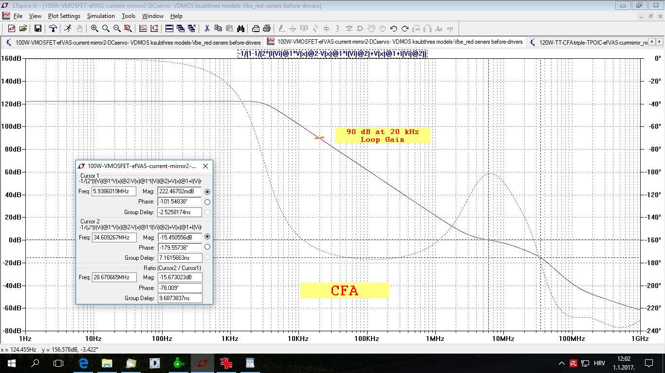

Anyway, there are plenty of high loop gain CFA designs on the forum - see dadod for example- if that floats your boat.
How much loop gain do you need? A good modern amp will be about 0.5% open loop, place 70 or 80 dB loop gain around that using TMC or similar and you are at 10-30 ppm distortion at close to full power at HF. If you need much more loop gain than this to get to the figures I mention, then you have other issues. Surely getting low distortion with minimal feedback should be the goal we chase, not huge amounts to try to correct a flawed design?

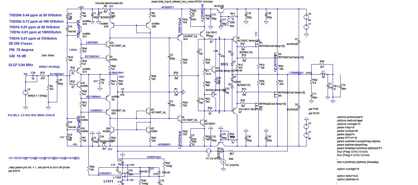

This is one of CFA with high LG, is this enough high?![]()
