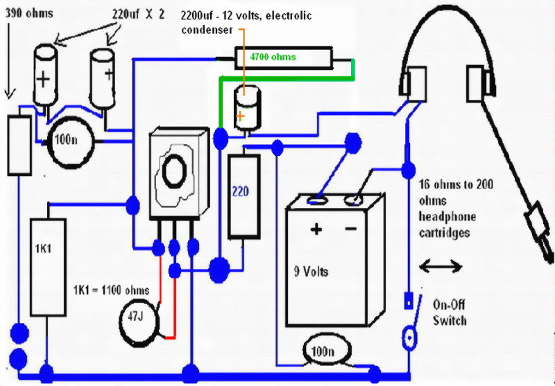

I just made a PCB for the circuit with some bd135s, just used a sharpie marker on the pcb lol. This one is using cheap components... lol the oscon caps on the first protoptype are like twice the thickness of these, not to mention the giant paper caps. (So I needed a new model which was more suitable to go in the small case i have...)
This one looks like it will fit, have space for 3 batteries and the output and powersupply caps which I left offboard...beacause they are even bigger than the other components.
Just makeing some holes in the case to fit the sockets etc should be ready in an hour or so.

Ok , all done, except I must still make a hole for the power slide switch... this one handles much better at 9V (bd135), but the noise floor is much higher... the background noise on the other one was much less... will swap the transisters later on to see if its just the cheap ceramics and electros that I slapped on the little PCB... its tiny, maybe 1inch by 1 and a half.
Also I'm listening to the PC right now, so I don't know if the noise comes from the PC... it sounds like a 50Hz PSU noise if you know what I mean... but its hard to hear when music plays.
I think the output current is more suitable on this transistor as the headphones aren't being killed by the bass.... (does it have less gain?)

Ok, my ipod, I mean wife, is home....
So I can do some testing before changeing anything.
It is definatly better suited to the stock ipod earphone... driving considerably more bass than without the amp, but not distoring as much due to overpowering the earphones.
The 50Hz sound is gone, so I was right to assume it comes from the pc... I wouldn't say it is as quiet as the first one I built with the better quality components.. I will build that one into a bigger case with a well filtered mains supply for use around the house.

DO you think those resitor values are optimal, or can you think of anything else that could cause the noisefloor.
Oh wait, I swapped earhpones while typeing, ow listeing to my big set, and it sounds nice and laidback in a sexy way, I think the little ipod phones may be too sensitive... posibly a highpass filter could try to keep the output more inline with the headsets actual abilities to produce low frequencies (which I know is not an issue on decent earphones or rather headsets).

Those resistors are optimal to gain 130...but not optimal to different gains
To different gains, the up resistor need to be connected directly to the colector and recalculated.
Noise floor is different now..... very interesting....may be the famous transistor noise...interesting that you are listening it...maybe from the source, because i think the circuit, by itself, will not generate too much noise, as it is a single transistor and current is very low.
But maybe you are discovering something that will be interesting to me to know..... this BD135 sounded less powerfull and with more noise...interesting Nordic.
Continue to send your observations when making changes.
Have you checked the voltages from Base to ground and from colector to ground?
Observe please, Nordic, the change related the value or the colector resistor (the load) and the new connection made with it.
This will turn the circuit less problematic if you replace transistors with other gains than 130

Carlos, I'm speaking under correction as I allready closed the case and gave it to my wife... will open it again tommorrow... but I think where other circuit measured close to 5V this one was about 3.5V.
I used a small white pvc case added two 3.5mm sockets, a green power LED and a black slider switch.
I would be lieing if I say there is 0 distortion... I would say the sound is 95%+ pure... but, there is very little distortion when using regular headphones.
The noise floor is also not realy a problem, I thought it was very bad at first when I used the PC as a sound source...but its just the crappy soundcard. I have had a warfedale mp3 player with more noise.
My wife and I both like the headphone amp, I'll try a few other circuits now for comparison as and when I get time.

My conclusion was that the bd135 was more suitable for driving small earphones... the 139 was too powerfull. I have very slight noise on the bd135, still, but its only audiable during silence.
Oh and the fact that the 135 copes with only one 9v battery makes it more suitable...

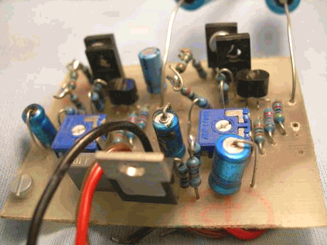

Here is my first HeadPhone amp, built some years ago.
It was used with Sony Fontopia ear plugs (low impedance)
small but with an excellent sound = extra bass.
Details of my first HeadPhones Amp:
- 12 VDC onboard one LM317 regulator
- Two channels on one card share LM317 supply
- Properly decoupled near each channel circuit.
Each channel:
- Two BC550 differential input, resistor set bias in this long tailed pair
- BD140 second stage, with 2 resistor divider set gain
- feedback taken from this stage
- BD139 output voltage follower
- 3 x 1/4 watt metalfilm resistors bias output to ~80 mA idle current
- Input and output uses Capicitors
- Each channel has got a potentiometer,
- for adjust of output working point (originally set at ~9 Volt across 108 Ohm)
I will post some pictures!
With short description.
