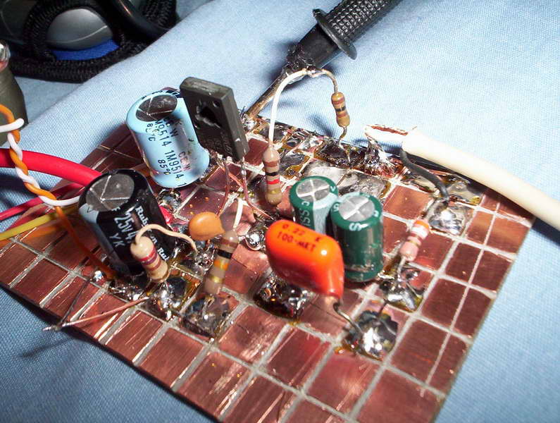

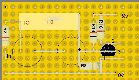

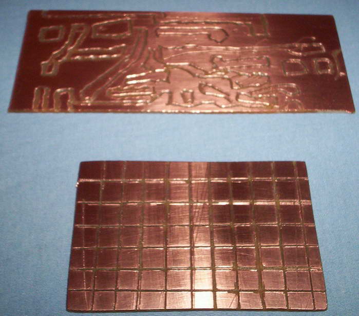

I promise to build one tommorrow.. must just go and buy a few of the resistor values and the 2 transistors... already got some nice sprague 220uf caps (donated by Franz Gysi), I guess 10V would be enough there?
I attached a matrix board layout for one channel?
Would you please check if I got it mostly right... I just used the picture of a regulator instead of the proper transistor, but marked the pin numbers.

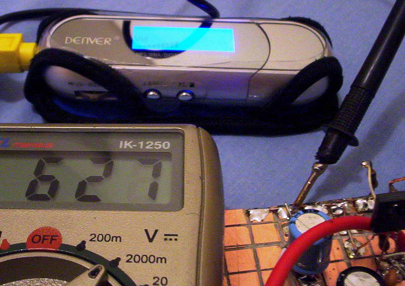

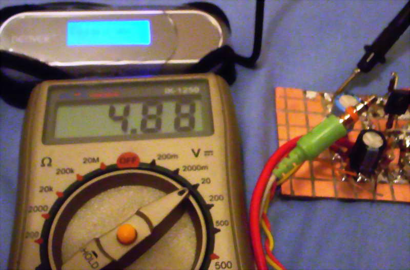

The current gone to 12.8 miliamps after some "adjustment"
The upper base resistor was changed by a 10K ohms
The lower base resistor was changed by a 1100 ohms....1K plus 100 ohms resistor
The VBe voltage gone to around 620 milivolts.
The Colector voltage to around 4.98 volts
And sounded great...can be used, and it was used with 16 ohms output..... the output was colected after an electrolitic condenser...not the real wonderfull sound we have when we install things in series with the colector...having current going in...yeah...sounds good!.... of course the current drives a little the diafragm....the speaker, the headphone cartridge...moves a little...but you continue to have room to move upwards and downards.

Hi Uvodee...pics...yeah!...more pictures will be posted here

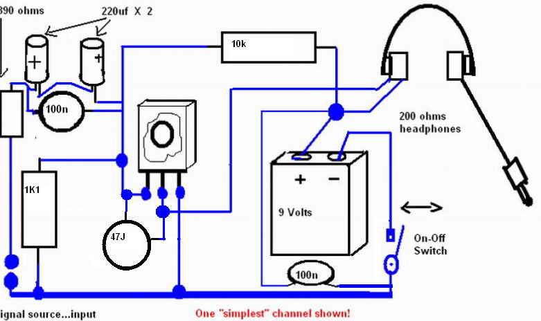

This is the circuit constructed...guaranteed, using Gain BD139 transistors with 130 of gain.
This one was tested...it works!
Nordic...my dear Nephew...please, use this circuit corrected (adjusted to real world...hehe)

Ok, will do the updated circuit
I have allready started soldering... on the first one... only got the oscons and 2 resistors on so far.

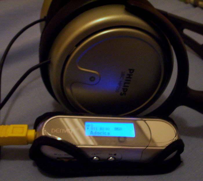

This headphone sounded good..the Sony one did not sounded good.
The problem i had with the Sony one was the very small driver inside....could not reproduce deep bass...and having deep bass going to it, turns distorted.
The Philips one did not distorted.
My beautifull Senheiser is not here...my friend Paulinho is using it, as he loves to Sing popular musics in his home.
No!...negative!.... with the output condenser, nor the sonic qualities nor the power could be compared with the same idea using headphones in series...the perfect coupling...nothing between them....

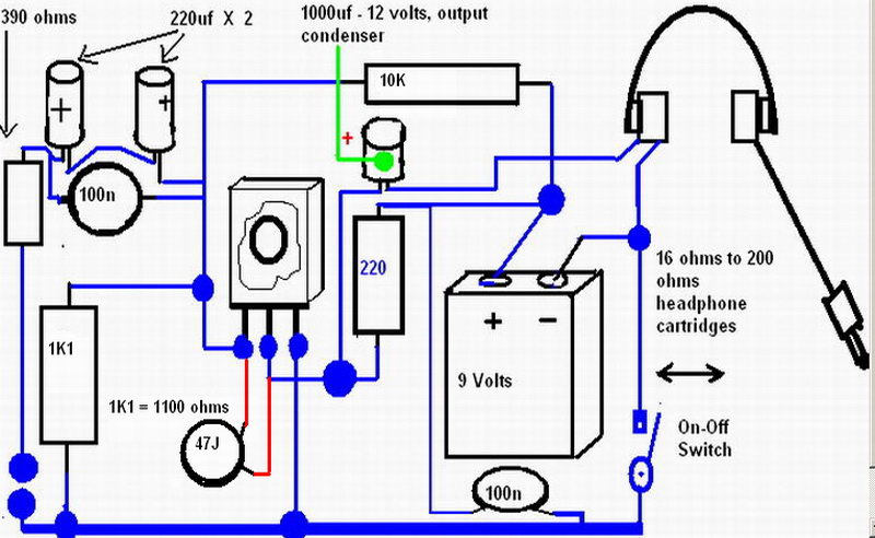

Nordic, your headphone impedance informed was very low.
So, do not install it in series with the colector...use a big (1000uf) electrolitic condenser, and fix the colector resistor with 220 ohms.
In the future, if you have a headphone with 200 ohms impedance..then, install the headphone coils in series with the colector..in the place or the 220 ohms resistor....and the electrolitic condenser will not be needed too.
Use, please, this schematic that was tested...observe that it has a capacitor (Ceramic or Silver Mica) from Colector to Base.
regards,
Carlos

Thanks carlos, I saw the extra 100n cap, and was going to add it as part of the previous design anyway...
