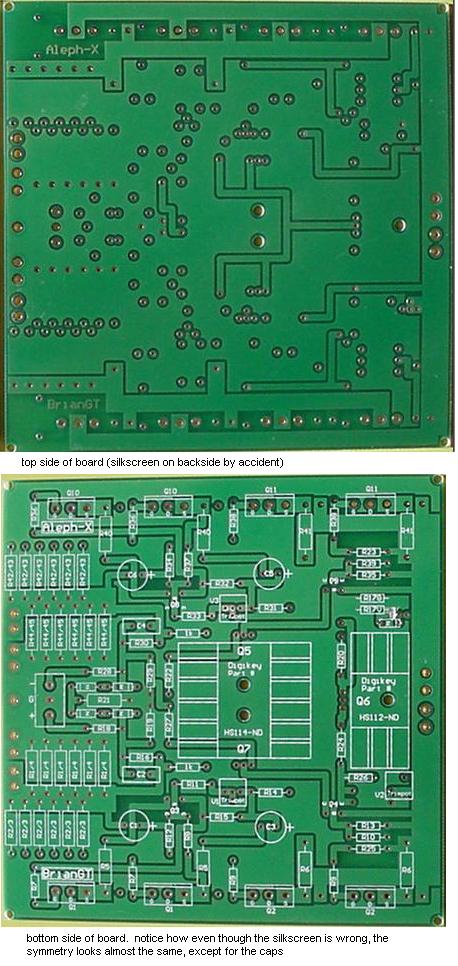

Aleph-X PCB any left
Hi BrianGT. Do you have any Aleph-X PCB left, see image. Thanks...

Re: Aleph-X PCB any left
Man.. actually, I never actually made those PCBs. I created the layout, and posted the gerber files on the internet 🙂
I can do a better layout than that 🙂 Let me see what I can work up. That is an old one!

Re: Re: Aleph-X PCB any left
-Brian
Awesome. I'm very interested. Will you get boards made or just gerbers?
