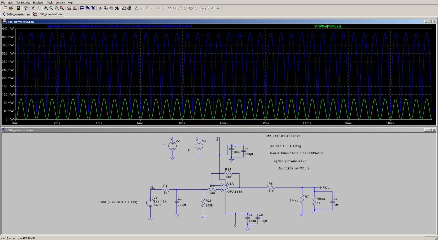

I tried the ltspice model. With 50mw into 32 ohms with +-9v supplies, the opamp single channel seems to be dissipating about 290mW. That doesnt sound right to me.
Sounds about right.
Just a quick estimation: power in the op amp is the voltage drop across the output transistors times the current through them. For 50mW, that's about 1.265 Vrms at the load. This means that there is 9 - 1.265 = 7.735 Vrms across the output transistors. The current through the transistors is 39.5mArms to deliver 50mW to a 32 ohm load. So the power dissipated is P = I*V = 7.735Vrms * 39.5mArms = 305.7mW
And now you know why high supply voltages are not really a good idea with low impedance headphones. They cause excess power dissipation in the op amp.
