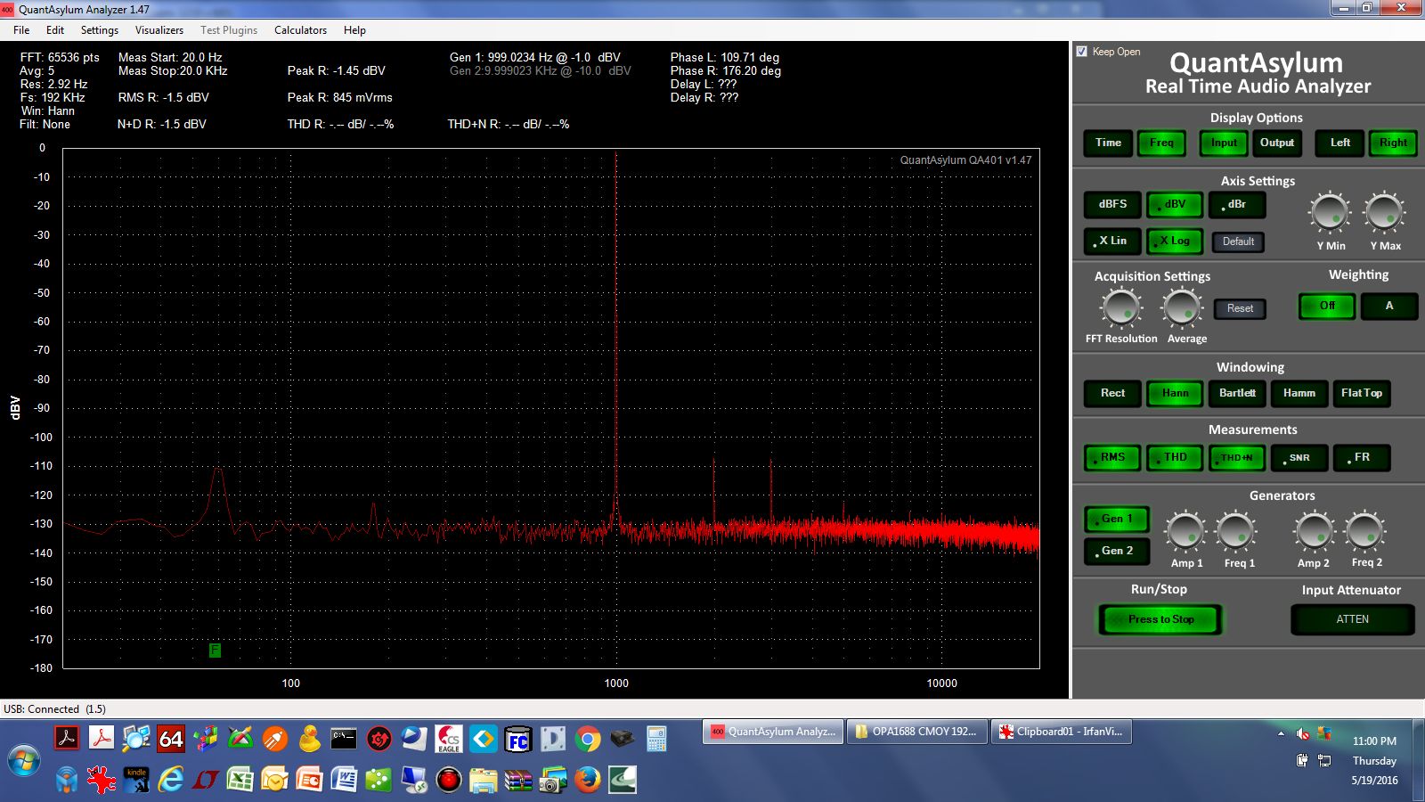

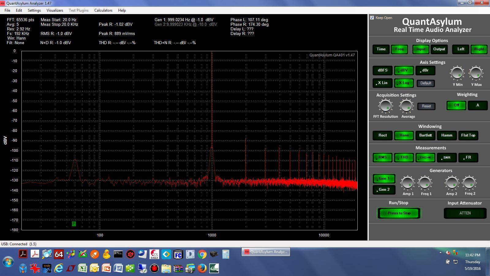

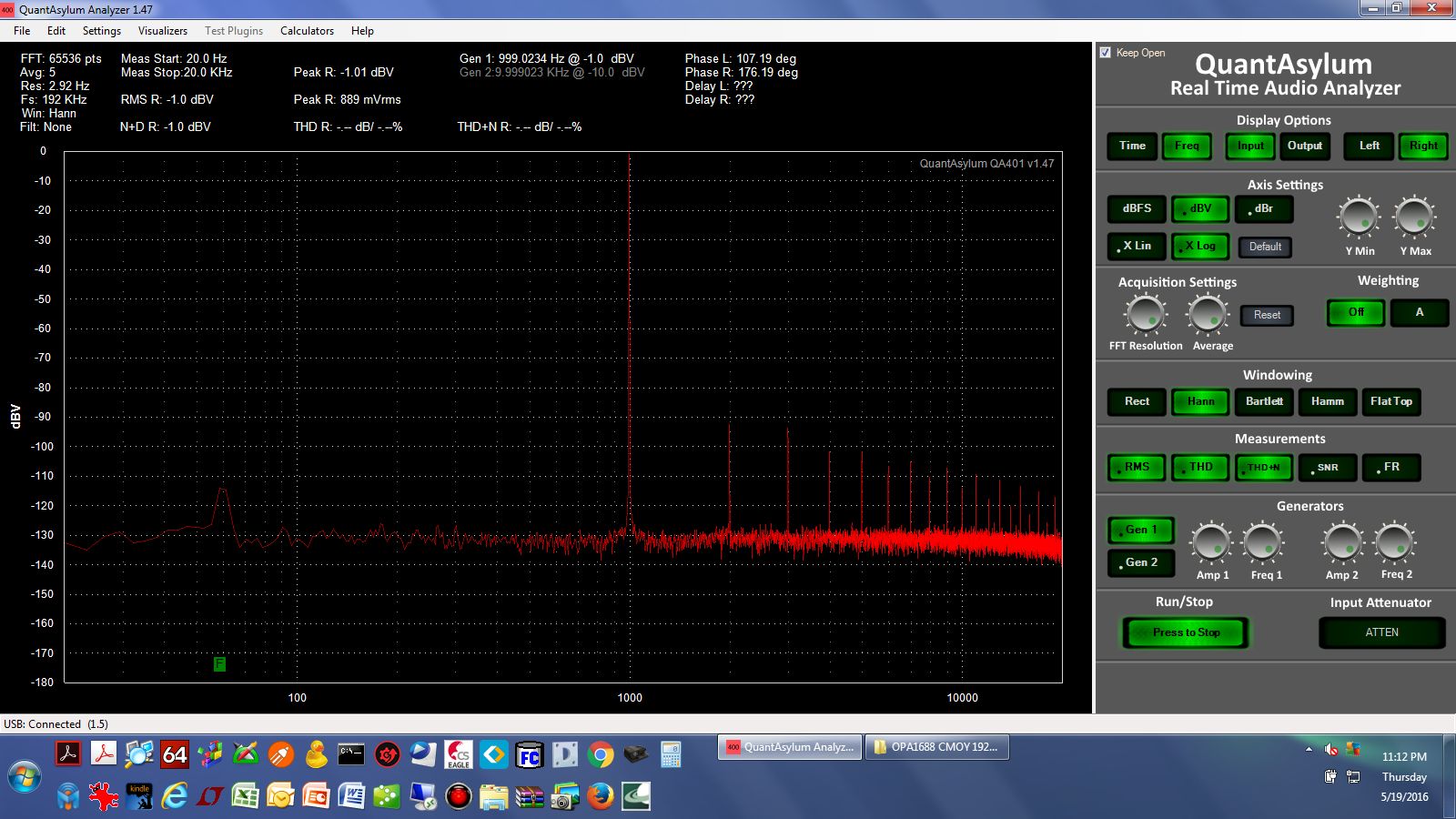

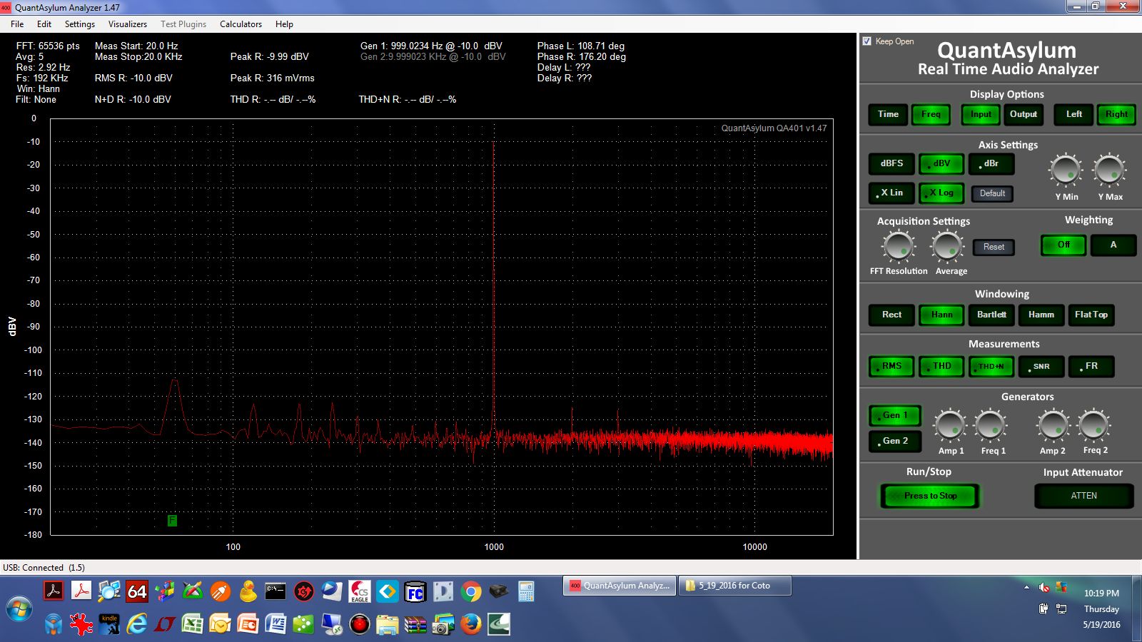

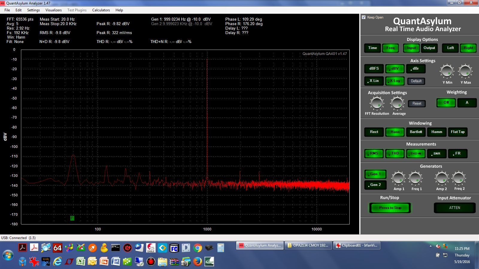

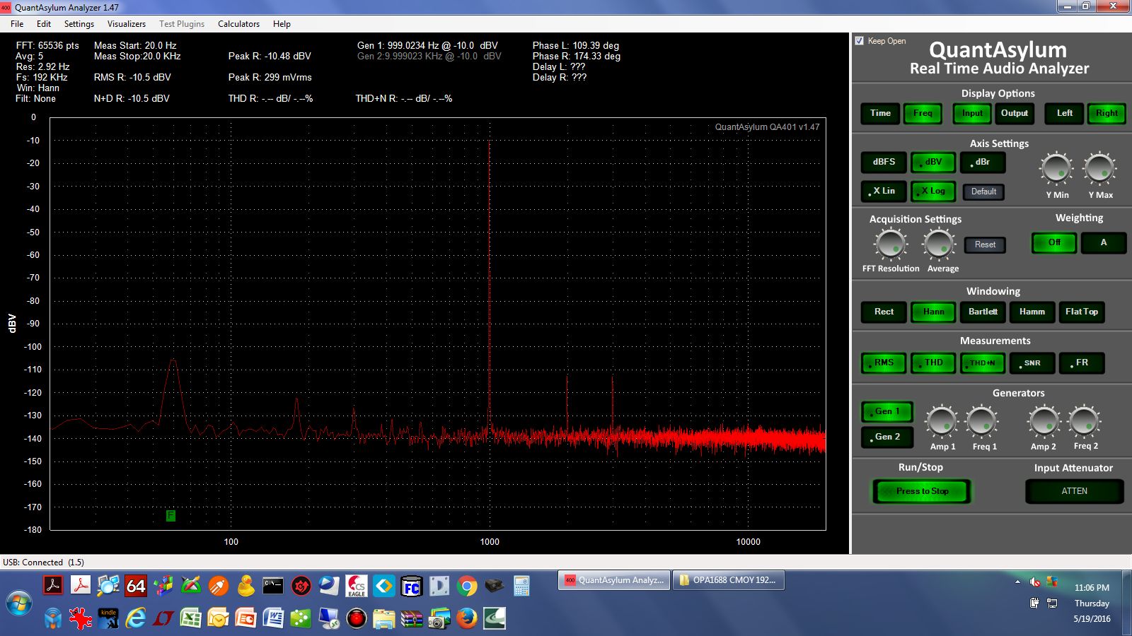

Well I found the problem! The large harmonics are not due to the rail electrolytics after all. Somehow I managed to damage one channel of the OPA1688 chip around the time I installed the electrolytics, which is the source of that huge 3rd harmonic when the 32R load is attached. The other channel of the chip works just fine.
How I tracked this down was swapping the 22uF rail electros for 22uF X7R MLCCs. The results were exactly the same as with the electrolytics, the huge 3rd harmonic, which seemed very fishy. Then I bypassed the solid state relays between the batteries and the circuit thinking maybe that was a source, even though they are just 0.05R on. Well no effect, 3rd harmonic still there. So then I removed the 22uF MLCCs so it was back to no capacitors on the power rails and....3rd harmonic still there! Oops. Then I tried using the other channel of the chip and all is OK.
I've been doing quite a bit of testing of various types with the chip and board over the last week. I have no doubt the fault was mine at some point in damaging the chip. I use a grounded antistatic mat, wrist strap, iron tip, antistat tool grips, etc., but there is also a cat wandering around which kind of negates the whole antistat effort. 😛
At any rate here is a re-do below with the other channel on the OPA1688 chip. The previous 22uF power rail electros are soldered back in and the battery SSRs back in place un-bypassed. Same 32 ohm load. The input levels of the 3 are -10dBV, -1dBV and 3dBV. Looks great. 🙂 Again keep in mind this particular model of THD analyzer has significant 2nd and 3rd harmonics itself at higher levels, so the results from the chip are really pretty darn good, especially with the 32R load.
The rail eletrolytics after the power supply SSRs still do seem to make the turn-on turn-off pops more prominant, which was the whole point in trying them, so I'll probably be leaving them off the final board spin. Seems that just having the rails turn-on and cut-off as soon as possible with the SSRs is better than allowing the rails to linger with the electros on them, from a pop-reduction standpont.

Now this makes more sense! You're previous post was a bit of a head-scratcher for me because I had previously never seen rail capacitors add distortion. And normally distortion from power supplies tends to add even harmonics, not odd. But when it comes to debugging distortion, I try to keep an open mind.
The new measurements look great. I actually have a QA400 analyzer so I'm aware of the harmonics that pop up at 0 dBV and greater signals (still a great piece of equipment). It would be interesting to see how the OPA2134 compares in the same circuit, since that seems to be the op amp most commonly selected for CMOY headphone amps (despite not being particularly well-suited for low impedance loads).

Just suppress the main tone, one or the other way, and you will be happy for the rest of your life. 🙂
I agree! 🙂 This one had me going. Interesting thing, the "bad" channel sounds just fine listening to music. That is what makes me think it is static damage. From past experience it seems that mild static damage, or small overvoltage, may alter a few chip specifications but otherwise leave a chip functional, but with a short(er) lifespan.

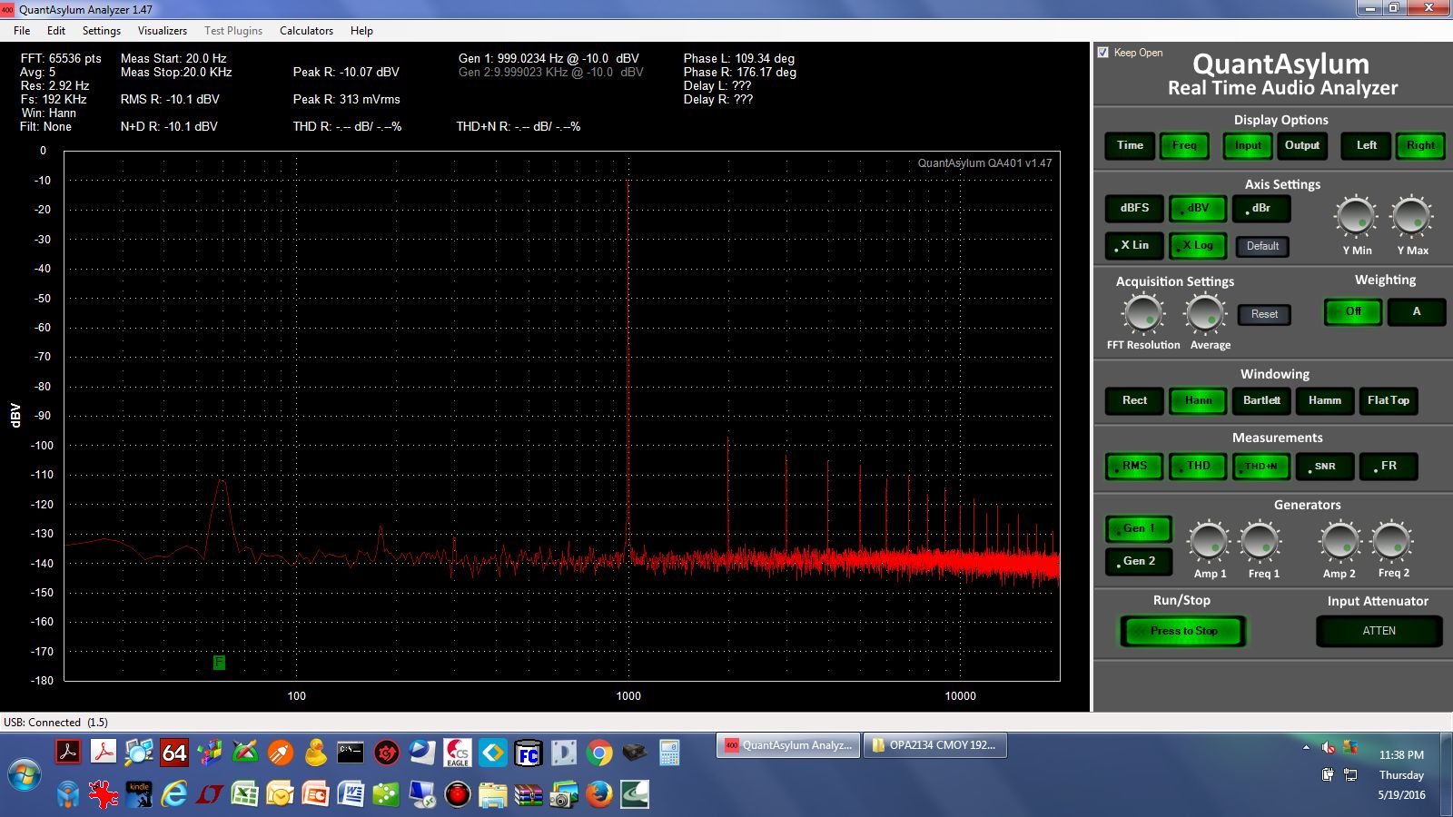

Here is the answer. 🙂

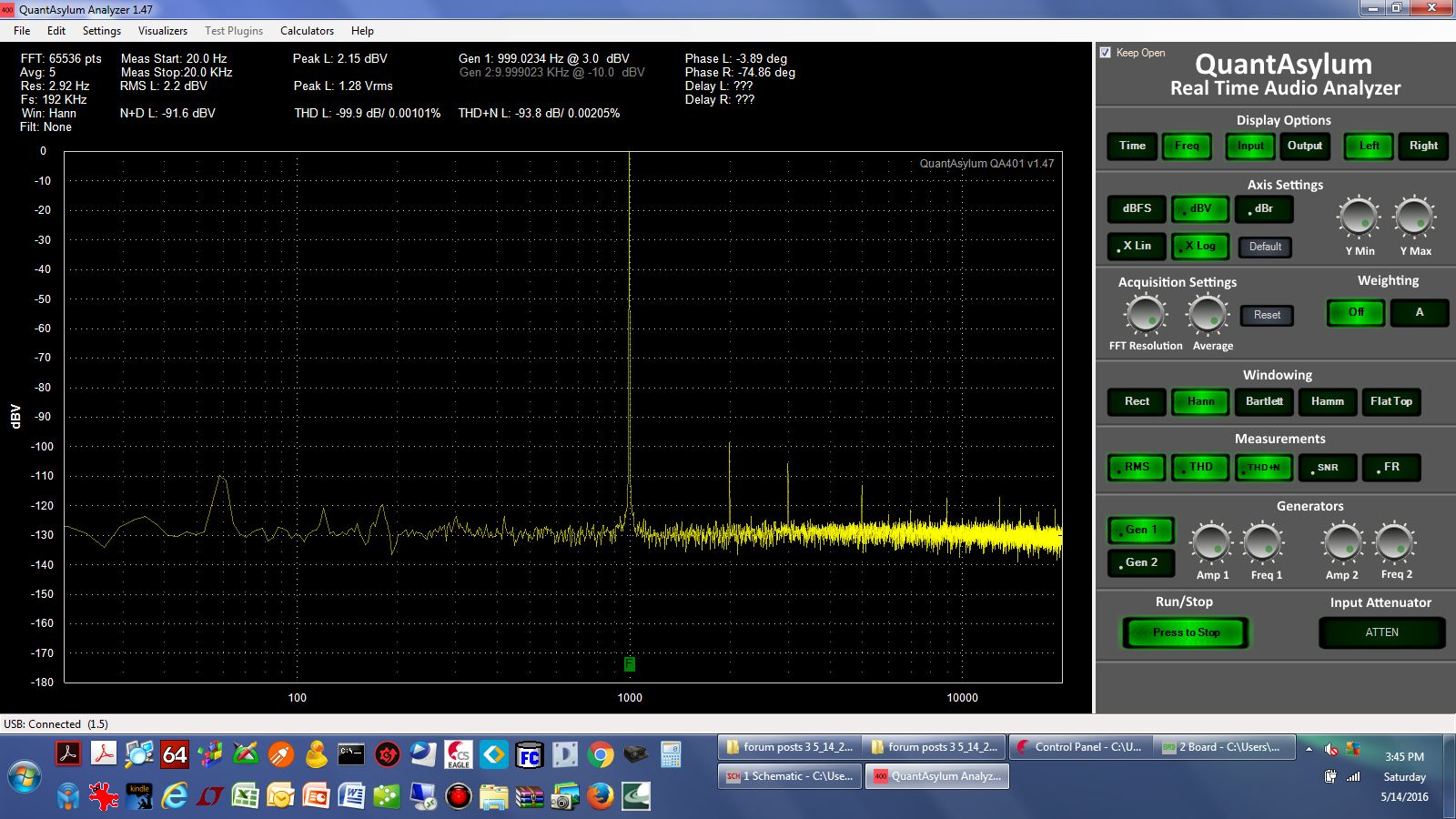

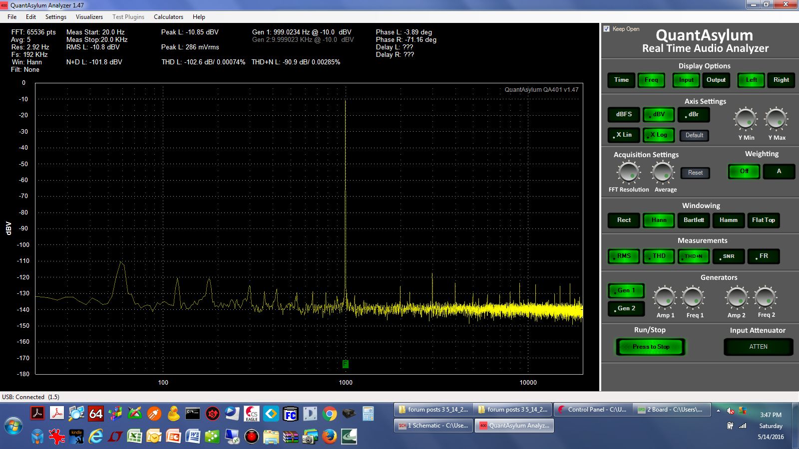

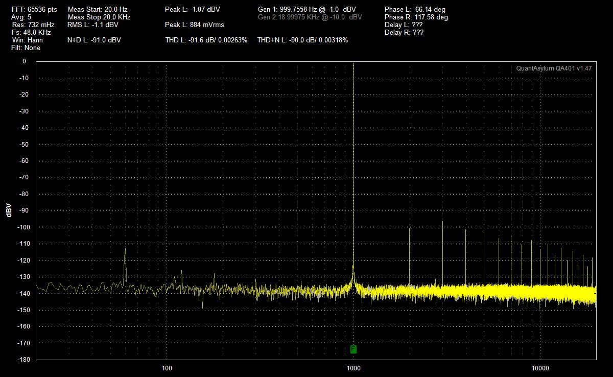

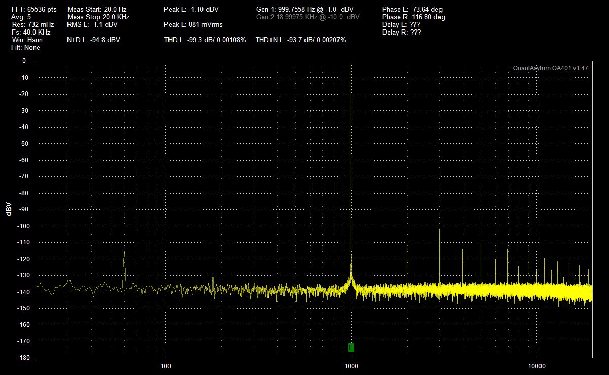

I've replaced the OPA1688 chip with the damaged channel with a new one, on one board, then built up a second identical board with an OPA2134UA instead of the OPA1688. Luckily the pinout is the same. I'm going through the plots here from left to right and top to bottom in the discussion. Mousing over the plots will also bring up the file name that has the parameters.
* The first two plots on the top row are the OPA1688 board with no load and the OPA2134 board with no load, both at -10dBV in and (amp adjusted for) out.
* The next two plots on the top row are the OPA1688 board with a 150R resistive load and the OPA2134 board with a 150R resistive load, both at -10dBV in and (amp adjusted for) out.
* The next two plots are the OPA1688 board with a 32R resistive load and the OPA2134 board with a 32R resistive load, both at -10dBV in and (amp adjusted for) out.
* The next two plots are the OPA1688 board with a 150R resistive load and the OPA2134 board with a 150R resistive load, both at -1dBV in and (amp adjusted for) out.
* The final two plots are the OPA1688 board with a 32R resistive load and the OPA2134 board with a 32R resistive load, both at -1dBV in and (amp adjusted for) out.
The OPA2134 generates substantially more harmonics, as expected, especially at the -1dBV drive level and heavy 32R load. Lol the OPA2134 was getting hot enough with the -1dBV/32R test conditions that I only left the load connected for about 10 seconds to take the screenshot. The OPA1688 didn't have that dissipation problem at -1dBV/32R.

Hmm, the OPA2134 getting hot makes me suspicious that it wasn't stable. Did you check the output for oscillation with an oscilloscope? Maybe doing a small signal square wave test?
The increased harmonics on the OPA2134 isn't a surprise though.
Edit: Alternatively, a good first check might be just measuring the DC offset at the output.
The two op-amps differ in quiescent current. That difference is about 4mA total/package. Thus the total difference in quiescent dissipation will be 4mA * your total supply voltage. In your application that should be the only difference in power consumption between the two amps. The dissipation that occurs in the devices as a result of driving the load will be identical and likely the majority of the difference. If the OPA2134 is significantly hotter something else is going on -- mis-wiring or oscillation.
Edit: I assume you're using the same package for both parts -- e.g., a '1688 with thermal pad soldered to a PCB with a good ground/power plane will not get as hot as an OPA2134 which doesn't have this. If both are in SOIC as I suspect, then the above comments apply
Entirely possible! I'll whip out the scope in a day or two and check. I used your 47pF for compensation on both. That was going through my head at the time that 47pF may not (probably not) won't be enough compensation for the OPA2134. I figured I would start with the 47 then go up if it oscillates.
I should leave it running longer with the 32R load too and use my mini-IR gauge or a thermocouple to find out how hot it really is. The heat level is probably OK, hot but not at "burn the finger" level, at least after just 10 seconds. 🙂 Lol I just chickened out after 10 seconds because I wanted to get a set of tests results recorded before anything fried and I had to take time to replace a chip. 😛

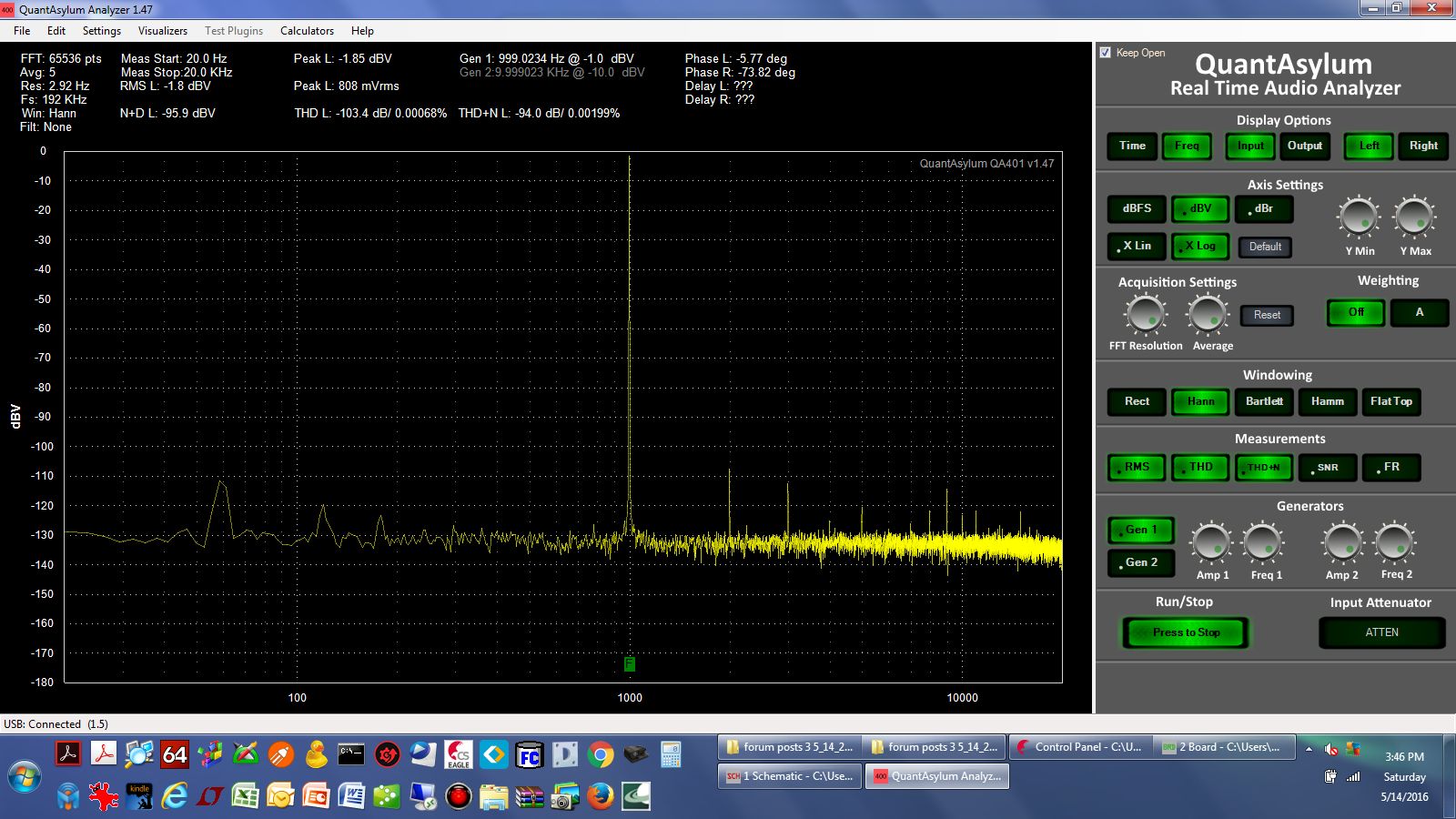

So attached below is the "reality" of rail electrolytics vs. my previous post, they do actually seem to reduce some harmonic distortion products, especially when the OPA1688 chip is run with heavy (32R) loads. I received the capacitors I had intended to use on the board from Mouser (the prior 22uF was something I had on hand). These plots are with a 100uF 16V solid organic polymer electro with a very low 35mR ESR (Mouser #647-RNE1C101MDS1PX). Then I also received some more conventional 100uF low 300mR ESR electros in the same form-factor that I haven't tried yet but will (Mouser #667-EEU-FR1C101B).
The testing effort hit a speed-bump when I discovered (another thread) that the QA401 in loopback had considerably higher THD on the left channel than right. Some email exchange with the manufacturer ensured and it turns out that is a known thing, the fault of the DAC being used at the 192Ksps sample rate I was using at the time. It doesn't do that at 48Ksps (much lower 2nd and 3rd harmonics at around -123dB vs -117 at 192Ksps) and they recommend using 48Ksps. The good news is the right channel is still pretty good at 192Ksps, and that is why the plots in post #37 above are red - red is right channel in the QA401. So all of this is why the plots below are now done at 48Ksps rather than the prior 192Ksps. 🙂
The first plot is with no electrolytics at all on the power rails, 48Ksps sampling, 65K window, -1dBV input and the output adjusted for -1dBV. The second is the same but with a 100uF solid organic polymer cap on each rail. If the 9V battery has 3 ohms of internal resistance that would be around 500Hz for the 100uF caps. Useful from 500Hz and up most likely. At 1KHz they would be around 1.6 ohms. The THD numbers are up at the top. -91.6dB THD without rail caps, -99.3 with.
No thermal pad on the OPA1688, interestingly enough! I just took a look at one to make sure. I have made that mistake before though. On V1.0 of a Fliege notch filter project here I used LME49880s which do have a thermal pad that I forgot about. I placed two traces right under the chip. 😱 A do-it-yourself capacitor between the traces via the solder mask.
You are right, there is a 2mA or so difference per amplifier in Iq between the chips, which should be somewhere around 2mA * (9V - (-9V)) * 2 amps = 72mW of extra idle dissipation in the old OPA2134.
