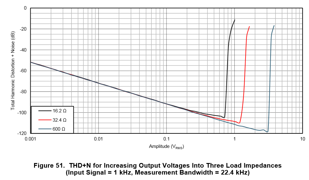

I wanted to know how well it drives headphone-sized load impedances. This is answered in Figure 51 of the datasheet, reproduced below.
_
Thanks for posting Mark. I just wanted to point out that Figure 51 was taken on +/-5V supplies. The maximum output voltage into 600 ohm headphones will be greater if the supply voltages are increased, as is shown in Figure 16 (taken with +/-18V supplies).

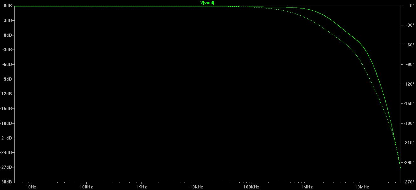

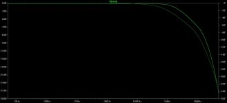

johnc124 - I might have found a typo in figure 49 in the OPA1688 datasheet (same diagram is at the bottom of page 1), comparing it with fig 52 in the OPA1622 sheet.
Fig 52 in the 1622 sheet uses 470pF which results in a 3dB point of around 441KHz, if I've done the math right, which would make perfect sense to preserve a flat 100KHz or so audio band. But... fig 49 in the 1688 sheet uses 47pF which would result in a corner of 4.5MHz. Probably not what you guys had in mind. I'll bet the 47 should be a 470.
Also something funny. I went to buy some at Mouser and found they had "SOIC8" listed for all 4 types, even the two VSON8. I reported it and the listing is correct now. Seems that Digikey is only stocking the VSON package.
I had a different goal with that little cap in the OPA1688 applications section. I sized it so that the downward slope it introduces in the inverse feedback factor curve happens right when it intersects the loop gain curve. This gives me a nice little boost in phase margin. Even more confused? I explain this idea in this document: http://www.ti.com/lit/ug/tiduaw1/tiduaw1.pdf . Scroll to the simulation section and read how I size the capacitor for stability.
Basically the same circuit, with some different resistor values. The moral of the story is that the cap in this circuit is there for stability more than bandwidth limiting.
The OPA1688 doesn't have quite the capacitive load drive capabilities of the OPA1622, so this little trick was necessary to give the design suitable phase margin.

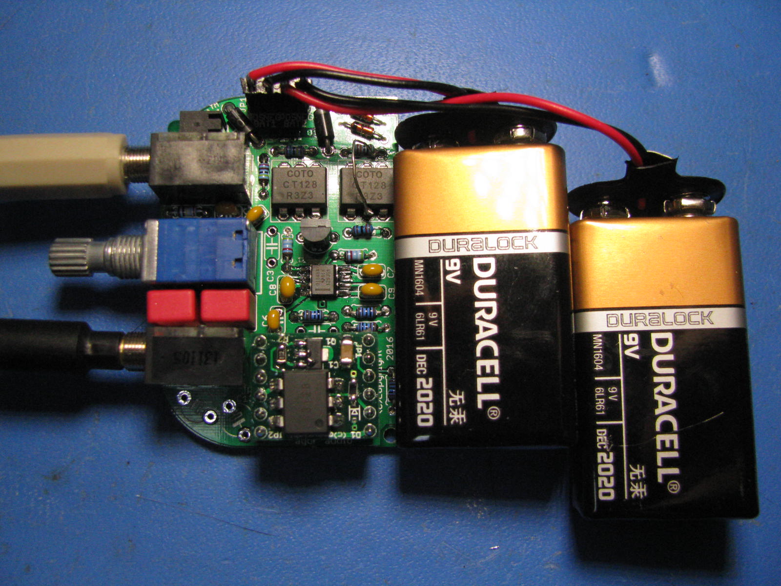

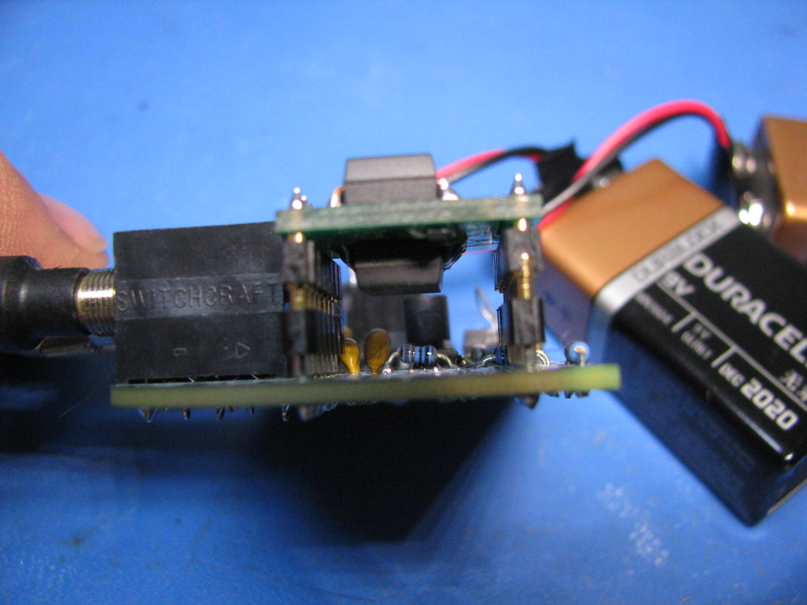

My board arrived back from fabrication today and I have to say the OPA1688 does sound terrific! I've tried it on a few different headphones and they all sound fantastic. Photos below. The meter is the DC output offset, 600uV! Pretty slick. There is indeed a small turn-on turn-off pop, but I've heard a lot worse on headamps. Small enough I probably won't worry about it. I still need to hook it up to the scope and check for oscillations. I used your 47pF, then 1K for Rf and for the resistor from inverting to ground, so a voltage gain of 2.
Hmmm... an alternate solution to the electros that would be less frequency sensitive would be LDOs between the batteries and circuit, if I could make some fit. Then the circuit would be looking back into the LDO vreg output Z.
Great looking project!!!

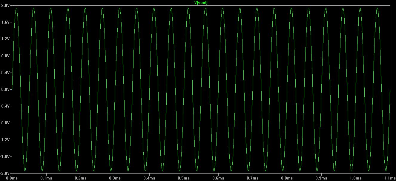

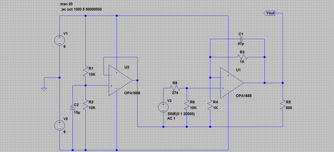

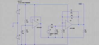

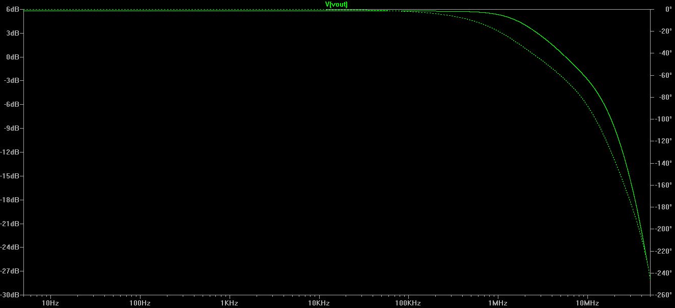

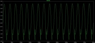

OPA1688 sims great as VG, OPA1622 not so much

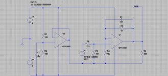

Well here is something interesting. I've installed the OPA1688 and OPA1622 pspice models from the TI website into LTspice.
In the first schematic, transient plot and AC plot below an OPA1688 is used for both the amp chip and the virtual ground. Sims great. This is at 20KHz with a 600R load. I didn't attach it but a 32R load also works just fine, with the expected slightly additional loading showing. Magnitude and phase flat as a board through 100KHz.
But... The second print, trans plot and AC plot are now with the OPA1622 as VG. The sim is not happy. The AC plot does fine but the transient plot has some sort of glitch near the negative rail. I've tried a few things but so far no luck on eradicating it. I'm just curious if that is purely a simulation model glitch or something present in the real chip when used as a VG. This is with 600R, the OPA1622 VG won'[t sim at all with 32R. Locks right up.

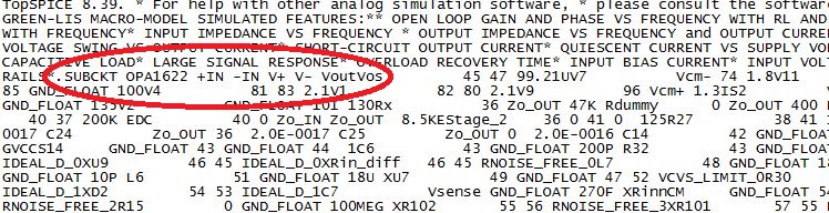

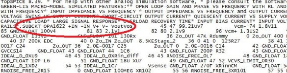

Also curious that the OAP1622 spice model does not appear to have a ground or enable! Snippet below. Enable I can understand, but I'm wondering how that model functions correctly without the chip's ground pin.
It looks like the OPA1688 might make a fine VG!

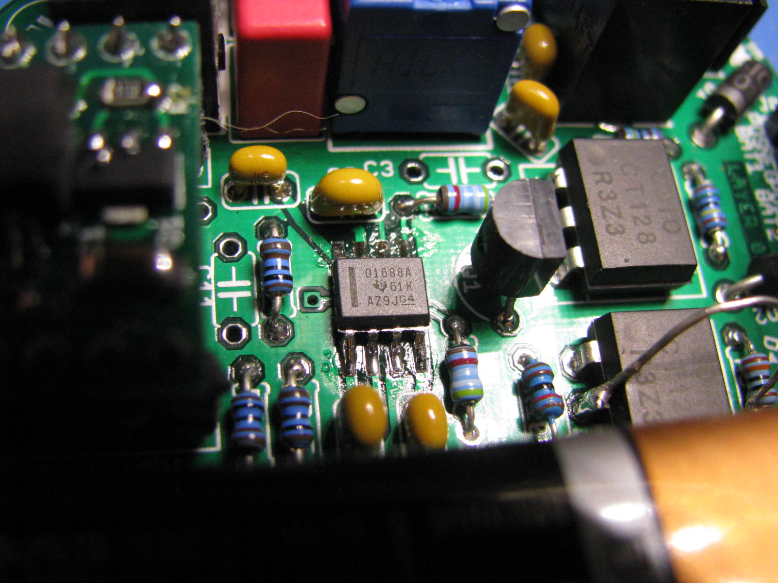

Fantastic sound from the OPA1688!

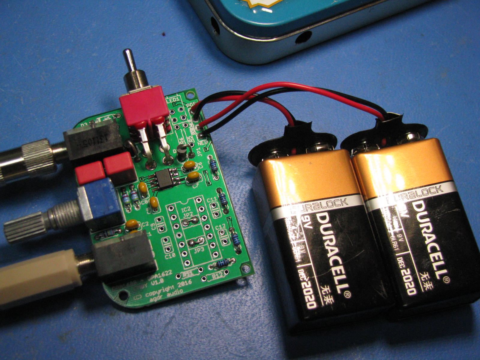

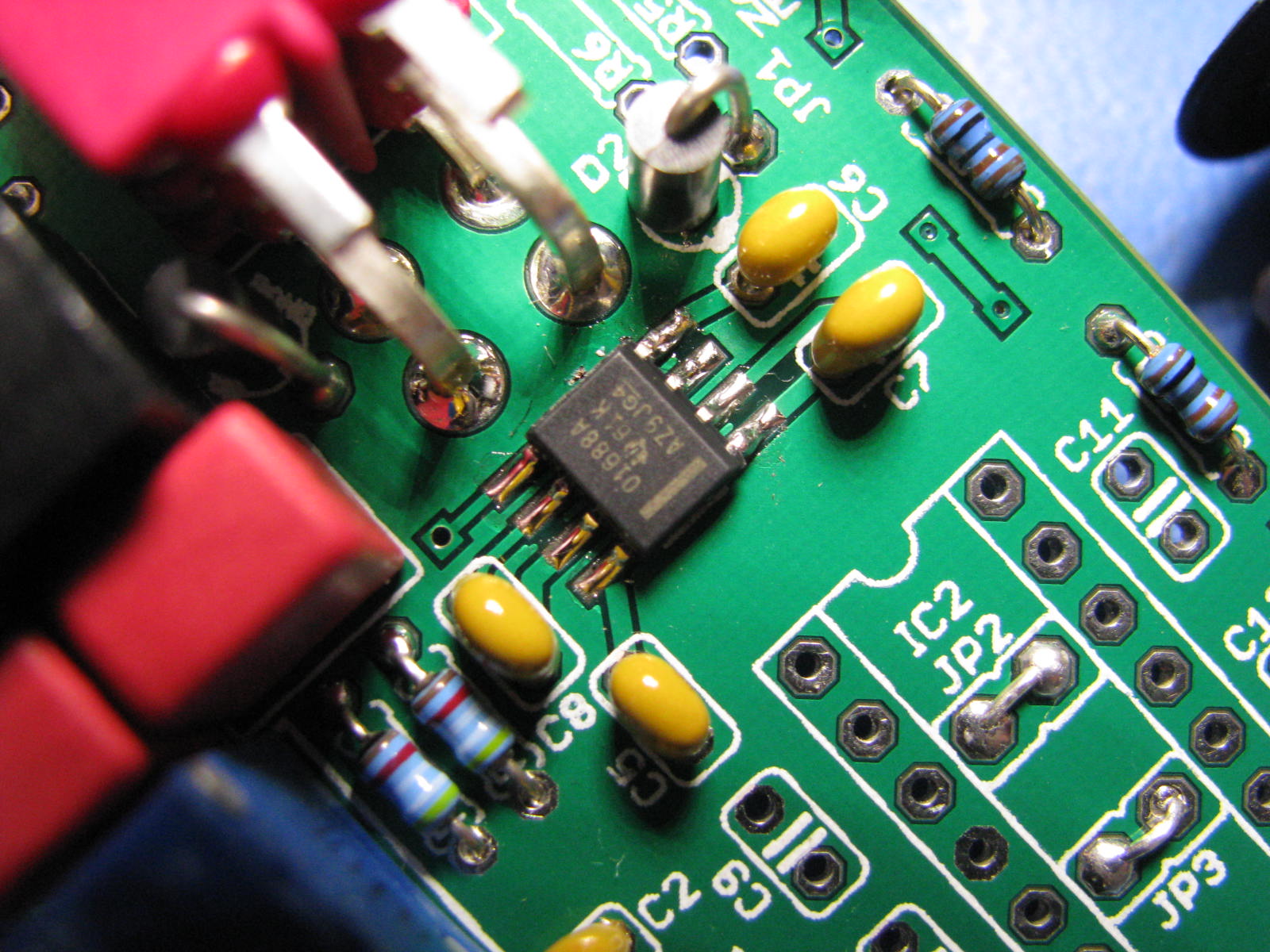

I've received a V2.0 board of an amp using the OPA1688 a few days ago and just finished the build and test. I've solved the dual battery issue by using solid state relays and a comparator to cut off the batteries if one "disappears" due to bad connection, internal short, protection chip cutoff, low battery, etc. Both rails switch at exactly the same time, which I've noticed reduced the on/off thump issue even without output muting. That is unlike NwAvGuy's O2 Headamp battery cutoff circuit using discrete mosfets with a slight delay between their on/off times due to the control circuit. No virtual ground needed - back to a true ground. I managed to find some SSRs with a tiny 0.05 ohm "on" resistance.
And the results - WOW! Not so much my circuit, the OPA1688 chip. In engineering terms neutral, in audiophile terms excellent bass, treble and finely detailed with a wide soundstage.
One hiccup, this one was optionally going to wrap around a plug-in OPA1622 chip/board. So far the LT Spice simulations I've done say that the looped combination is not stable, at least not without some additional compensation to restore some phase margin. So instead the plug-in board here uses two more SSRs as a muting circuit for absolutely zero turn-on thump and negligible turn-off thump. With the huge 75mA output per channel from the OPA1688 there really isn't much need for an additional current buffer anyway.
I would highly recommend the OPA1688 for headphone amplifiers. Good job johnc124 and TI!

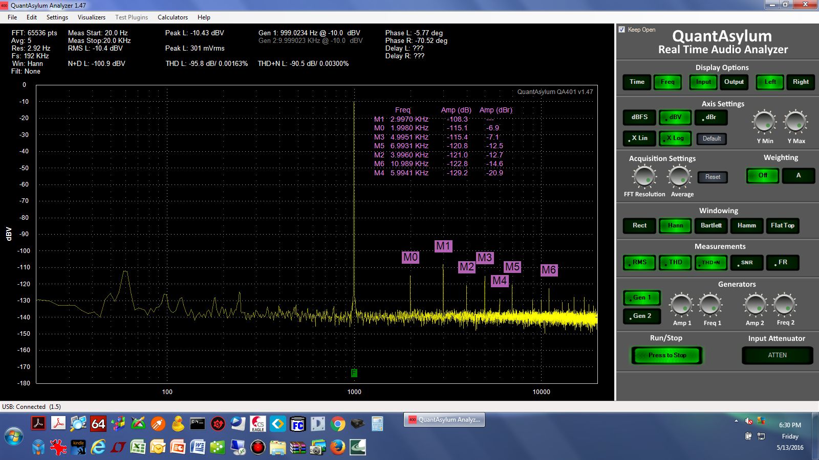

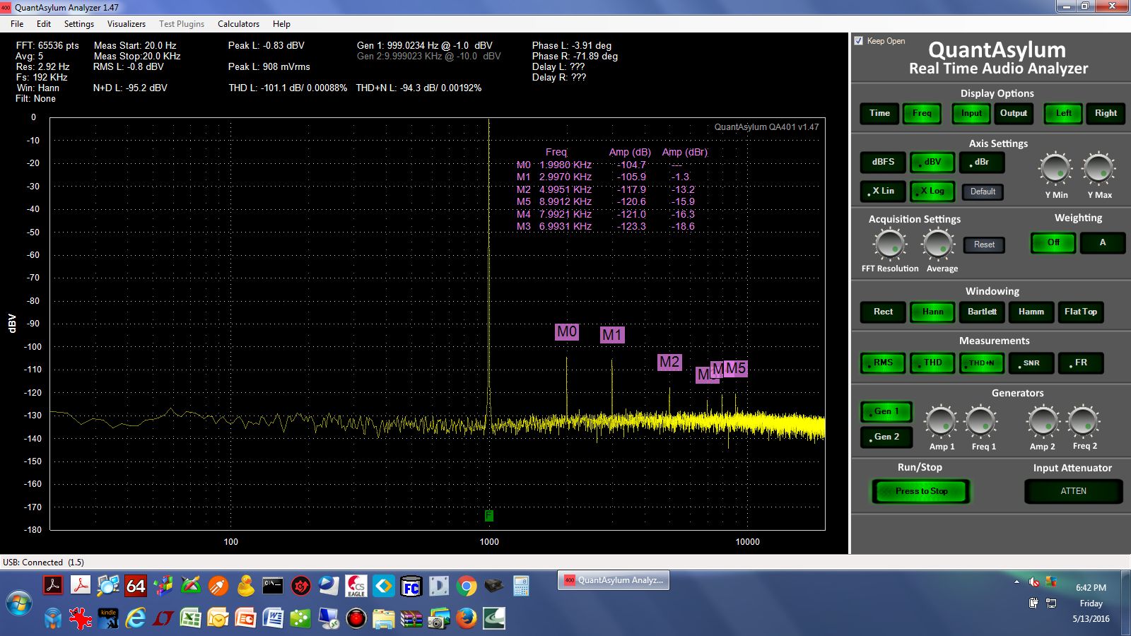

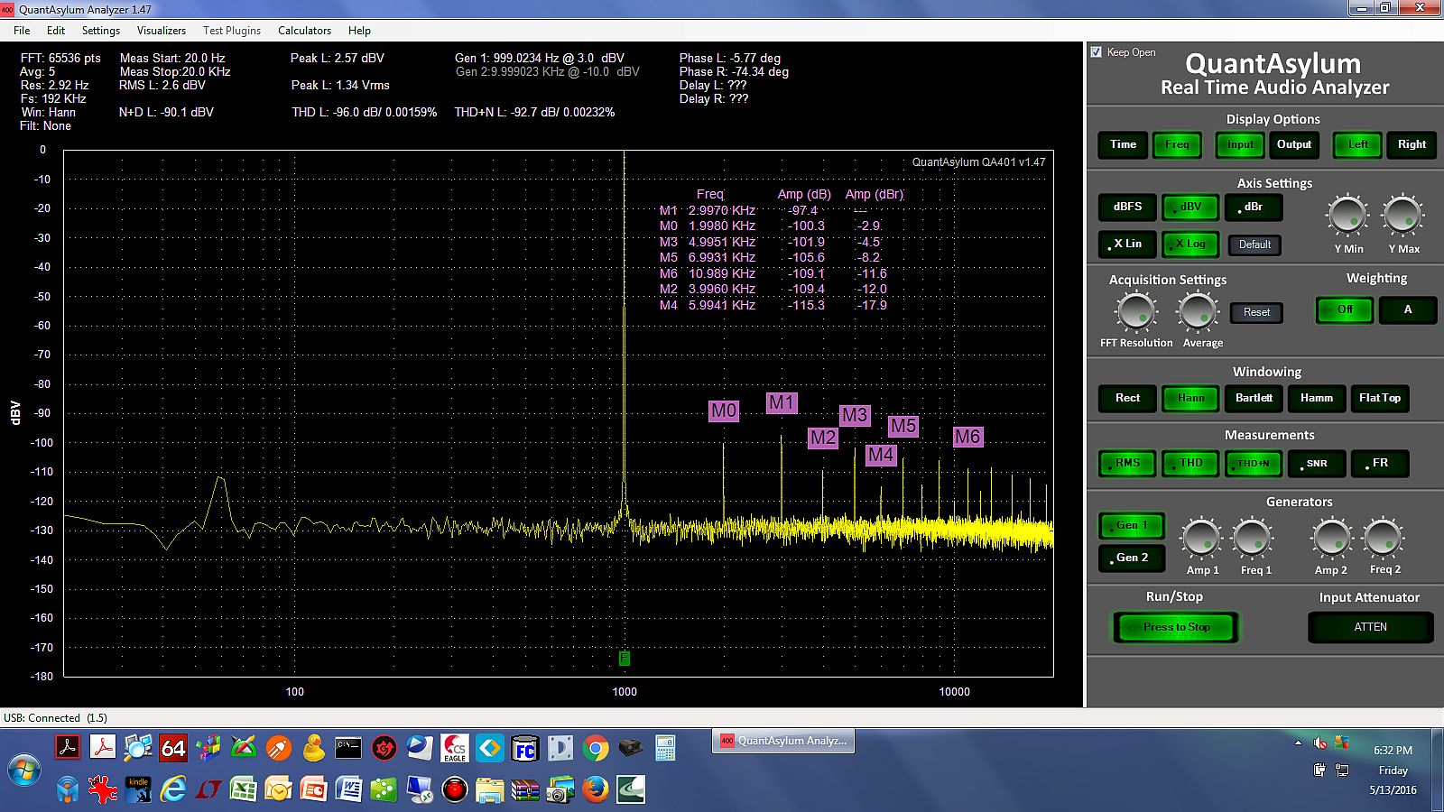

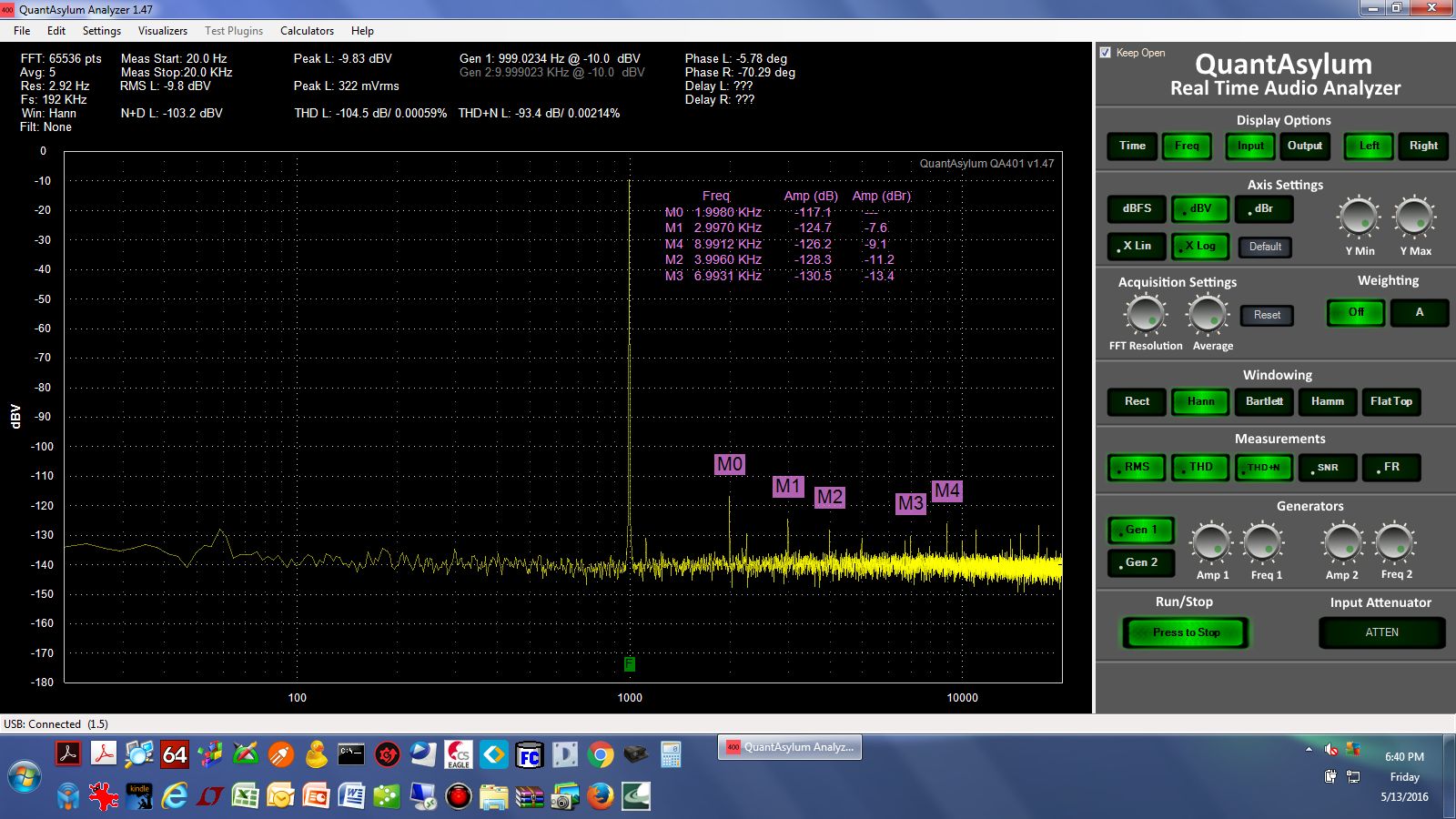

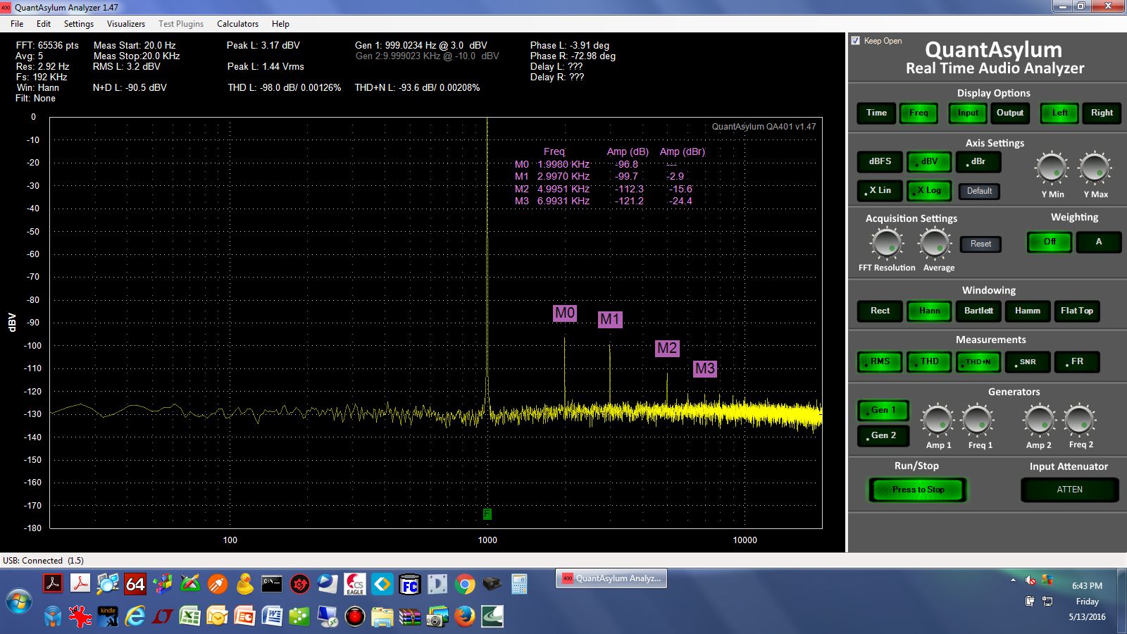

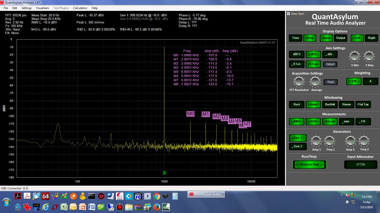

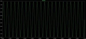

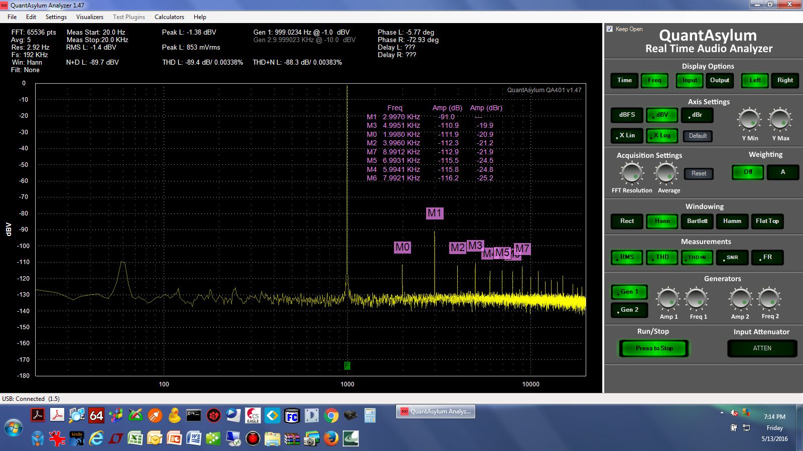

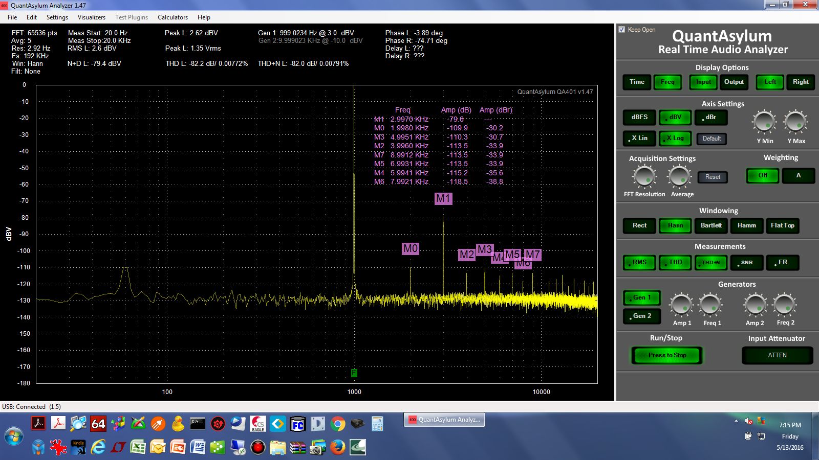

Electrolytics on the power rail increase distortion products
So here is a good reason to keep electrolytic capacitors off the regulated (or battery in this case) power rails - some increased distortion products. I finally had all the pieces together to do these tests today. A (2x 9V with real ground) battery powered audio amplifier using the OPA1688 and the new QA401 audio analyzer.
The first 3 plots below are the analyzer in loopback at -10dBV, -1dBV, and +3dBV. This particular analyzer already produces quite a bit of 2nd, 3rd adn 4th harmonics itself that have to be subtracted out of the results.
The next 3 are with the OPA1688 powering a 32R resistive load at the same 3 input levels: -10dBV, -1dBV, and +3dBV. This is with no electrolytic capacitors on the power rails, just the batteries going through a solid state relay with opto-mosfets.
Teh final 3 are the same as above, but with a 22uF 25V low ESR electrolytic capacitor added to each power rail. Wow.... In those last two, -1 and +3dBV, the capacitors seem to be taking some energy from the 2nd, 4th, 5th harmonics and shoving it all into the 3rd.
The thinking in adding the electrolytics was maybe they would help balance the rails during the turn-on rise and shut-off drop to help reduce pops. Nope, doesn't do that either, makes them worse. But the good news here is the pops really are not that bad to start with for the OPA1688.
Clicking on the arrows in the lower left of any of these will zoom them up larger.
