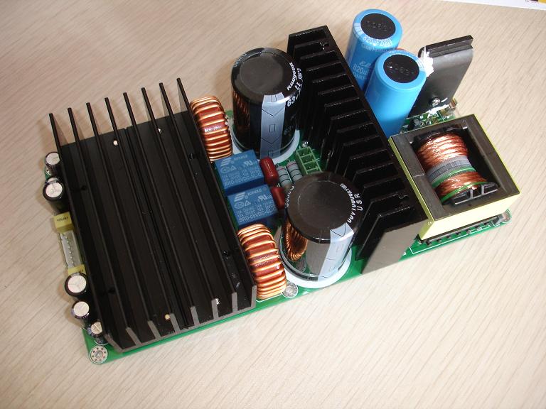

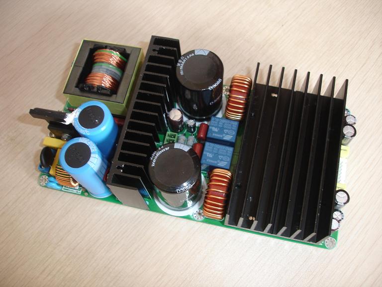

New version of the TA3020 amplifier will be released soon. here are some pics of the prototype. This new version has the speaker protection, and SMPS on board. it is a compact design, just 100x200mm and includes about all what is needed for a complete medium power (250-400W/channel) class T amplifier.
If everything goes according to plan (in most cases doesn't; according to Murphy's laws) in about 2 weeks from now. i prepare the boards and parts for assembly then after assembly and tests they will be available for sale. Then i will know the price also, since i haven't got the assembly cost quotation yet.
