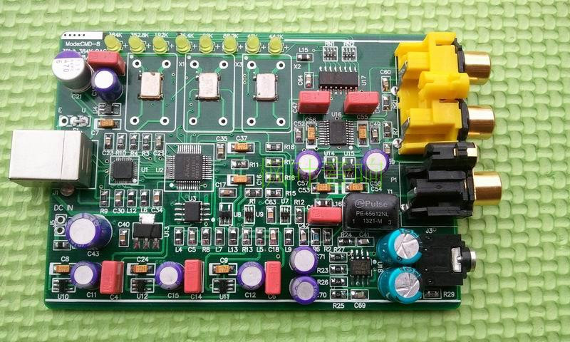

I did some pixel peeping and figured it is probably TDA1308.
Yep quite right, TDA1308
Thanks. I asked the seller and she said I would have OPA2132 in mine. I have placed an order and will report back once I receive it.Yep quite right, TDA1308

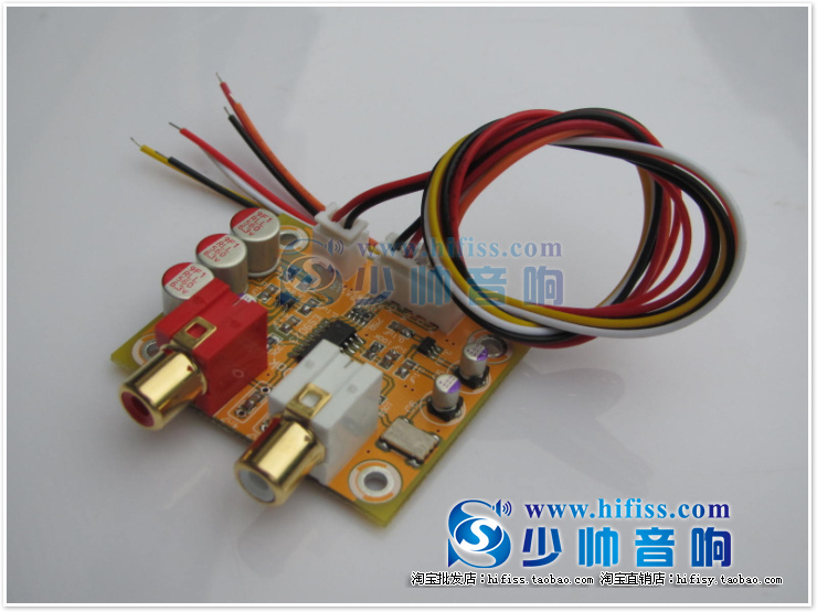

usb/Spdif
Seem very interesting for using as a DAC.
I am looking for using as usb/spdif converter to connect to my dcx2496, is it good for this?
Is there a spdif output on the board?
Other ideas for my connection are welcome.
Many thanks.

anybody had trouble installing the driver as i do right now? windows 7, the computer recognizes xmos 2.0 upon plug in, unable to use the driver, try to install it with the driver linked on the first page of this thread and the installer says the driver is not plugged in.
i just used xmos official driver and it's all good. the sound it's making right now very promising- a bit thin compared to differential 1543 but that's to be expected, i guess.
how do you toggle the de emphasis filter on this board?
please take a close look at the bottom side of pcb tracing the output. the output is buffered by tda chip! lol. i severed the connection and the sound is much more transparent at the expense of dynamics.
looks like de-emph is already selected. so then i cut the trace from pin 11 and connected that to where the ceramic cap is connected to pin 10 and viola... gorgeous sound. you must do this mod, haha.
i was mistaken. the output of the dac goes to the input of tda1308. still, the rca + is connected to the same trace....
above picture is for iir mod. cut the trace leading out of pin 11 first.

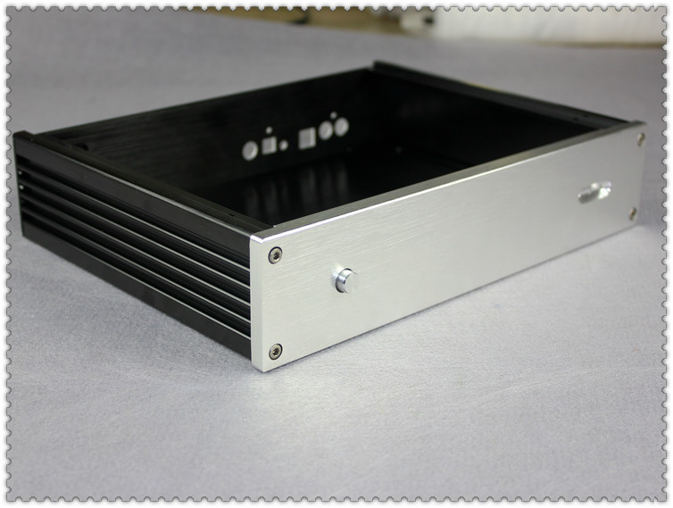

And an ebay aluminum box yet to be ordered based on what size all the boards come to when I connect it up.
I think that should do it and with the option of installing a 2.5" external drive in the box I can have my entire collection, DAC & power supply in one little box.
This box looks like a good option with IEC and power switch. You would need to modify the rear panel holes possible.
2806 2 Aluminum DAC Enclosure DAC Box Case Suitable DAC7 DAC9 ES9018DAC 1541 | eBay
Dear PreSapian,
Just cut the old trace of Pin11 and wire Pin 11 to the left side of C49, am I correct? No need to pull out any Capacitor or Resistor right? and What is the purpose of this mod?
