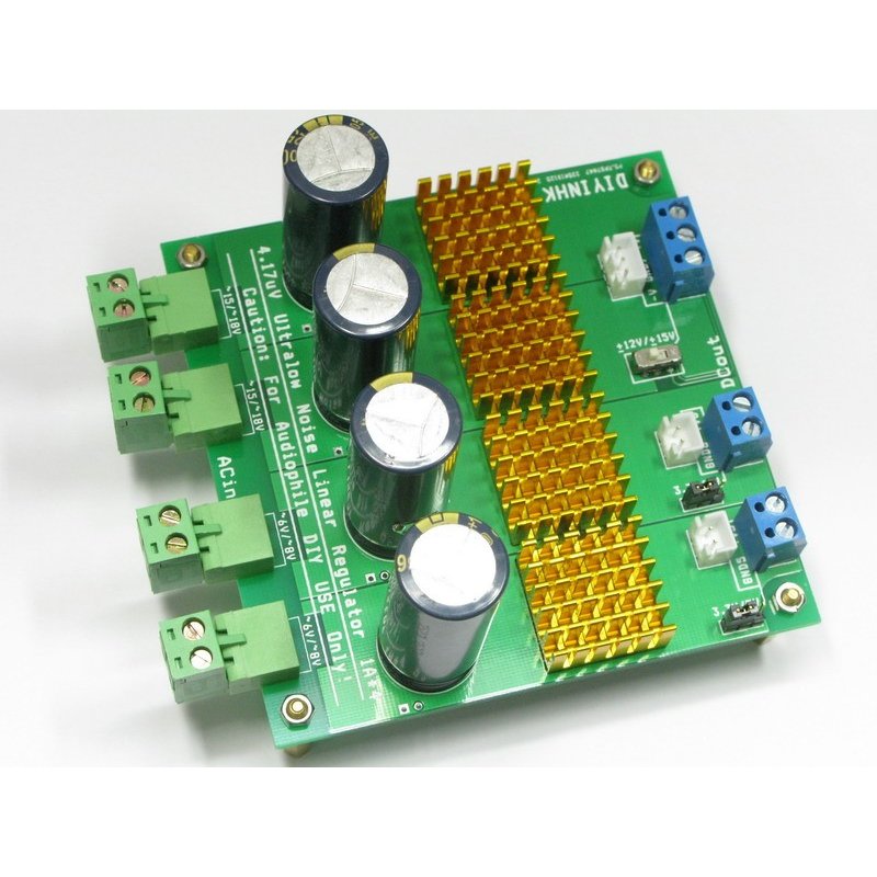

Sorry Andy, I could have worded that better! You are correct to point out that this is not a stand alone PSU and will need a rectifier before it.
I was just mulling over the fact that this would be a vast improvement in noise levels over the LM317. 4.67 uvolts noise instead of 0.15 mvolts. Further advantage is that it's LDO, dropping only 307mv at 1A so potentially less heat. Granted it is not cheap but I can see that other DAC builders have got big gains in SQ with lowering the PSU noise floor.

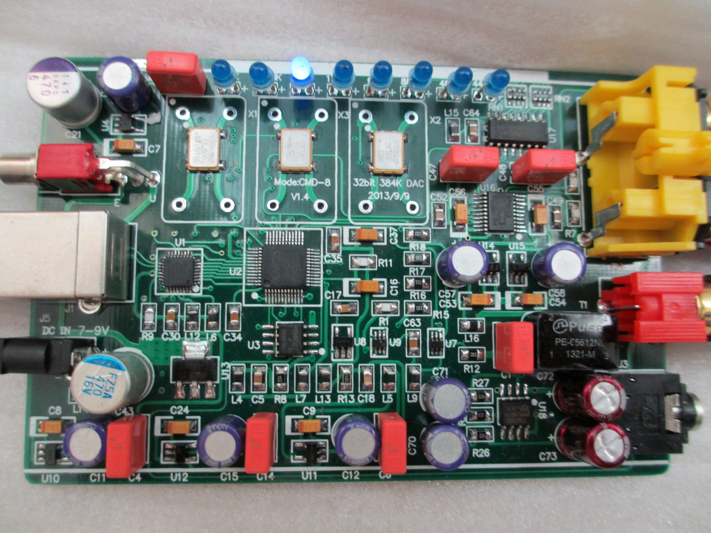

Here is a picture of the V1.4 board dated 9.9.2013.U13 is there plus some other differences.
V1.4 looks like it has everything back in place. Good!
Hi vavle5425. Yes your quite right the 317 is pretty noise for todays standards. The TPS7A4700 looks like an attractive option. Ebay has some setup on a 3 pin PCB for around $20US. Maybe this could be a secondary regulator after the 317 which can bring the voltage down so the TPS7A4700 only has a few volts to work with. I also have a bunch of older LT317AT regulators I used in a 1990's DAC upgrade for my much loved Marantz CD94 now long gone. Oh, just looked up the noise spec on the LT317AT and it is 50uV for 5v output so I think they will stay in the old parts bin. But I am rambling...
I wanted to buy a made up power supply so I can have a nice neat internal layout. Then I can have a perspex lid and see the sample rate LED's if I need to check occasionally.
From the Raspyfi website this looks like a good option for the power supply:
http://www.diyinhk.com/shop/home/13-17uv-ultralow-noise-dac-power-supply-regulator-33v55v-1ax4.html

What type is the U18 (next to the headphone out)?

I did some pixel peeping and figured it is probably TDA1308.What type is the U18 (next to the headphone out)?
