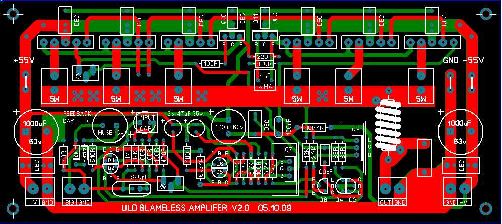

And we have a candidate!
The actual PCB will measure 3.125 inches tall by 7 inches wide.

That layout is rather nice Carl. What is the value of the output resistor in the wire coil? The green earth people will like this. Very little wasted copper on this pcb. Will the resistor pad holes except the FAT Dale RN resistor leads? Just a small problem I had in the past.
Tad
Tad,
The resistor that you refer to is specified to be 6.8 ohms at 1 watt. The schematic is posted back on post #167. The library part that I used in the layout is for a Vishay/Dale CW 3 watt part. The Mouser part number is 71-CW2B-7.5. The PCB thru holes are .047 inches (1.2mm) and are spaced 1 inch (25.4mm) apart. Similar parts equivalent to the one specified should work equally as well.

Carl_Huff said:
Terry,
Before any of us spend the money to spin PCBs for a build, I need someone to check the PCB layout against the schematic to be sure that I haven't made a mistake. Would you be up for the task? I plan to check it again myself.
There is a free viewer on the Sprint Layout website. Sprint Layout viewer
No problems, I have never tried this with a double sided card b4 but can't be that hard.
Terry
