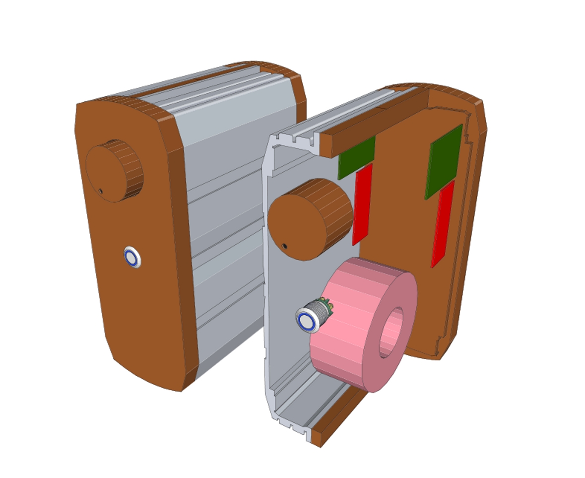

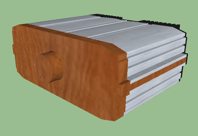

Hi there
That sounds fair enough to me and I'm sure I can handle the 10K pot to boot 😀
I've been doodling in sketchup and based on the possible transformer, regulator PCB's and the amp boards I've come up with a slightly different 'concept'.
The proposed enclosure now stands on it's end. Internally the traffo is at the bottom which will help stabilise the unit. Amp boards at the top and regulator boards just under these. The idea being to help keep the AC lines away from the audio IN/OUT. The pot will be fitted as near as possible to the PCB's so a shaft will be needed to connect it to the control knob at the front.
As a minor detail a bulgin anti vandal switch will be used to operate the unit. I'm currently (you see what I did there?) Reading up on traffo's and regulators as the required power will dictate what size traffo I end up with. So long as I can fit it in the proposed case with everything else all will be well.
Now in a lateral bit of thinking I am hoping I can just bolt the chips to the case, as per the original occupant, The walls are very thick and there is a lot of surface area to act as a heat sink.
In a slight sideways step in this convoluted path to home build amp ownership I am getting a PC cdrom audio adapter, after Christmas, to set up a CDROM player for the use of. I saw this idea mentioned on this forum and it sounds good to me!......... I hope it does when it's done!!
A slight fly in the ointment is rapideonline no longer stock the LM3867 🤐 So cricklewood will be my next stop off!

Its TDA1562Q that needs the 10k pot.
The popular National Semiconductor gainclone projects normally use a 20k pot in parallel with a 22k resistor for input load. Its still about 10k to 11k.
You might have a look at Rod Elliot site for the article "a better balance control" which is also an interesting proposition.
And there are also law fake arrangements using a Log pot for its slightly higher accuracy, paralleled with a resistor to cause something very much like audio taper. That makes a cheap pot perform just about like an expensive pot. 🙂
The vertical orientation will get better performance from the case as a heat dissipater.
This is not a common arrangement, but will work well and will take up less shelf space, since we are not allowed to stack power amps on top of each other.

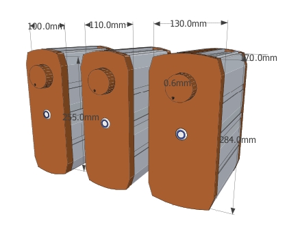

Hi there
@Daniel - Oh yes for the TDA it is. I've been browsing Rob Elliot's site, an excellent resource, for some time. Coincidently it was the Googling of fake law pots that got me there, months ago, on a different project. I was short of a 10K log pot for a project and learned how to make a linear pot work for the volume control; which it indeed does 😀
@Andrew - Cheers 🙂 With the layout as is it also gives me a lot of empty space that could be used for any additions to the set up. Selector, buffer, phono pre-amp, soft start, speaker delay. Up to a point I can thicken the wood strips to increase the width of the unit but I wouldn't want to overdo this.
Without the strip spacer the enclosure width is 100mm Ext/90mm Int. The next option adds 10mm and as a maximum option a total of 30mm added. anything beyond this and I think the unit will start to look too squat. I have the minimum of tools to work the aluminium and again for the wood. But I should get by.
The overall size is 284mm H. 170mm D and 100mm, 110mm or 130mm W.

Transformer size that offers good $ value for electrical performance is defined very easily as follows:
VA = one to two times the total maximum output power for a ClassAB amplifier.
eg.
two channels each of 60W will play well with a transformer from 120VA to 240VA.
The same amplifier will also play/operate with transformers outside this VA range.
Conditions are: playing all music styles in all domestic situations. PA and Sound Reinforcement and motor driving and all other exceptional duties need a much better model.
